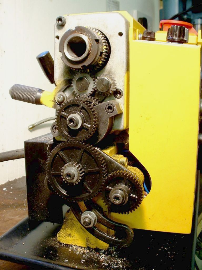

      I would have expected a tumbler reverse and an idler before the screwcutting train on most lathes. Is anything missing?
      #245994
        Nothing missing Neil mine has no tumbler reverse just a banjo down to the gearboxwink
        Fairly standard on all the 210, 250, 280, 290 type lathes.

          Might be useful to fit one then! It would solve the problem of adding an idler reversing the leadscrew.

            As Jason said, nothing missing. No reverse option on the 2109, although i have seen a website, Steve? who fitted an extra arm with a gear to add reverse. He modified the gearbox cover also.
            A longer Banjo is really needed.
            I tried the 66/20 gear setup for my 8 TPI giving me 3.3 instead of 3.175, close enough, but that only left space on the banjo for a 60T gear. that had to move down very slighty and only meshed by the tip of the teeth. I didnt have room for a spacer to secure the gear also. I ran it on its slowest speed but the rattle from the gear didnt sound nice.
            I think threading an 8mm hole with 8TPI is beyond me. How do you make a rigid bar to thread aluminium at that size? I tried a valve stem bent over but its too flexible.

              Yes i would second that quite alot of lathes have no such function for reverse, though it is a very common and quite simple adaptation to do so, one only needs to fit an intermediary gear between another banjo, and hey presto tumbler reverse. I haven't got one though, i use left hand taps/dies if the need arises, although it is something to think about no?

                  You could mill out the slot in the banjo a bit further, infact it would probably be OK with an open end. If you do make another then aluminium would be easier to cut but mild steel a bit cheaper. I would just go for a bit longer.
                  8tpi on an 8mm dia rod will only leave you about 2mm core diameter which will be very weak and just snap as you try to cut it, what is this part for?

                        Looking at the picture, it does appear they didn't mill the slot as long as it could be.

                            Yes it does look like it could go a fair bit longer. Just leave the same thickness's as the edges.

                                Tpi query solved, its the 8tpi square or ACME thread for teh seat adjuster so tool would be 1/16" wide and 1/16" deep giving a 5mm core. Though from picture it looks more like 10mm OD
                                Answer to how you cut the internal thread is to make yourself a tap from Silver steel.

                                  Is that an opto coupler to sense rotation I see on the top photo? Just add CNC then you can cease worrying about change gears!

                                    And yes, its for the lathes rev counter.  I had to change the voltage regulator and some caps because that stopped working.
