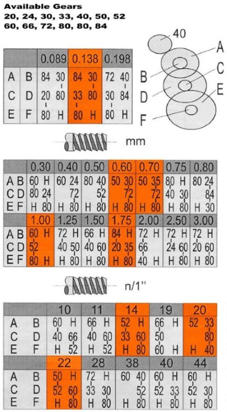

                                    Sorry guys, i got distracted with other projects but now need to rattle my brain on this one.
                                    I have a chart of what gears to use but its useless, the ones in orange will not physically fit onto the bar or in the space between the leadscrew gear and the top of the bar the gears attach to.
                                    There are probably more that do not work, but not had a chance to try them yet. I think the 1.75 comes out wrong also?
                                    What am I missing? Someone please knock some sense into me Thanks.

                                      If I understand your threading table problems correctly the orange coloured don't fit. The metric part with 0.7mm pitch; the 40T gear on the spindle is driving the 50T (A)gear which is keyed to a 35T (B) gear which is driving a 72T idler gear that is driving the 80T gear on leadscrew. Since the 72T gear is an idler gear you can use a larger gear or a smaller gear so the gear train will fit your banjo.
                                      You can find a change gear calculator here. I hope this can help you on your way.

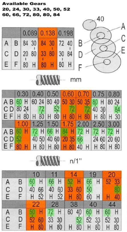

                                            Maybe this will help. I've highlighted all of the idlers in green.
                                            devilIf I've made a mistake I'm sure some one will mention it – I hope
                                            The way to think about idlers is to consider a train of 3 gears each one meshed with the next one. The gear at the top rotates say one tooth, the middle tooth rotates 1 tooth too and so does the one at the end. So the gear ratio is determined by the tooth count of the top and bottom gears. There can be any number of teeth on the one in the middle.
                                            The only other factor needed is the number of teeth on the spindle gear which is driving the train. I single gear meshed with that is an idler.

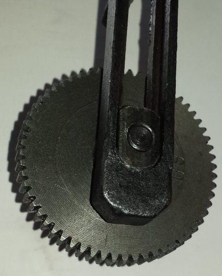

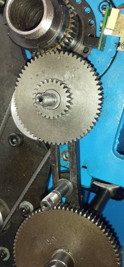

                                                This is the 60 tooth fitted in the uppermost position, i had to grind the nut to move it this high on the bar.
                                                Swinging the arm over, and it only just makes it, It will almost swing under the spindle gear but not quite.
                                                I tried the 1.75 thread and it came out way off. I cannot remember what it actually cut. I tried several calculators and they were off. But i did suss it out, it seems a failed hard drive and old age has crept up on me and i have forgotten what worked.

                                                  You could grind a bit of one end of the nut that takes the 60T to improve the mesh if needed.
                                                  Looking at the chart I posted earlier with the idlers marked they have been rather naughty. Making a longer arm might help but you would need to check the gear pcd's to see if they mesh. The usual arrangement for a banjo is 2 slots in a V so for simple trains like pitches of 1 and 2mm a large gear would be placed up against the gear on the lead screw and then the whole banjo swung to engage the large gear with the spindle gear as well. The other slot being used for compound trains.
                                                  I wonder if looking at 0.6mm pitch if they have simply forgotten that the 50 wont mesh. In that case a longer arm might solve the problem – assuming that the rest do mesh. You would need to calculate the pcd's and check.
                                                  Frankly if I bought a lathe like that I would take it back.
