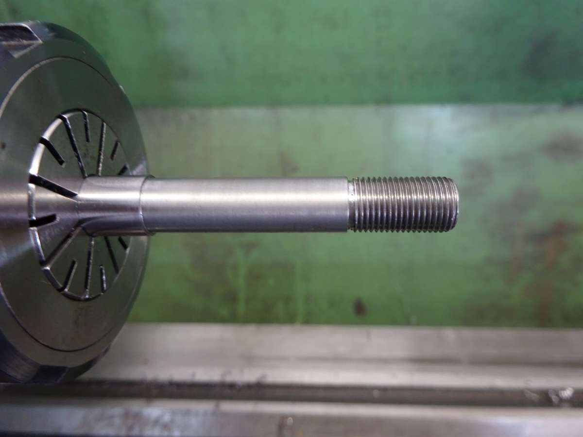

                  Can you change to M4 fine which will need less effort to cut. Although Silevr Steel can be a bit of a problem I get on OK with fine threads and the diameter is not reduced, this is M8 x 0.75 cut at about 100rpm with CT90
                  DSC02126
