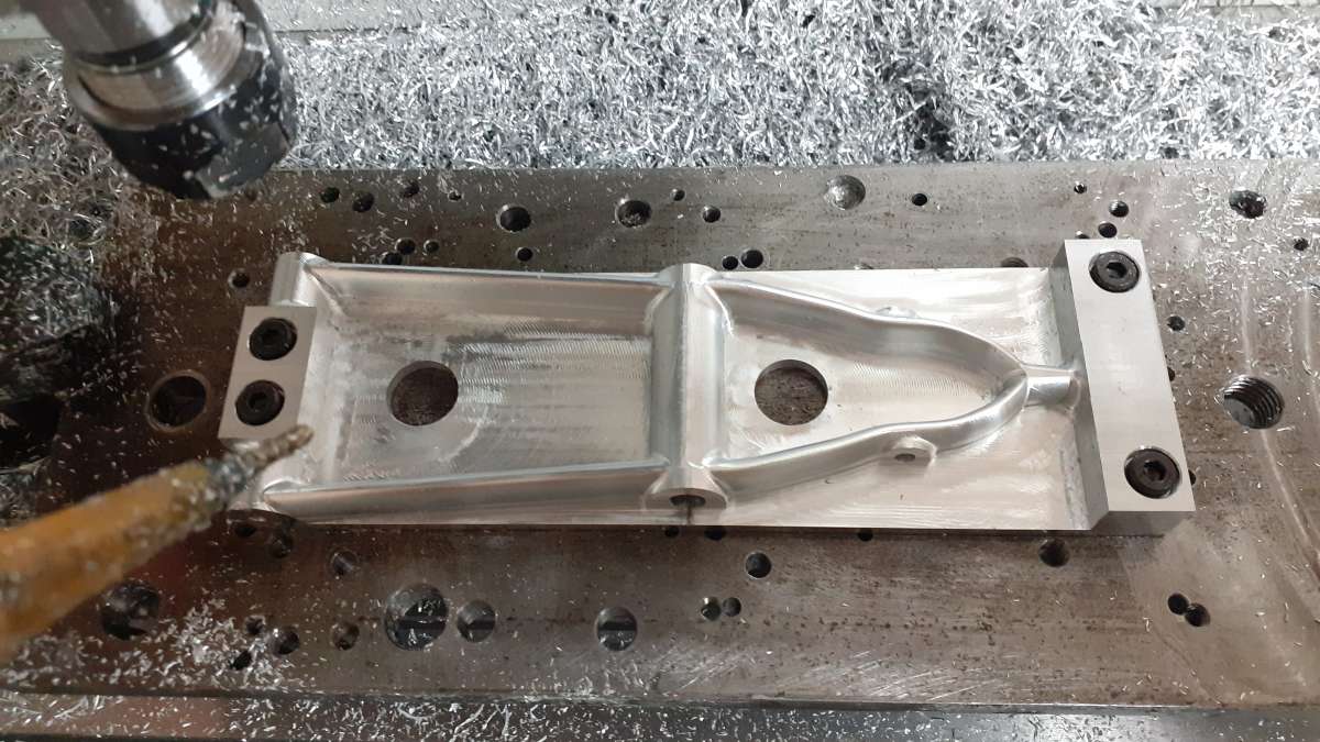

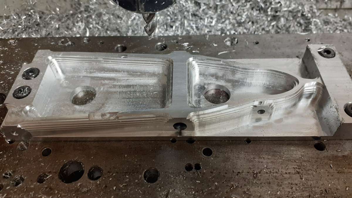

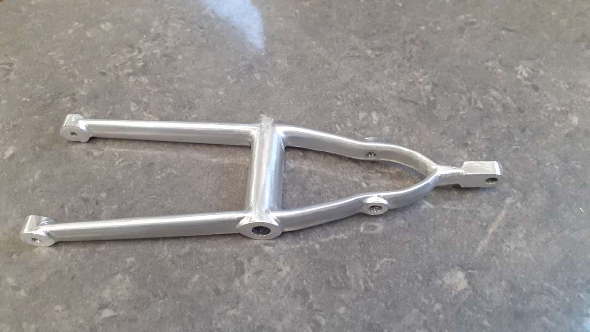

        I managed to find this within a piece of 2″ x 1/2″ flat bar, just need to work out what to do with the remaining 86% that turned into swarf.
        20240107_145629
        #705643
        Mark Rand
          @markrand96270
          Was it filing with buttons or some other esoteric technique?
          Expiring minds want to know 🙂
          #705682

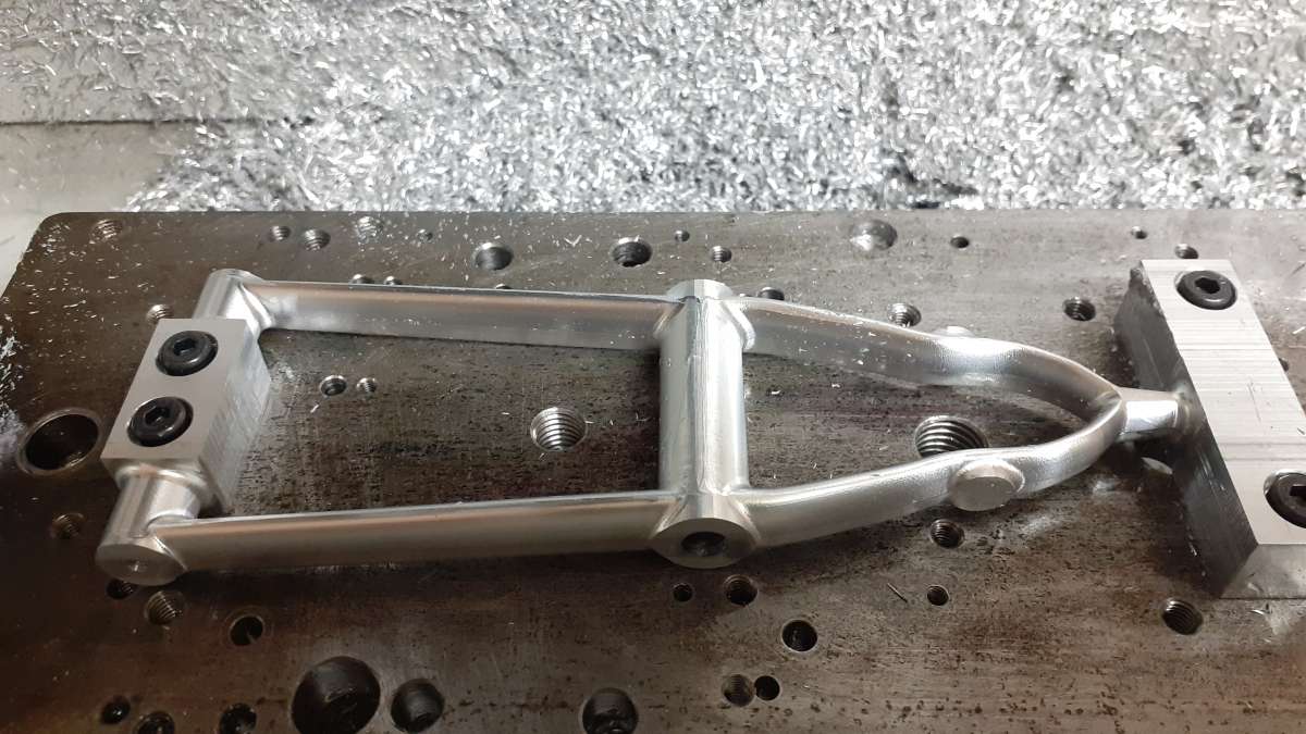

            Right hand end was rounded with Rotary table, I seldom use buttons for this unless the hole is too small to adequately hold the part.
            As for the rest, initial holes drilled, tapped & reamed in the manual mill, bit of CNC for the more organic shapes, back in the manual mill to remove stock used to hold it on the CNC and also the right hand hole. Final bit of needle file work and a “shoeshine” with strips of emery.
            First Adaptive to rough out one side on the CNC
            20240106_105256
            2Nd Adaptive with smaller 4mm cutter and finishing “scallop” passes at 0.2mm stepover with a 4mm ball nose to complete one side
            20240106_134129
            Similar on the flip side
            20240106_153855
            Last bits on the manual, milling almost right through
            20240107_093629

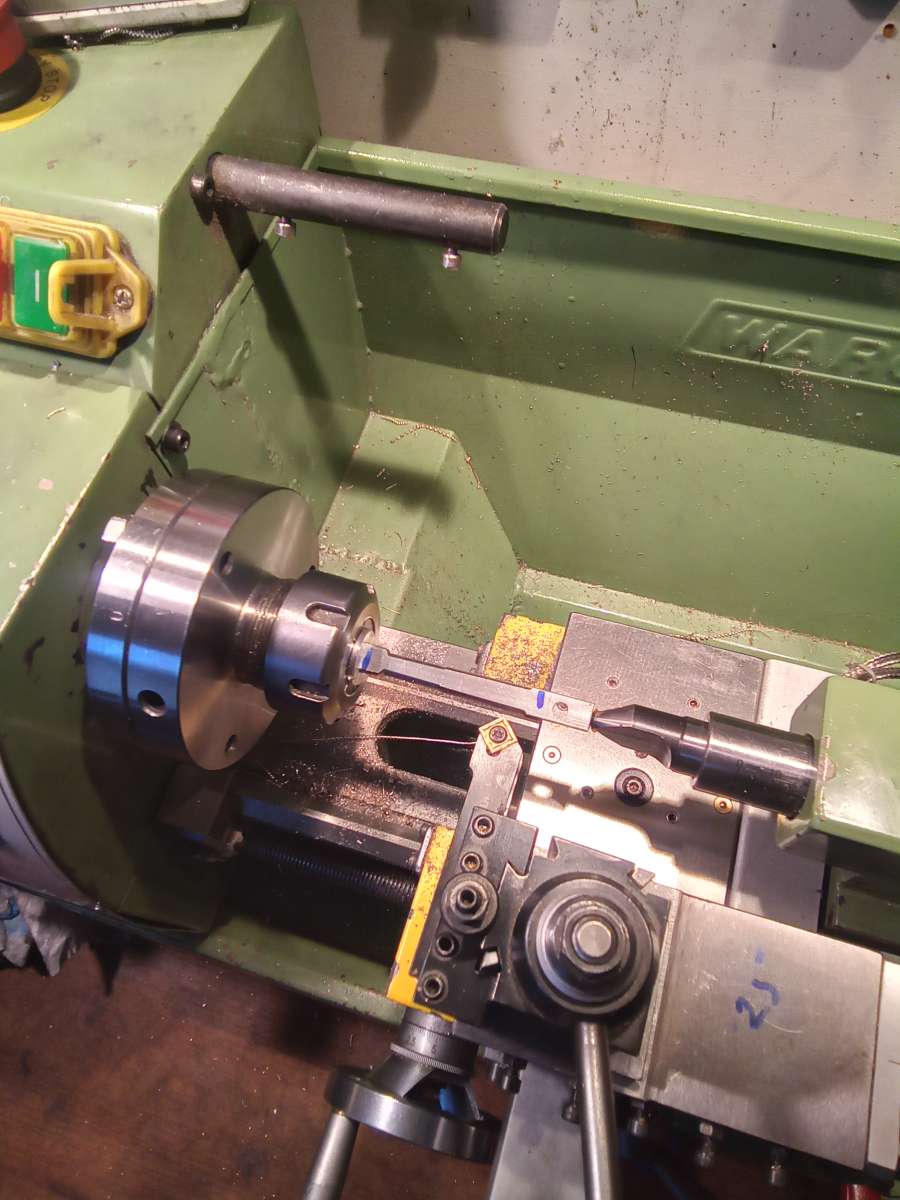

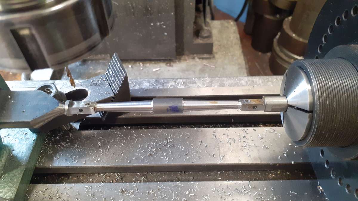

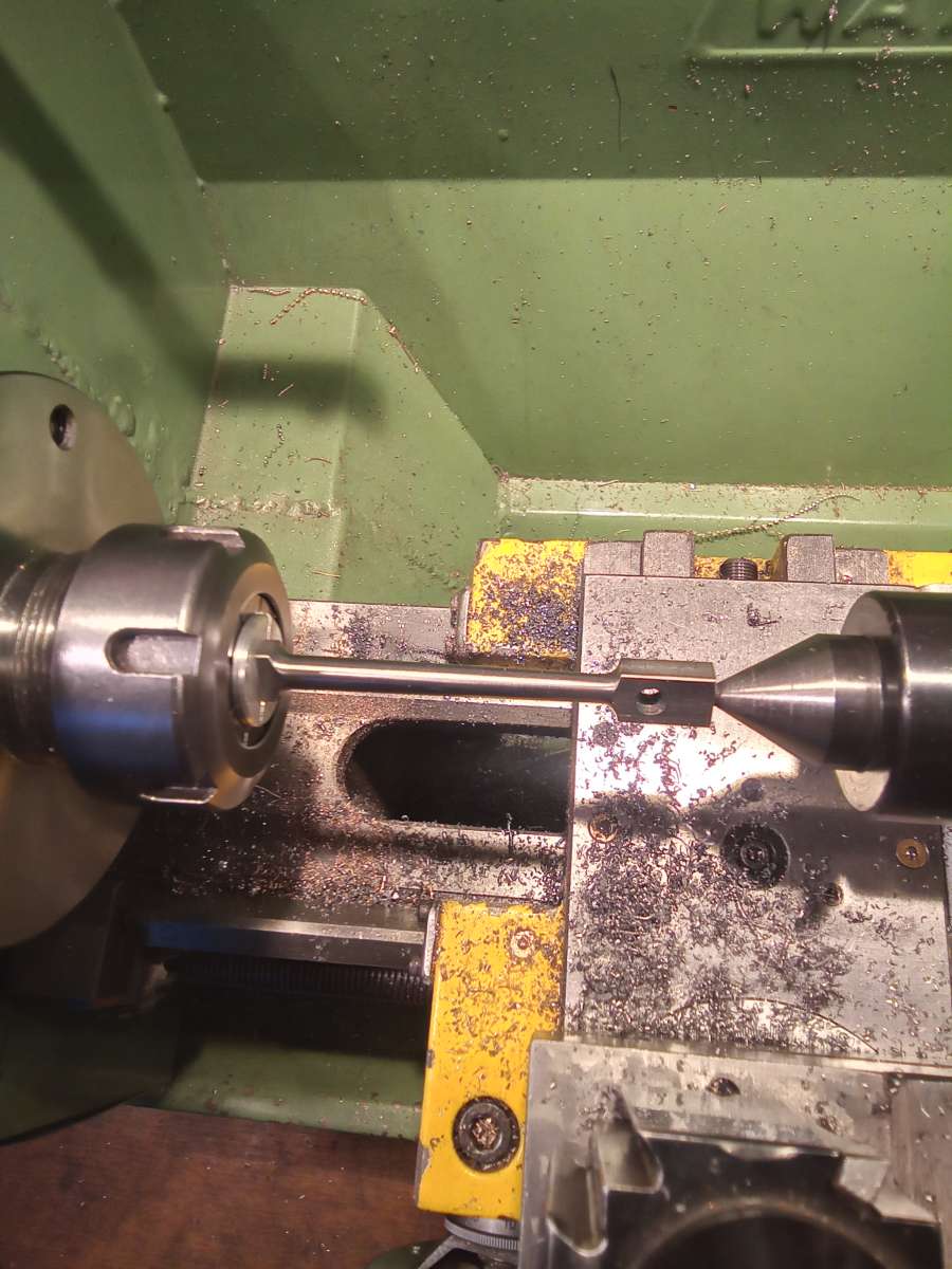

                Today’s “achievement” came close to scrapping several hours’ work when I started tapering the con-rod for my Minnie in the wrong direction:
                20240108_115529
                I blame being distracted by Woman’s Hour. I realised just in time and was able to salvage it:
                20240108_143928
                (The taper is now as it should be, even though it doesn’t look it in the photo)

                    Jason, what is that part? ..if it’s not secret..
                    #705849
                      Thanks All I’ll keep um coming.

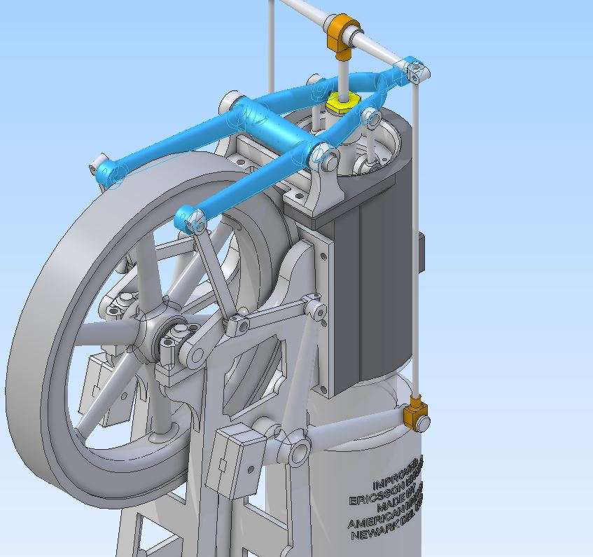

                      The part is the top beam for the 1/5th scale Denny Improved Ericsson hot air engine I’m building.
                      beam 2
                      Quick lash up to see how it looks, ignore the rear links as the crank arm is not fixed on that side. Mark may like to know that the ends of the brass links were rounded with filing buttons as the holes are only 1.6mm dia so did not think a M1.6 screw upto the side milling loads.

                        ..that’s a lot of joints and pivots to keep snug-but-slick.. ..rather you than me – look forward to seeing more, it looks an interesting one..

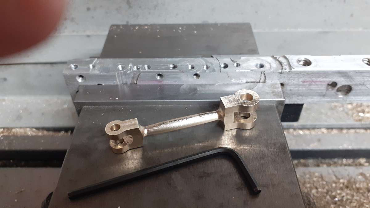

                          A few more links and a yoke made.
                          20240116_144758
                          20240120_142220

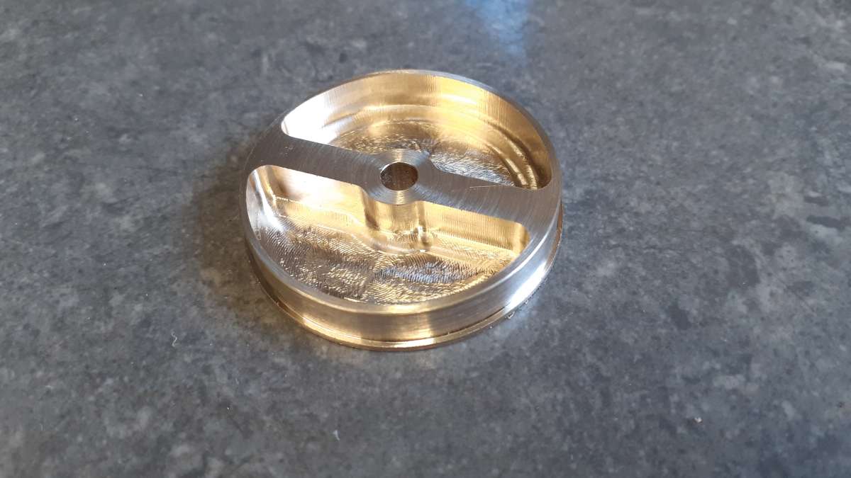

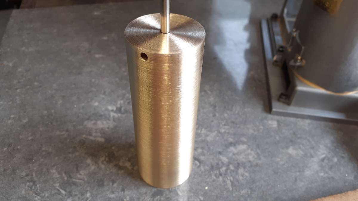

                          With a bit of time to spare today I thought I would do the top plate of the Denny’s displacer piston, this is a piece of 35mm dia thin wall brass tube with plates silver soldered onto each end. Th etop plate needs to have a couple of M3 tapped holes for grubscrews so it can be clamped to the piston rod so two webs were left which will be drilled and tapped after soldering.
                          displacer
                          20240126_141258
                          I did not worry too much how the bottoms of the recesses looked as they will be inside the piston and never seen. If they were visible I would have left 0.2mm or so on the bottom of the adaptive cuts and then finished with a pocket path that leaves a more visually appealing pattern. Cutting details in the description when watched on Youtube.

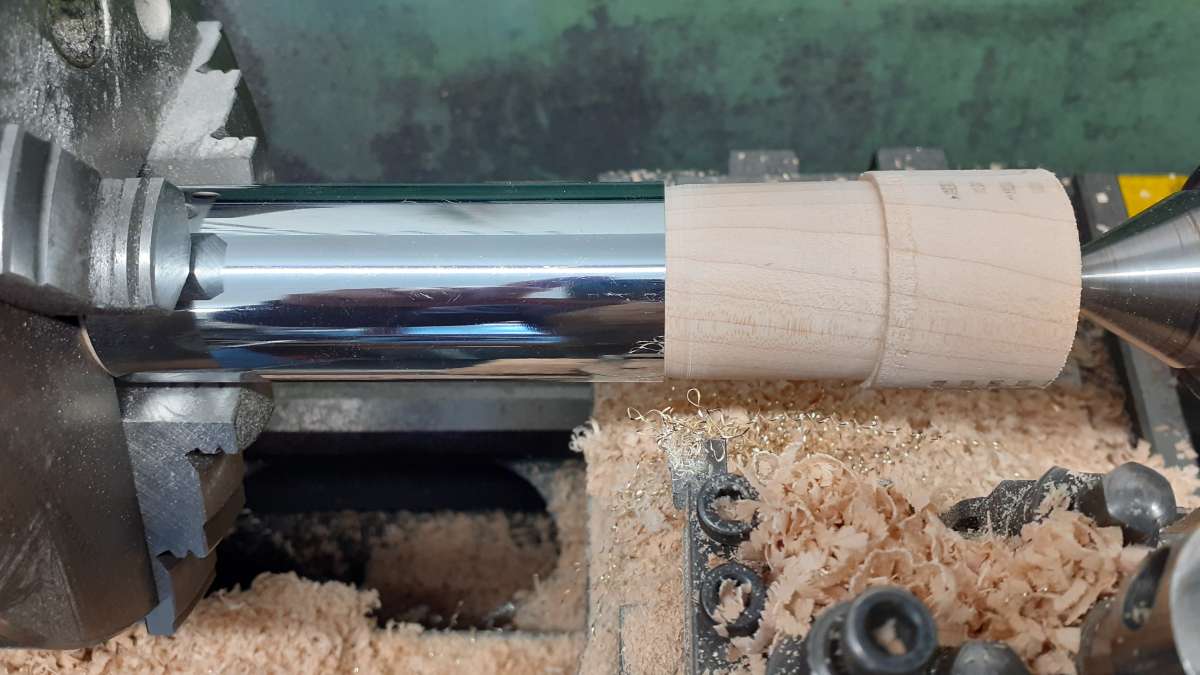

                            I turned a bit of maple to a firm fit inside the thin wall brass so I could hold it without crushing while turning the ends true.
                            20240127_085601
                            Then soldered up the parts before finally drilling and tapping the grub screw holes

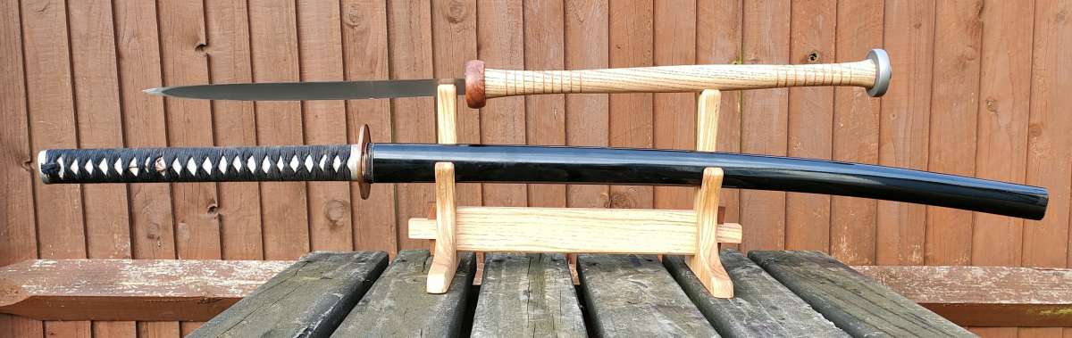

                              I’ve been doing some woodwork – A stand for my pointy stick:
                              IMG_20240128_095332

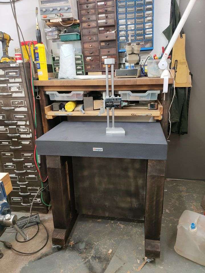

                                And further progress with the workshop is an upgrade to the metrology department.419334229_10232195685779413_31746790551885927_n

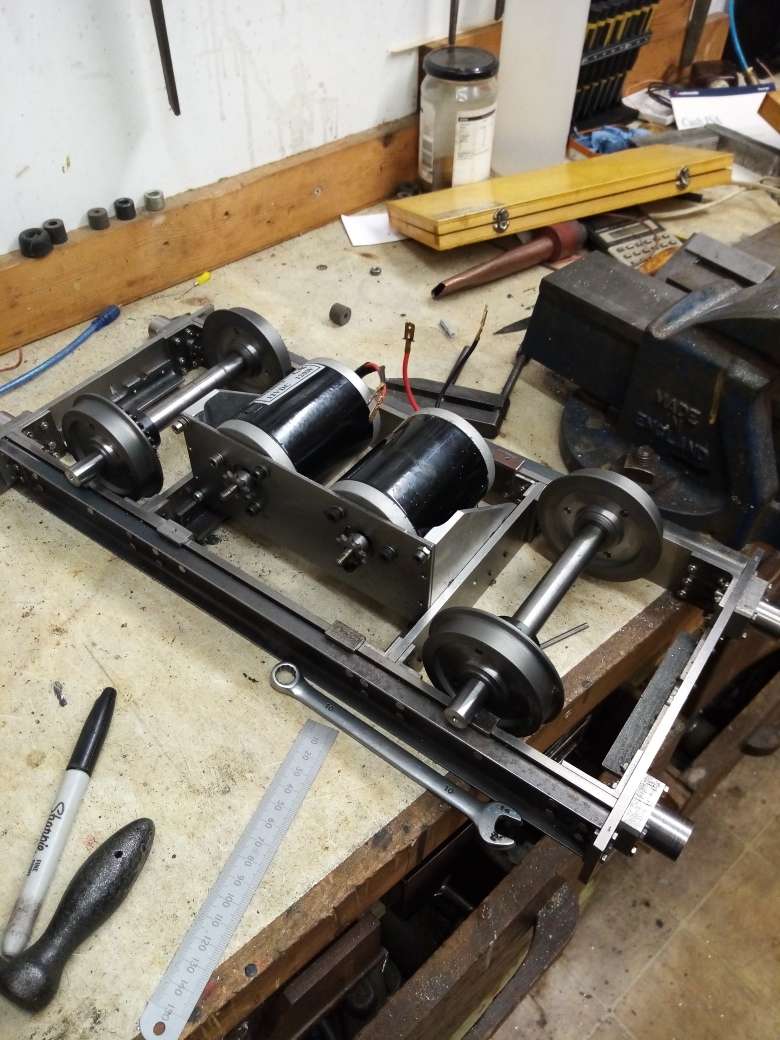

                                  Just to prove I do something practical now and again, progress on my Battery loco (an LNER Y3 lookalike). Just need to spot through and drill for the bolts to connect the 3 cornered ally bits to the stretchers. Coordinate drilling with the DRO is magic. It just went together, no unplanned slotting of holes. Next is axleboxes and suspension
                                  IMG_20240128_183703_resized_20240128_063854914IMG_20240128_183802_resized_20240128_063854409

                                    FAo Jack Hobson,
                                    Really like the rope work on the handle of the sword – how do you do it ?  bind the cord and then stitch the bundles in the centre ?
                                    I’m making an axe for the local G&S Society – Mikado and would like to do similar if possible.
                                    Also I need to make a Snicker Snee – a sort of shorter sword with a flat ended blade I think – it will not be sharp though !
                                    Richard B.
                                    PM me if you like.
                                    #710625
                                    jaCK Hobson
                                      @jackhobson50760
                                      FYI mine is really badly done, but an authentic attempt.
                                      Plenty of things on Youtube If you look for Tsukamaki.
                                      All you need and more in: The Art of Tsukamaki: Pocket Edition ISBN-10 1505226147.
                                      I used ‘silk’. I’m not sure it is (but it was priced as silk). It is not nice. Use cotton or leather. In theory you need lots of paper wedges to stop it unwrapping but I suspect leather might not need it. Or superglue it.
                                      Paracord wrapped handles are nice.

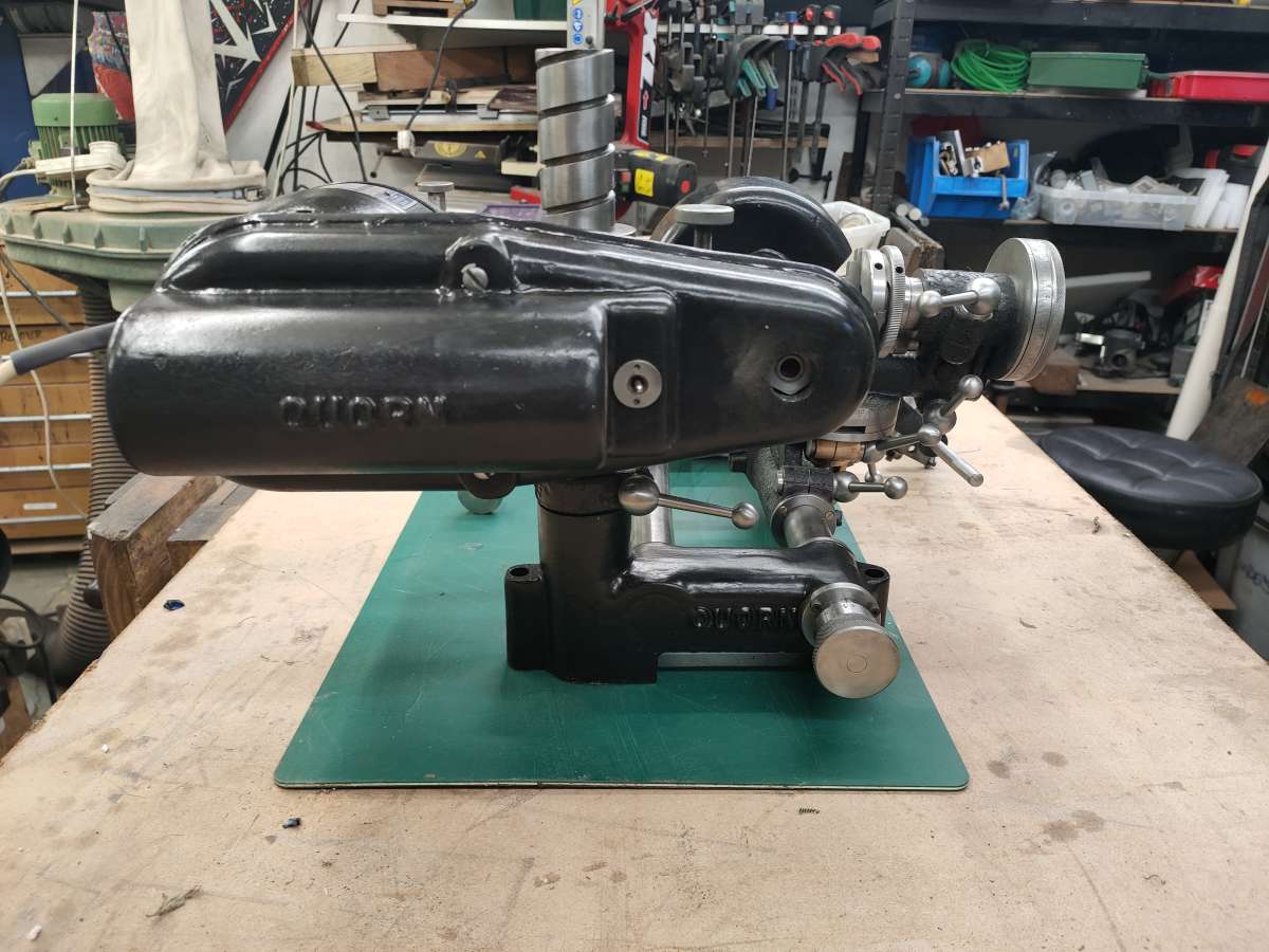

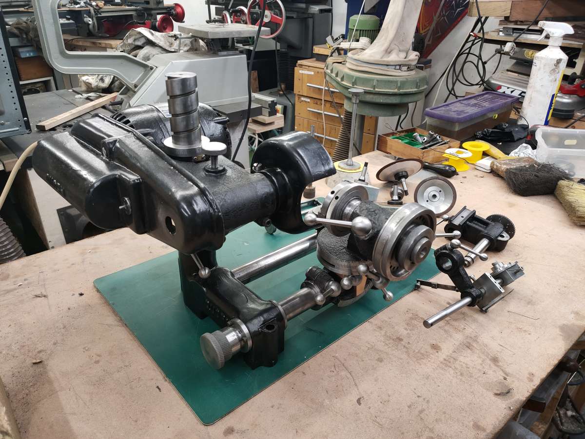

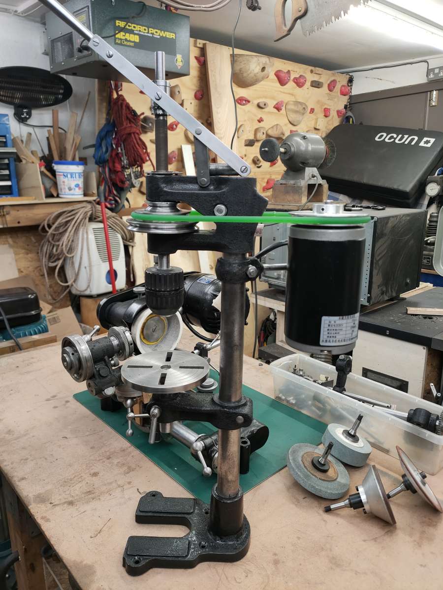

                                            Cleaned up a Quorn. Might be useful. A few bits to make so a nice mini project (not like making the whole thing!!).
                                            IMG20240414181406IMG20240414181349
                                            Also a nice little pillar drill. A bit too much runout I think to be truly great. But it looks nice. Variable speed DC motor.
