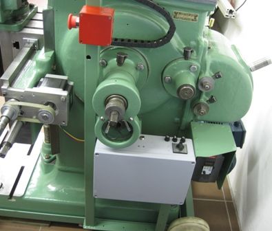

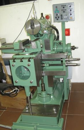

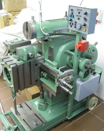

      My ALBA 2S NC fitment is almost done. Still some wiring, and then the broken vertical slide dovetails still to fix – that is in progress as well – awaiting a large (65mm diameter!) dovetail cutter from Germany. Decided not to try the rout of making a cutter anymore..
      Steppers are being fitted to the X and Z axes, with a STM processor based NUCLEO (Arduino style) controller to drive it all. Can set up X and Z autofeed in increments of 0.005mm, and can set up the start and end feed as well. Has a DRO for X and Z, and jog control of the RAM ( via 3phase VFD) to position the RAM easily for stroke adjustment. Also has bull gear sensors for RAM full forward and rearward position, so as to know when to do autofeed.
      Autofeed is set to occur when the RAM reaches 5mm from the rear position of the return stroke – feeding 2mm on X axis takes 500milliseconds. Setting the start of cut to be 15mm from the RAM rear position allows for a feed of 10mm before the tool reaches the workpiece, at the max cut speeds on the ALBA. A large stepper (14NM) is used for X drive..So, no feed while retracting the tool across the workpiece, no numbing the cutting edge, no scoring the workpiece..
      The machine can be set to cut from a start to a specific endpoint ( set on the DRO), the retract the RAM to the rear, and stop.
      It cannot connect to a PC with MACH2,3 or whatever – NC only, not CNC..
      A lot of fun, this stuff!

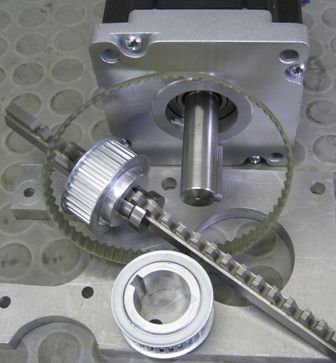

      Broaching keyways in the stepper pulleys:

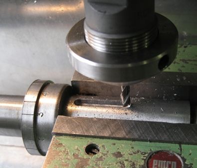

      And keyways in the leadscrews.

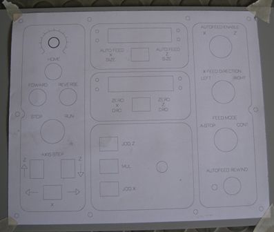

      CAD layout for control panel

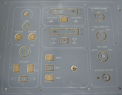

      Engraving and Routing Control panel fascia
      Controls fitted to panel.

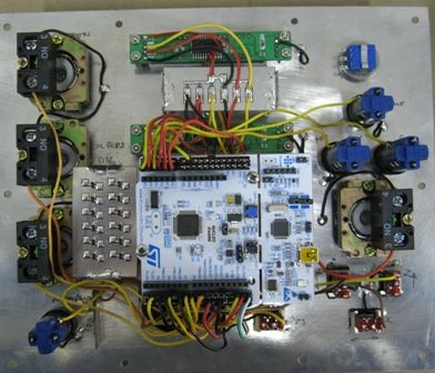

      Rear wiring of panel

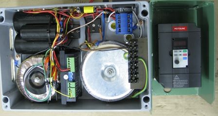

      Stepper Power supply and VFD.

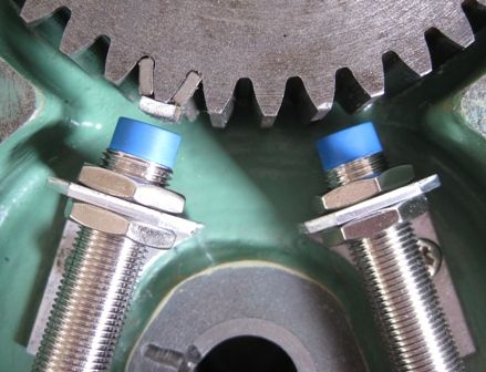

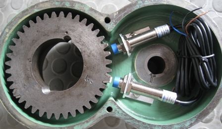

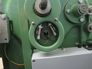

      RAM position sensors
      14NM Stepper on X axis

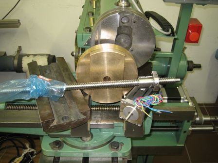

      New Bronze dovetails started…
      Ballscrew for Z, with 4NM stepper
      That's dragging and old shaper into the 21st century!
      Next will hopefully be a post on it cutting..

          I see the quadrature pickups (proximity sensors?) on the ram gear. Are the additional bits added to create an index marker?

                Hi Murray,
                Those are inductive proximity sensors – they are spaced 180deg apart on RAM movement, ie, one detects when the RAM is fully extended, the other when ( nearly) fully retracted. I was not sure if the X axis autofeed would be quick enough to do when the RAM reaches the rear position, so hedged bets with the forward sensor which would allow feed to occur during RAM retract..So, an index sensor of sorts – front and back.
