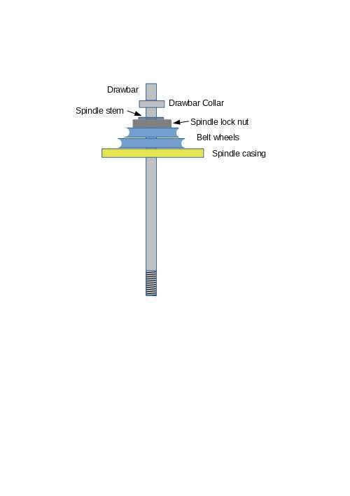

      Thanks John – and yes it seems to be a neat solution – if I could only work out how it actually works. Despite the text explanation, I can't understand what the drawbar is pushing against – and without knowing this I cannot make a bespoke version to fit my particular milling machine drawbar – whereas I unsderstand fully my swing bridge design. Perhaps a cross section of mikesworkshop version would help to explain the principle. In the meantime, I will try and draw a cross-section of mike's and see if that helps me.
      Colinj

        The one on Mikes site has a flange on the drawbar the pushes against the underside of that "cap" as the bottom of the cap is fixed to the spindle the drawdar pushes downwards when undone so releasing the taper. The advantage of this over your sis that as hhe drawbar is undone and starts to bear against your flat par it will push the quill down so you will only get it to release when the quill is locked, not really an issue but just one more thing to do each time.
        If you imagine the underside of mikes "cap" is the underside of your swinging bar then they work in the same way.

          My approach was a 'collar' on that drawbar that tightens against the top of the spindle to lock and when wound up presses underneath a semi-permanent cap on the top of the spindle to unlock. The cap has a hole for the end of the drawbar and the arrangement makes the drawbar captive.

          Colin LLoyd
            @colinlloyd53450
            Posted by JasonB on 27/12/2017 16:32:30:
            Thanks Jason for the explanation – it helped. But I don't think this will work on my particular Amadeal XJ16-300 mill which doesn't have the necessary spindle protuberance above the spindle locking nut to allow mike's cap to work. As you can see from the diagram below – the spindle locking nut is virtually a flush fit on the spindlewith no opportunity to drill the cross spindle holes. So I think my only choice is to go with some form of over-the-top bridge setup.
            Colin

            #334121
              Colin, is the top of your drawbar hexagonal for a spanner or does it have a hex recess for a key? If hex for a spanner how long is the hex section?
              Edited By JasonB on 27/12/2017 17:31:11

                Colin, you can do what I did and thin the locknut down by a few threads.

                  Colin LLoyd
                    @colinlloyd53450
                    Posted by JasonB on 27/12/2017 17:29:46:
                    Hi Jason, my drawbar top has a square section for spanner (10mm each side) and 12mm deep.
