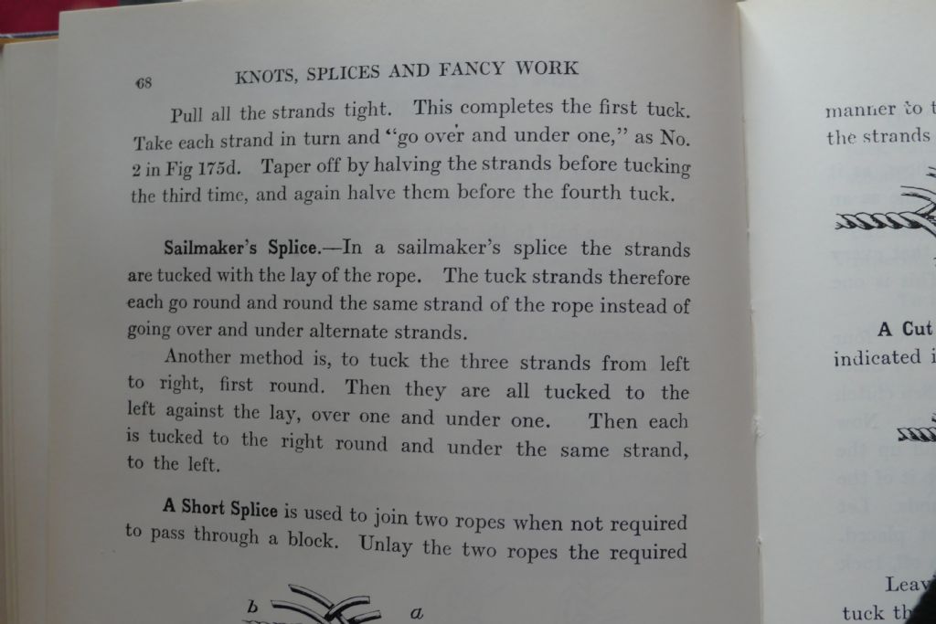

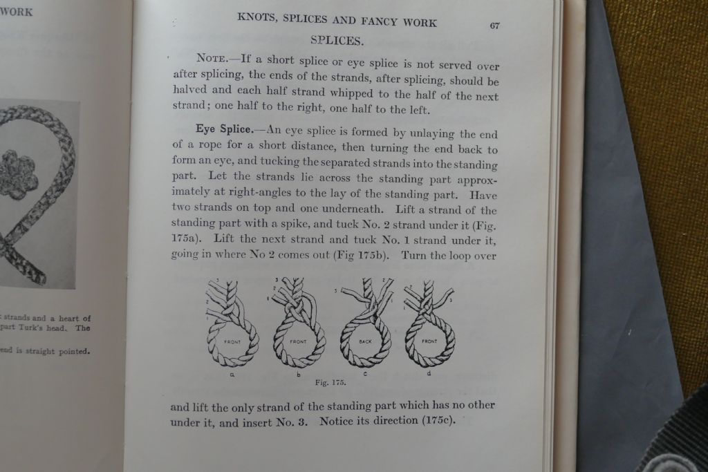

              From the book Knots, Splices and Fancy Work by C. L. Spencer

                  Martin –
                  I'll keep an eye out for that book!
