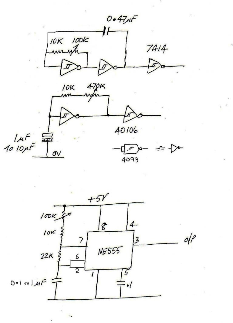

      I’ve acquired a suitable stepper motor off Ebay and this was apparently salvaged from a Sato R400 label rewinder. Interestingly, the seller (nice gent) included what seems to be the related driver daughterboard plus all the off-board wiring and switches that go with it. I’ve tested the stepper motor (Nanotech-Munich) using a primitive driver I have and this runs very sweetly. I’ve also done a crude test of the Sato driver-motor combination — powering it locks the stepper rock solid (which is encouraging). The only data interface to the driver board is a 2-wire flylead terminated by what appears to be a metal-encased 5-pin DIN socket. Presumably, the two connected wires are DIR and STEP. I suppose I could get a break-out-board for the PC printer port (and suitable software) but I’m reluctant to invest money only to find out that the driver is duff or a special that can only be driven by the parent board.
      I therefore need to find some way to feed suitable signals to the data interface. As I understand it, the STEP signal is simply a stream of square-waves at TTL levels fed to the driver main IC which amplifies these signals to (motor) power levels and feeds them in a sequence to the stepper so as to produce rotary motion.
      I have an old Labgear audio signal generator that can output sqare waves at TTL levels so I was wondering whether a signal fed from this could be used for the purpose. Is this feasible please? If so, at what conservative frequency should I run the generator to produce rotary motion? And what should I do (if anthing) about the DIR (direction) signal?

          Hi Joe ,
          If your signal generator has TTL level output from 5 Hz to 500 Hz
          I see no reason why you can’t use it to  test your stepper driver
          as plan B you could build a simple oscillator with a NE555 ic or TTL /CMOS schmitt  buffer ic
          If you need more info , I’ll post a few circuits

            If all you want to do is test the interface, you should be able to simply strap the DIR input to either 5V (perhaps through a pull-up resistor) or ground and then manually tap a 5V wire to the STEP input and see if it steps (again you should probably use a pull-up rather than the raw 5V).
            Flipping the DIR level should reverse the direction of course.

              After heaving the signal generator out of the attic I realised my instinct was right — I had been wrong-headed! While quite good of its type, it is, of course, an analogue AC signal generator whereas what I’d need, I believe, is a DC pulse generator.
              Initially, I’ll give Sid’s simple technique a go to see whether I can get some life out of the driver/motor. But I’ll also have a go at making a simple generator if it’s something I can quickly put together on a breadboard. So, John, if you’ve got a simple circuit to hand, I’d appreciate a copy please (I’ve got loads of 555s).

                You probably can use your audio oscillator, you just need a simple interface. Any small npn transistor emitter to ground. Audio osc to base, collector to STEP input – might need a pull up – say 1K ohm from STEP to +5V. Set the oscillator for 100Hz, 1V or so output. It probably has a source impedance that will limit the base current to a safe value. If you are worried then stick a 1Kohm in series with the base.  The pulse shape will probably be quite quick enough for a stepper driver without squaring up.

                  Hi Joe ,
                  any of the circuits should work
                  if you don’t have any inverters in your spares box any not gate gate
                  can be used  7400 4011 0r 4093 etc
