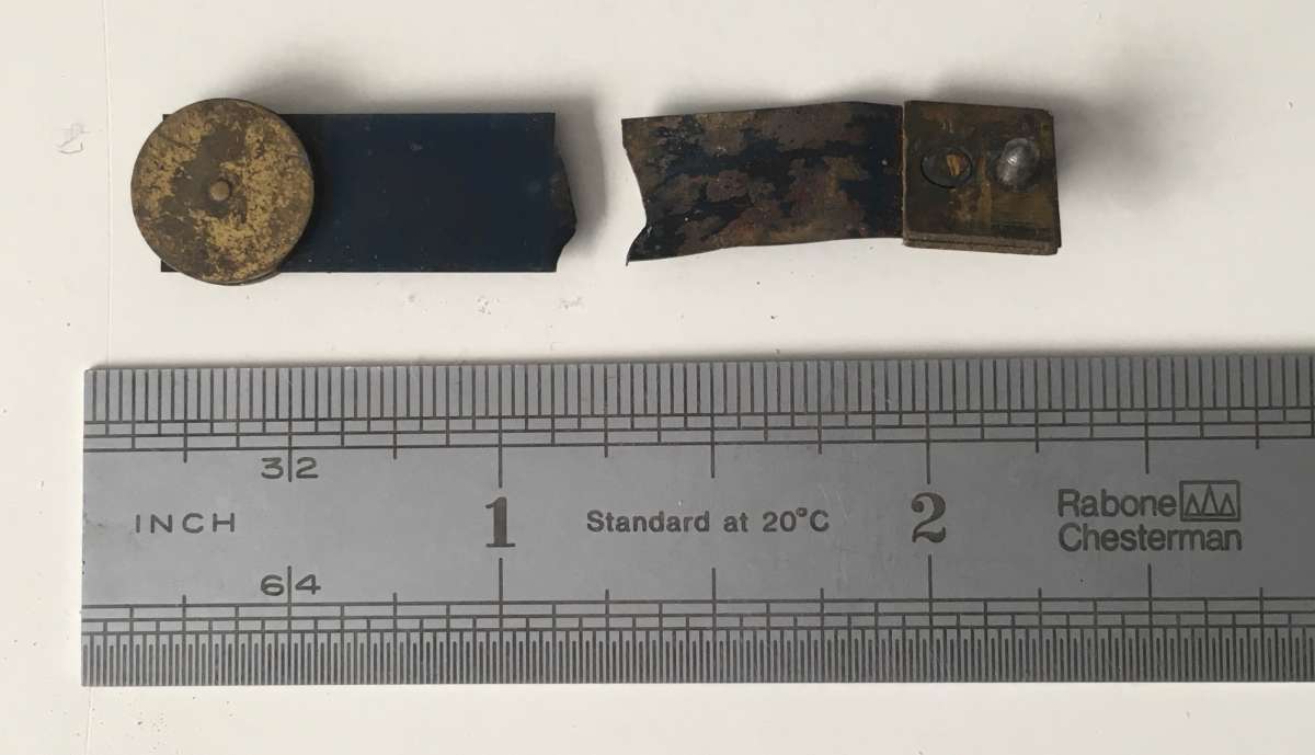

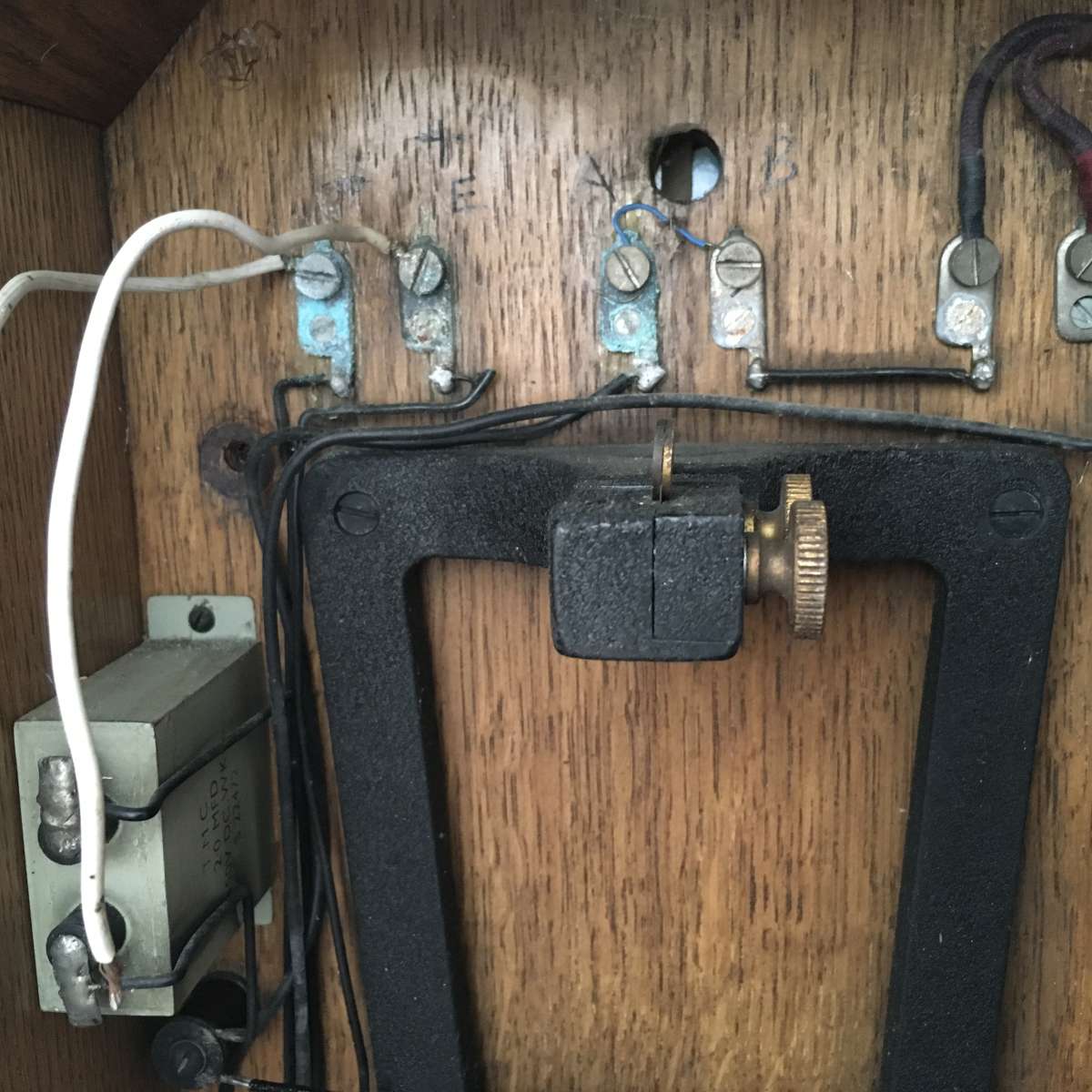

      I wonder if anyone could advise regarding a couple of parts ?
      I have acquired a TR clock like this one:
      https://youtu.be/atKvGzQCLYA?feature=shared

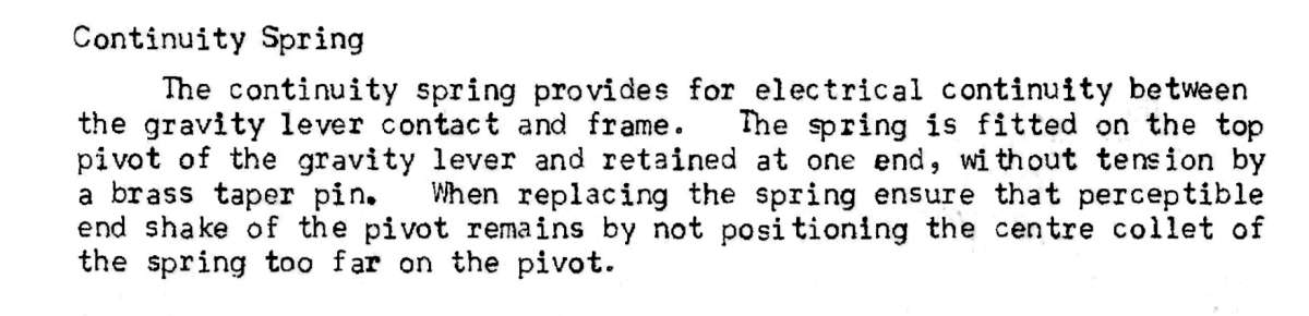

      and I have EHG Technical Paper 43 … Unfortunately there is no detail in that paper about either the ‘continuity spring’ or the pendulum suspension.
      My suspension is completely missing except for one small sliver of the spring material
      and my continuity spring looks like a rats’ nest !
      If anyone has one of these clocks, I would be most grateful for a sketch or photo of the pendulum attachment … which this ‘economy’ hook hangs upon !
      IMG_9710

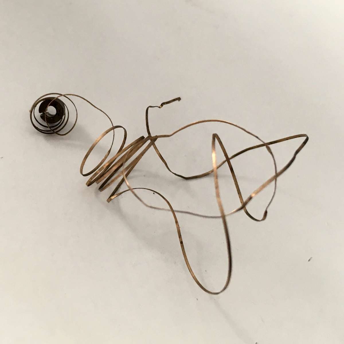

      … and any ideas about sourcing a suitable replacement for that ‘continuity spring’ ???
      IMG_9633

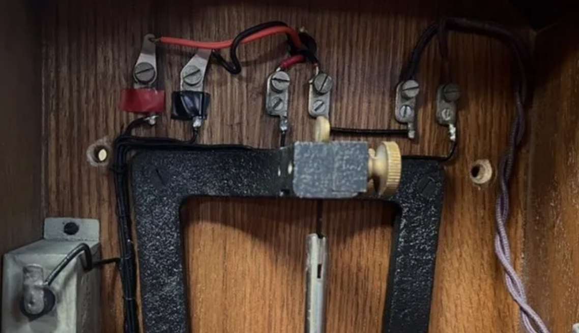

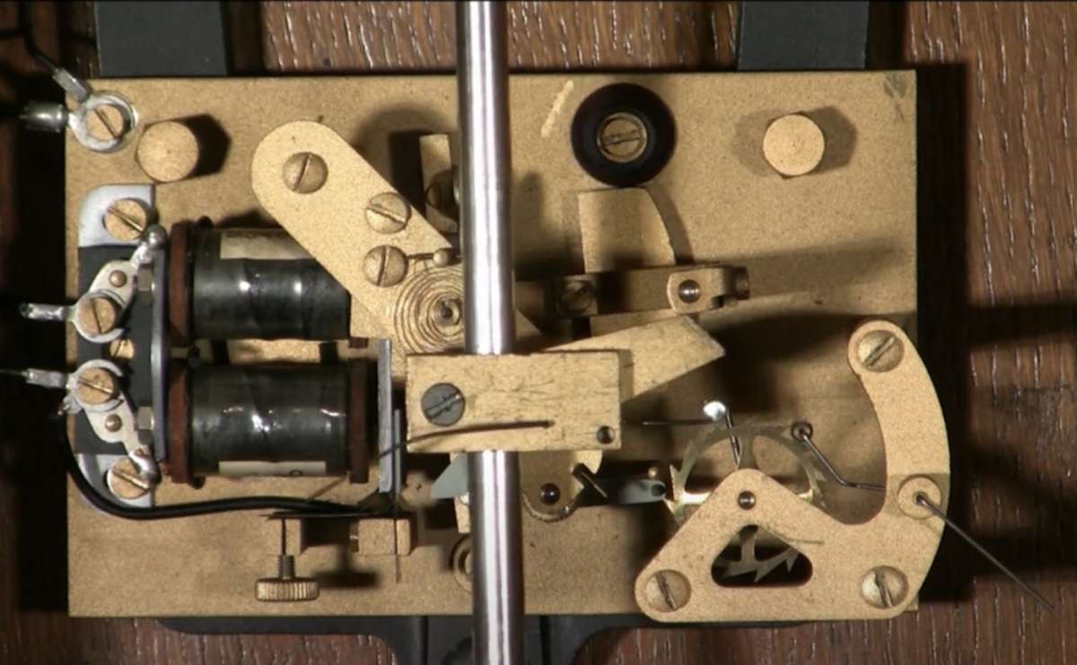

        Grabbed from the video:
        IMG_9635

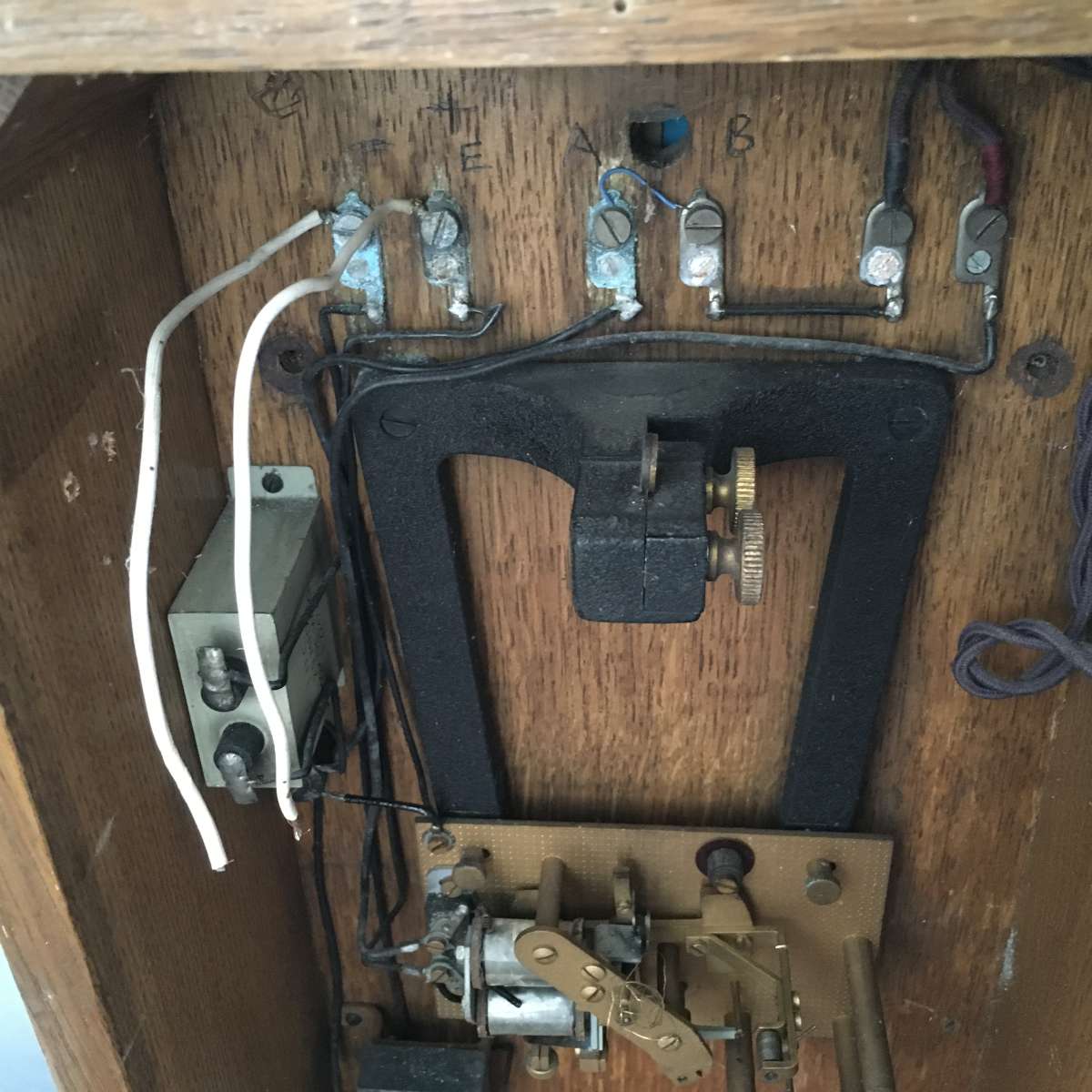

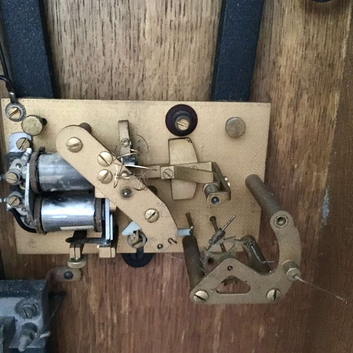

        and here is mine !
        IMG_9672

            Hi Michael,
            Your mangled spring may be made from Beryllium Copper like old 3000 type relay contacts. These could be stroked  back into shape when mangled with a pair of polished smooth grip pliers. Your spring would need a very light touch and squash any hard bends out first. If you hold the spring at a slight angle in the pliers and slide them along the spring it should coil it’s self up again after several goes. Just like curling Xmas present coloured tape.

              Michael, I have a quantity of 0.5mm BeCu shim, happy to supply some for the suspension.  Basically I think there will be brass cheeks soldered on each side at each end with a soldered transverse pin to fit the hooks.  You could also cut the material into thin straps for the other spring depending on the length you need.  I have several metres of 2 inch wide material, sent free as a sample!  More than I could ever use in my lifetime.

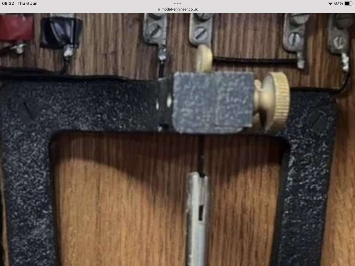

                OK when I looked, Michael’s photo of the top of the pendulum rod wasn’t showing.
                This is a screengrab from one of the photos of the clock in eBay, which illustrates the suspension nicely.
                image_2024-06-05_180939143
                The suspension springs on my own Gents clock(s) are a pair, rather than single, look to be blackened spring steel, and are 5/16″ x 10 thou thick.
                Bill

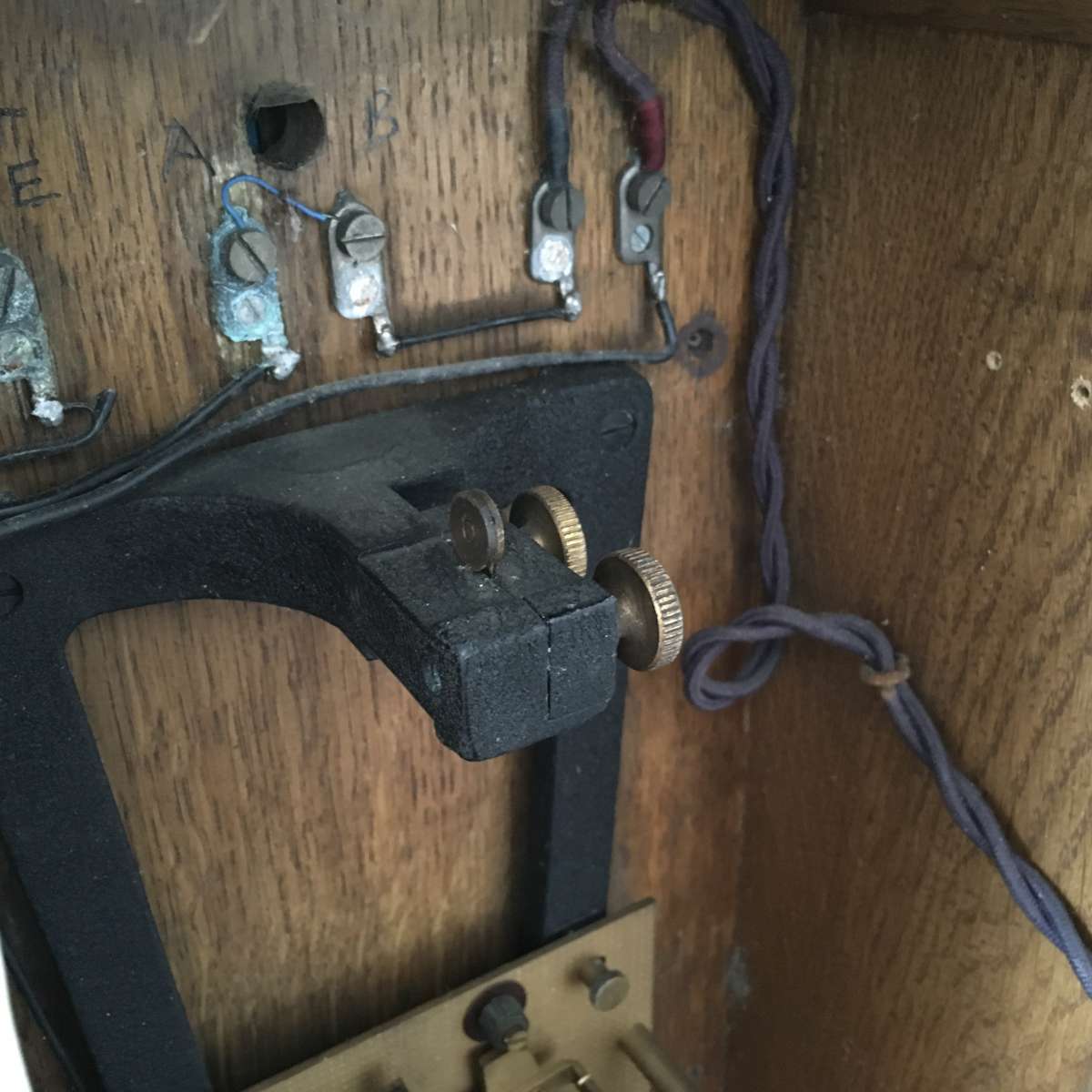

                        #734433
                          Until this morning, that was the best image available [many thanks, Bill]
                          … but the perspective is rather strange, making the alignment of the spring look unreal.
                          This is just a further crop from Bill’s capture:
                          IMG_9342
                          Hopefully these three images of mine give a better impression of the geometry:
                          IMG_9714
                          IMG_9715
                          IMG_9716
                          More revelations to follow shortly !!

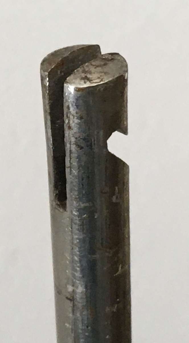

                          #734436
                            To my utter astonishment … having removed the clamp, and the remaining top portion of the suspension spring … I then looked in the bottom of the case, and found the lower portion jammed behind one of the triangular wooden fillets that supposedly reinforce the corners.
                            Mystery solved, it will be a relatively simple matter to make a replacement.
                            IMG_9718

                                            #734612
                                              Another small step … I have measured the section of that blued steel suspension spring.
                                              To my mind it looks too thick, but I would welcome opinions
                                              Width = 9.57mm
                                              Thickness = O.13mm
                                              Pendulum weighs 4.5kg
                                              P.S. __ Can’t be sure, but I think the breakage is attributable to mishandling rather than fatigue.
                                              #734660
                                              John Haine
                                                @johnhaine32865
                                                3/8″ x 0.005 in the units probably used by the manufacturer.  It does seem a bit thick, though also quite narrow.  I think the Synchronome spring is 5/8″ wide and 4 thou, for about the same bob weight.

                                                  #735630
                                                    Today’s good news … Not only did the taper-pin come-out without breaking the end off the spring but the little collet was equally co-operative.
                                                    In the immortal words of Captain Oates, however:
                                                    I may be some time
                                                    IMG_9738
                                                    #735653
                                                    Clive Steer
                                                      @clivesteer55943
                                                      Hi Michael
                                                      Your “continuity spring” looks very much like those used in speedometer. I have quite a few but I know some who has even more. If you can publish what size the collet is and the approximate spring diameter I’ll see if I can find a suitable replacement.
                                                      Clive
