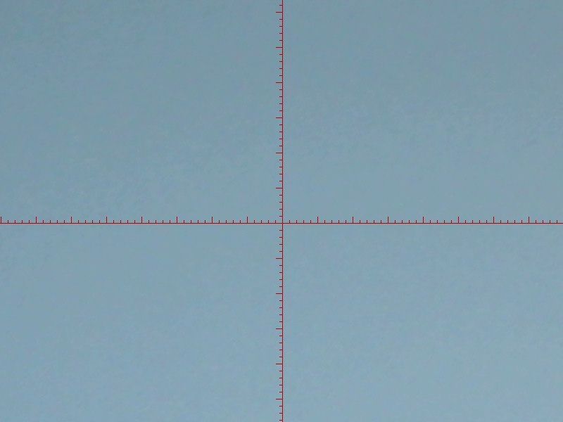

                          I recently bought a Bresser USB Digital Microscope from LIDL which claims to be "full 1080p". The mini CD in the box installed a VGA (640×480) viewer with no graticule. Annoyed, I went to the Bresser webside link given in the booklet, and downloaded Hiview V1.4 (ref 9652200).
                          This proved to be much better, displays a 1600×1200 image with (optional) fine cross axes graticule that can be calibrated to any scale factor by adjusting a multiplier. There are some other tools including text annotation, and the ability to save images.
                          The microscope appears to be a common Chinese item, available with various sensor resolutions. I have yet to make a stable stand that can exploit the performance – the included base is fairly useless. The magnification adjustment also changes the object distance, so something reasonably elaborate is needed for maximum flexibility. It may have potential for fine work such as watch making.

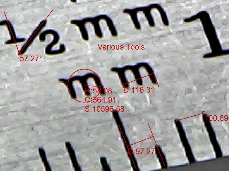

                                                    Just for the record, here are images of the central area cropped from the HiView v1.4 software, showing the cross axes (scale factor can be calibrated) and other measuring tools. grat.jpg
                                                    #629282
                                                      Looks entirely adequate for the job, Malcolm yes
                                                      Iain would just need to calibrate his zoom magnifications.
                                                      Ref. __ http://www.hvscam.com/soft.asp?lang=en
                                                      Edited By Michael Gilligan on 14/01/2023 14:43:55
