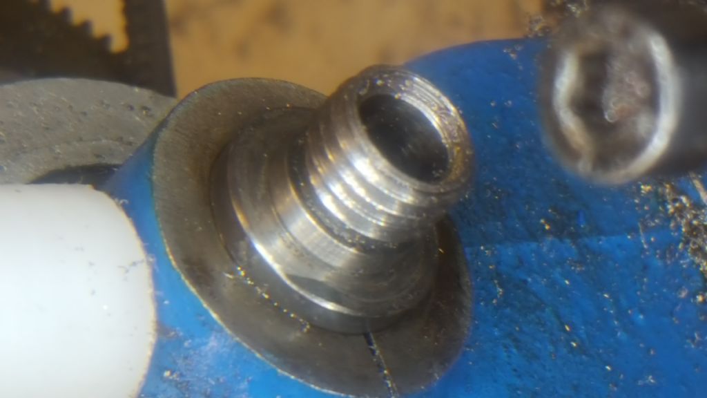

      Thank you for the replies. I had a more careful look tonight and confirmed that the spindle seems to be running true except for the dark spot at the bottom in the picture below, which stands proud by 2 thou. I shall have a go at flattening it today, using the ideas suggested or, perhaps, a hard rubber point in the Dremel.

        Don't turn up the face. The best option is probably a slip stone but a fine diamond lap or a bit of emery cloth and finger or stick should do as it does't matter if the damaged area finishes up a little lower than the rest. Or Hopper's suggestion. With the stone, lap or file it's possible to feel that it's flat onto the work. If it sticks up for instance it will rock a little. The Dremel wont be so controllable.
        Test the result lightly with a finger. It's possible to feel micron step changes that way.
        smiley Just one more thing noticing a comment. Male threads in female threads that have tapered flanks tend to centralise themselves as they tighten so have that off centre and it can interfere with a back plate running true. Same problem if the thread is out of square.
