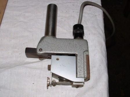

                          Engaged brain. The coil gets a constant 5v and the variable voltage is to the javelin. I only have one size No14. Are they still available from NH?
                          The javelin is a copper rod about 1/16 dia x 5/8 with a tungsten spike in the working end. Top end is widened out to enable number to be engraved on. Spikes available in variable widths. Held into hoolder with coplicated shape of spring. All makable of course as long as you have one as a pattern.
                          Glad I got this out as it has become a bit rusty on the side next to the wooden box.
                          There is no earth return connection on the old transformer so I think the path was assumed to go through the machine earth and mains earth.

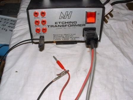

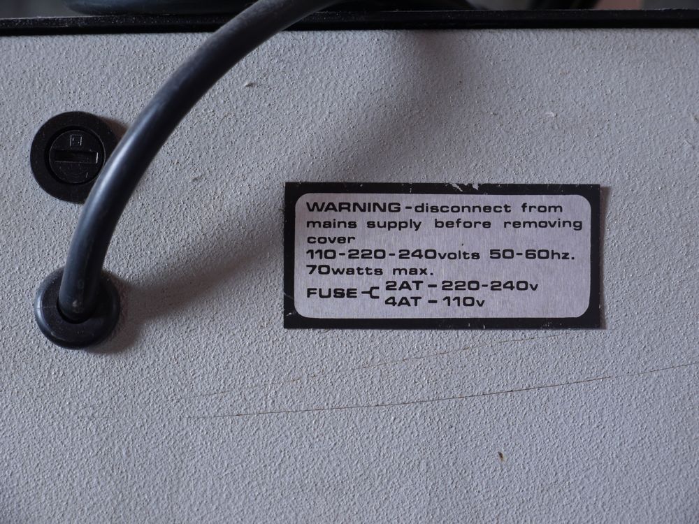

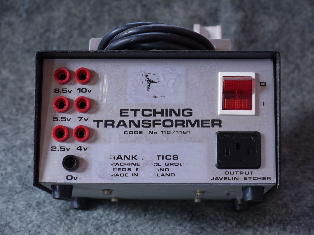

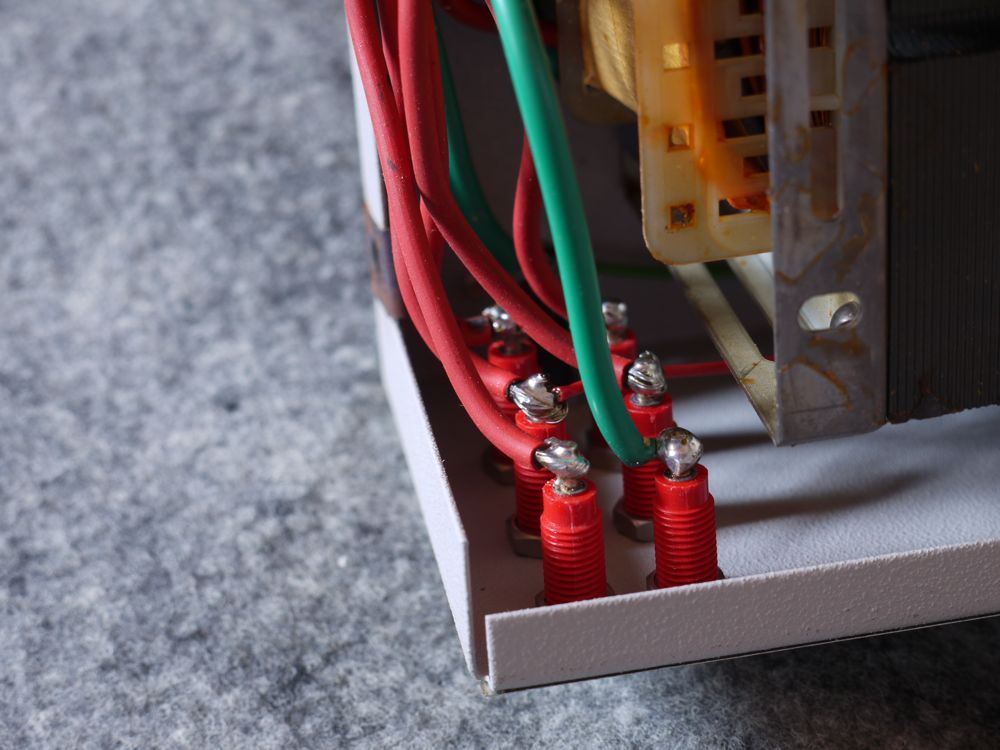

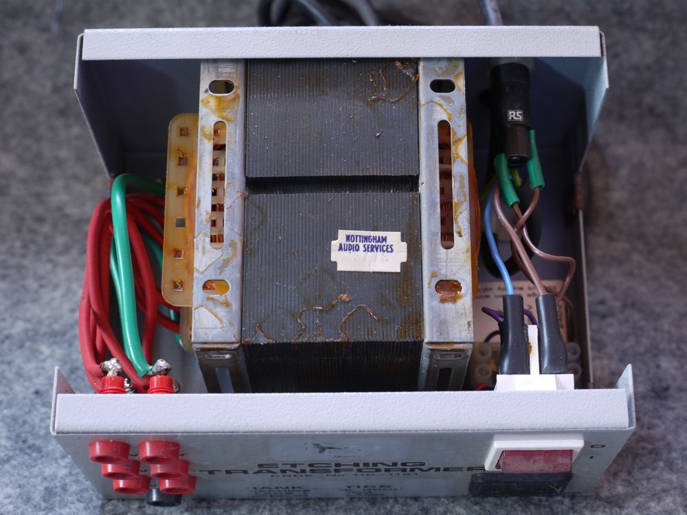

                            For info. … Here is the 1946 [Canadian] Patent
                            [other versions may be available]
                            #149256
                            Ian P
                              @ianp
                              I have had this in my 'odd bits of material' box for quite a few years. It looks to be Nickel Silver about 0.4mm thick and about 6" long. I have no idea what its used for but at least I know what its used with!
                              Ian P
                              #149287
                                As promised …
                                Here are photos of mine, which is branded "Rank Optics"
                                [ One of the later owners of "Taylor Hobson" ]
                                It has Serial No. RWS0002 on an adhesive label
                                but I don't know if that's the Manufacturer's or the Owner's.
                                Note that the thin red wire takes 5.5 Volts to the 3-pin outlet.

                                  One of those would be a good boot-sale find. That transformer would make the basis of a decent high-amp bench supply, especially driving something like a 12V milling attachment..

                                              Very stylish Transformer, Bazyle,
                                              I've never seen hat one before … thanks for the pics
                                              I was tickled to see the numbers, etc. cast in the top plate
                                              … somewhat inappropriate for the Engraving Machine manufacturer.

                                                    The 3 pins are to allow one voltage and return for the coil and one different voltage for the spark. A fourth pin could be for a flying lead earth return to attach to the job.
                                                    #149997
                                                    Bazyle
                                                      @bazyle
                                                      Received Ian's special tool today (many thanks) and matched it to various parts of the etcher. It seems the scalloped bit is to set the distance from the magnet to the back of the javelin holder. Well that's the only thing that seemed to match. the thickness corresponds to the magnet armature gap.
                                                      I now realise I have two types of holder – one has a spring to hold the javelin and will be self levelling and the other has a hole and locking screw so might be either for a diamond if that would hold up under the action or for something like a gramophone needle.
