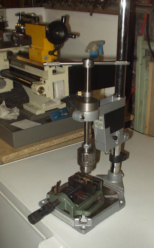

                        You can make a similar contraption from a modified portable drill stand.
                        Martin.
                        #75425
                        wheeltapper
                          @wheeltapper
                          Like this.
                          cheers
                          Roy

                                    wheeltapper
                                      @wheeltapper
                                      Haha, the tapping jig is standing on the freezer,its more than my lifes worth to mess that up.
                                      you don’t want to see the bench, come to think of it, its quite a time since I saw the bench.
                                      Roy.
