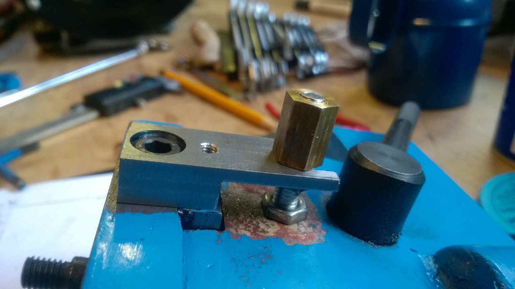

          Iain Downs
            @iaindowns78295
            I've ordered a volkel 6M HSS set from amazon.
            It turns out I don't have any 6mm bar, but I do have a lot of 6mm threaded rod.
            I shall use that for my first attempt. If the thread cutting fails I will resort to glue.
            Thanks for the help.
            Iain

                #222842
                  For the little that my opinion is worth … Here's how I would 'Production Engineer' the adjustment detail:
                  1. Obtain a good quality [Unbrako, or similar] M6 CapHead screw, long enough to have at least 15mm of plain shank.
                  2. Cut off the head; face the end, and add small chamfer.
                  3. When making the adjuster Nut; use only the Taper Tap, and check frequently [using the screw as a gauge], until the 'fit' feels good.
                  4. Drill the casting, to a sliding fit [6mm nominal] for the screw shank, and deep enough to leave [say] 2mm of plain shank exposed when the shank is inserted.
                  5. Remove the black oxide coating from the shank, using emery, or a fine flle.
                  6. Coat the shank with Loctite Retainer [601 or 638], and wipe a smear of the same inside the hole.
                  7. … Insert, with a gentle 'push and twist', and wipe away any spillage.
                  The result should be strong & secure, and adjust smoothly.
                  It is also very simple to do
                  I've laboured this a little, in the hope of prompting 'challenge'
                  … So let's see what better ways are offered.

                    #225324
                    Iain Downs
                      @iaindowns78295
                      Lordy, Lord. These model engineering projects don't half take some time!
                      Mind you the current cold weather is not encouraging me to get out to the shed, in the dark after work!
                      I've finally finished my tailstock adjuster – photo below.
                      I've gratefully used a number of the tips from this thread. New Volker taps and no lubricant, brass nut partially tapped and then finished with the actually bolt to be used.. It seems to be tight with little or no backlash, but I confess that I have not yet adjusted the tailstock with it, having run out of my allotted 'me' time.
                      tailstock adjuster
                      The design referenced in my original post wouldn't have worked since it was clearly for a different shape of tailstock so I built this as a vertically oriented mechanism and not a horizontal one.
                      EVENTUALLY, I'll get to an actual project!
