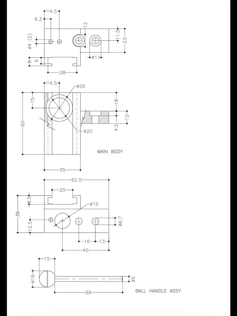

      Gents,
      I am making a spindle lock for my Emco FB-2 milling machine. I am using Graham Meeks design which is made from a single piece of metal. I am using EN1A.
      Grahams design has a long slot which carries the actual locking piece. My question to you is, should I be using a t slot cutter or a woodruff cutter? I am unsure what the difference is between these 2 cutters.
      Thanks in advance for any help,
      Mark

          Here is Grahams drawing, I hope he doesn’t mind me posting it here. It clearly shows the 60mm long slot which has to be milled out.

            Not familiar with the design but normally use a slot drill for slots, some T slot cutters have cutting teeth on all 3 sides of the cutter, a Woodruff cutter only has teeth on the circumference of the cutter.
            Now I have seen the drawing I would use a slot drill to remove material to the width and depth of the slot then a Tee slot cutter for the remainder. Using a slot drill lightens the load for the Tee slot cutter.

              As above remove as much material as you can with an endmill/slot drill, I would use a tee slot cutter which has cutting faces on both sides & the circumference if one is available that small?
              You may get a far bit of distortion in this part if using cold rolled steel, so rough out all faces first & stress relieving would be good.

                The main thing is that Woodruffe cutters have thicknesses and diameters to match standard Woodruffe keys.
                T-slot cutters have sizes to match standard t-slots.
                #455202
                Anonymous
                  As I would expect a careful study of the drawing shows that the central slot is slightly deeper than the slot itself. So cut a slot slightly deeper with an endmill or slotdrill and then use a T-slot cutter. Cutting the central slot slightly deeper stops the T-slot cutter from potentially cutting across the full width on one side.

                    In that application I think a Woodruff cutter would work quite well. If a T-slot cutter is available in a 6mm width it would also work quite well. The process I am visualizing is this: cut the 20mm slot to 8.5mm depth first, then do the undercuts one at a time using either the woodruff cutter or an appropriate T-slot cutter.

                      Thanks all for the advice. I will look at an appropriate woodruff cutter and proceed carefully. My plan is, as you have advised to get everything out of the central slot with an end mill first and then do each “side slot” separately.

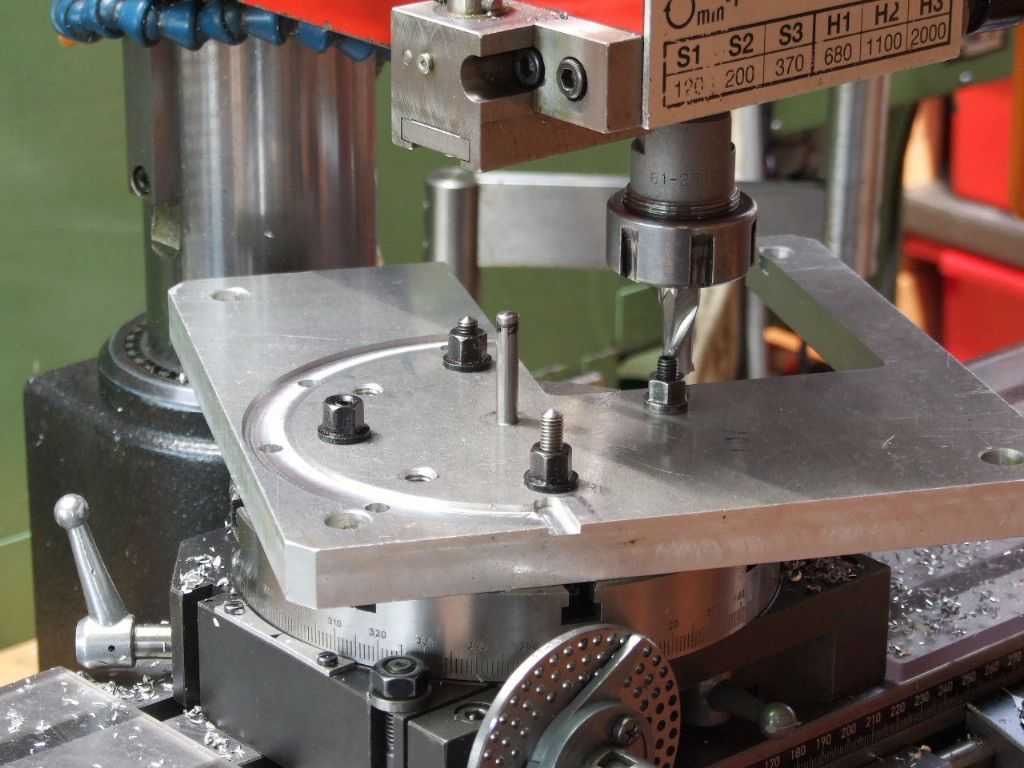

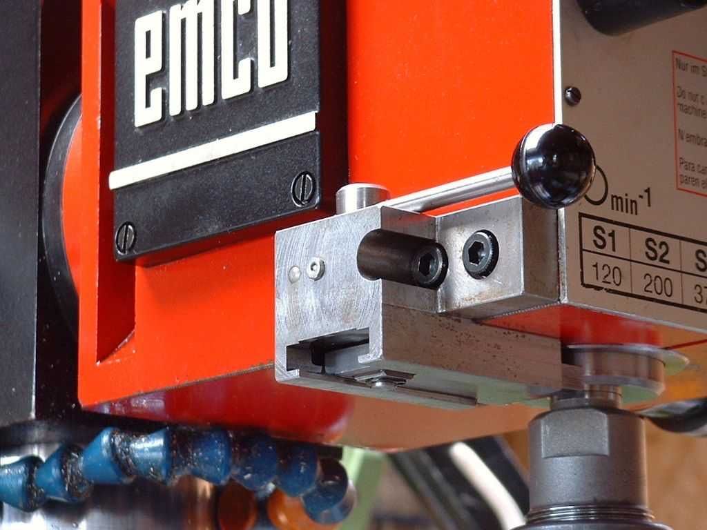

                              #455424
                              Mark Gould 1
                                @markgould1
                                Phil,
                                Here are 2 photos showing the device installed. I think it’s quite an elegant design and although a lot of material needs to be removed, what you are left with is an effective device for solving the annoying problem of not having 3 hands.
                                Mark
                                #455425
                                Mark Gould 1
                                  @markgould1
                                  Again, these are photo’s Graham himself has put up here so I hope he doesn’t mind me re-posting them.
                                  Mark
