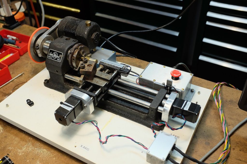

                        Another JohnS
                          @anotherjohns
                          Bob;
                          I converted an old Unimat lathe to CNC operation, and it has done some good work.
                          I use the original feed screws. The spindle motor is not great, so am looking for another solution for powering the spindle. (may go with the stepper route)
                          I use a BeagleBone board, running the development fork of LinuxCNC, and I did discuss it at last June's CNC Workshop over in Michigan.
                          There should be information on it here: **LINK**
                          I have 4 pictures of it in my albums, here's one:
                          John.
