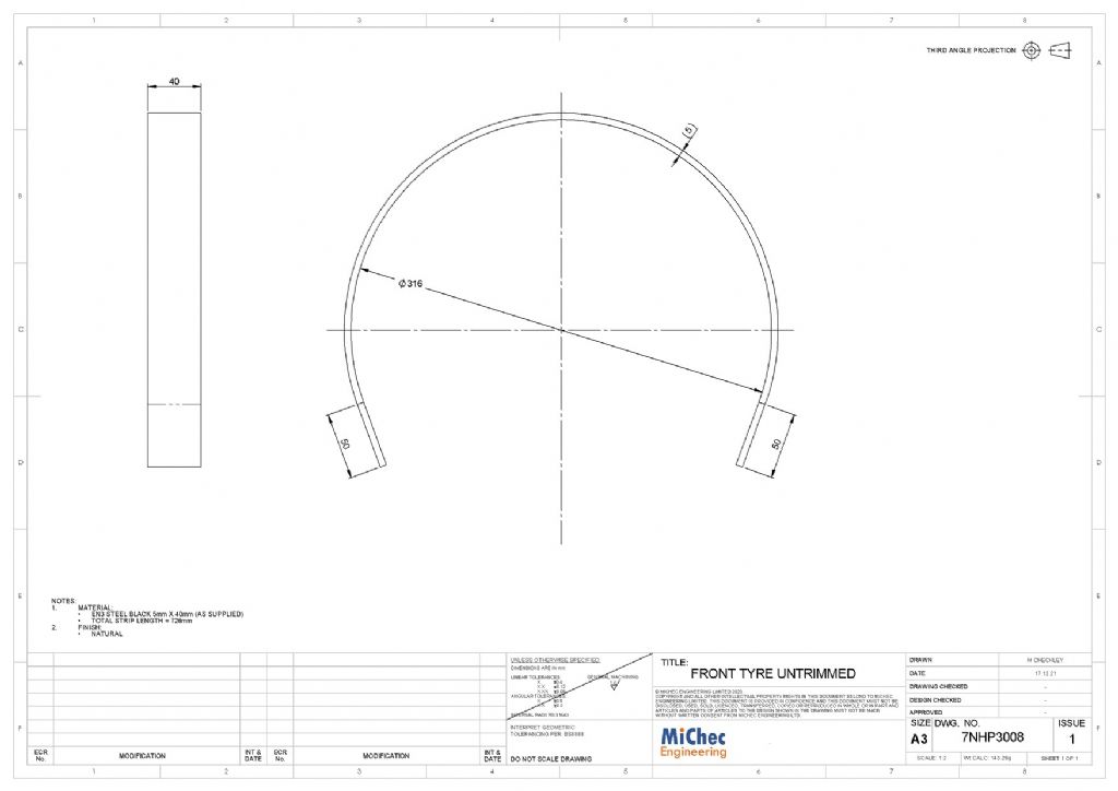

                The job that has come up next is for 40mm x 5mm front wheel tyres for my traction engine project. I do not own bending rolls so the choice was to either buy some or get the job done outside.
                I failed miserably by trying to be too clever and providing a drawing and DXF so they could laser cut the fixing holes all nicely spaced as well as the profile. I did discuss with them making them oversize and cutting them back but unfortunately they didnt and I was left with flats on the ends.
                I have since learned and put together a far simpler drawing which shows an over length curve just from stock flat strip and I`ll cut out the good curvy bit.
                It would be useful to build a relationship with a business that is happy to do these ad-hoc small jobs as I often get asked in work life to do small jobs that are usually too big for me! I have a great network of aerospace suppliers but they all come with aerospace price tags.
                I`ll put the drawing up….
                    Make your own? Like these, rolling my front wheel rims:
                    They're initial pinch, so if you turn the work end for end at each pass you don't get flats. The rims were rolled from blanks of the right length for the finished diameter. When I rolled the tyres for the front wheels the blanks were over-length so that I could cut the ends at an angle after rolling. Rolling with the angle precut didn't work for me.
                    A lesson I've learnt is that traction engine wheel building is all about fudgeit and bodgeit. Trying to be too precise with predrilled holes didn't work for me.

                      I know I should but I cant see me doing much rolling of this thickness again….never say never
                      I thought the guy I used was going to cut them back after rolling adding the angle but clearly they just lasered them out as is hoping for the best.
