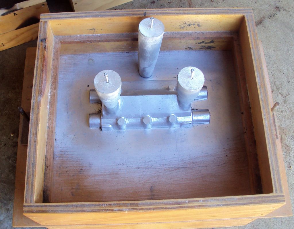

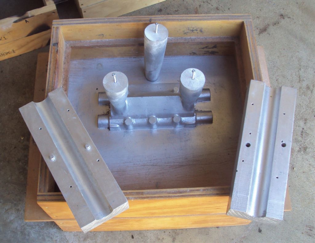

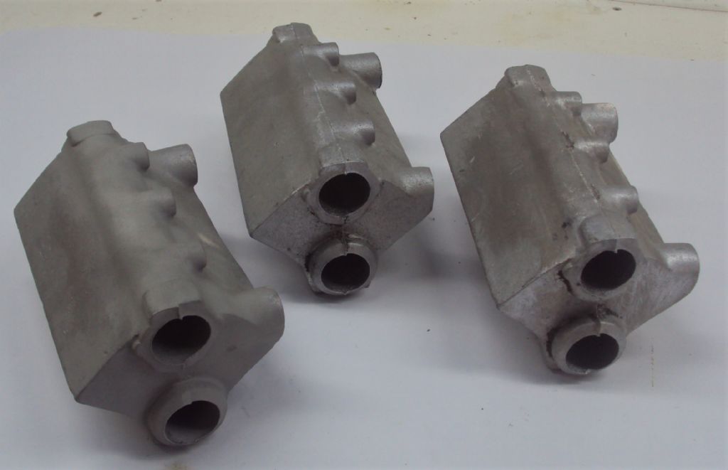

                    Well as its been quite some time since my last little model engine confessions and even longer since updating this thread I thought it high time i pulled finger (as they say) and posted a bit more on the V12 project. I decided to do a bit of a rethink with this engine and went ahead and made some sand casting gear and cast up a couple of new cases for the V12. photos below show the depths of insanity that some will sink into if left alone long enough.
                    So hears the end results
                    Yeah I know I said a couple but if I want to end up with at least one good engine I should probably allow for so oopsies, lol
