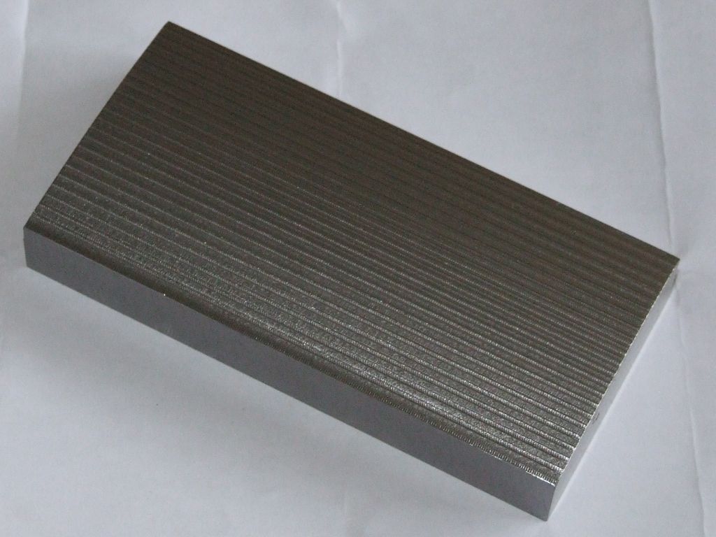

          I use a lot of hot rolled steel, both for my traction engines and for tooling. It has a number of characteristics, some good, some bad:
          It is rather sticky and has a propensity to tear if speeds and feeds are incorrect. I use carbide tooling as a matter of course for turning and milling. Run fast and you'll get a good finish. It won't look like free cutting steel but is still fit for purpose
          I don't worry about the scale, it's not like the hard surfaces on a casting
          The material doesn't go banana shaped when you mill it
          It doesn't seem to be prone to rust like free cutting steel. I get a great finish on EN1A, put it on the hall table and the next morning it shows signs of rusting. Hot rolled doesn't do that, it survives in the kitchen without rust, and the kitchen isn't exactly dry.
          Hot rolled steel is good in tension and compression unlike cast iron.
          This is part of press tool set I've just made from hot rolled steel:
          Andrew
