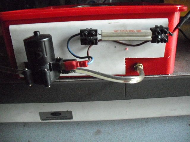

                I use a windscreen washer pump. They are a gear pump and have a DC motor so the speed and thus the flow rate can be varied by adjusting the voltage. Been OK for about 8 years now.

                          Just happened to see that Mike Cox had an article in MEW 181 Oct 2011 for a suds system- he used a windscreen washer pump.

                            I have built a coolant system using a windscreen washer pump. The design was inspired by the Mike Cox article mentioned above.coolant pump
