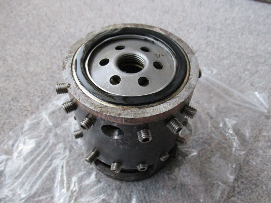

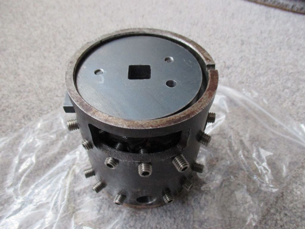

                                  Douglas Johnston
                                    @douglasjohnston98463
                                    Posted by Douglas Johnston on 12/09/2019 13:32:18:
                                    ps I will report back in a year after the next oil change If we are all still here!
                                    Edited By Douglas Johnston on 12/09/2019 13:38:16
                                    I did say last year I would report back so here goes. I spent ages trying to remove the oil filter using as many techniques and tools that I had available and failed to budge the filter. Moving on to this year I thought I would make a special tool to complete the task. After a good rummage in my collection of bits and pieces I unearthed the outer casing of an ancient car dynamo which had just the right inner diameter to slip over the oil filter.
                                    The casing had a wall thickness of about 6mm which was ideal for tapping two rings of 8mm holes for grub screws. The top end was fitted with a 75mm diameter disc of 10mm thick steel which had a 1/2 inch square hole put in to accept a ratchet bar. By screwing in as many grub screws as I could reach I got a great grip on the filter casing and the filter was easily removed. Job finally done!
                                    Doug
                                    Edited By Douglas Johnston on 09/07/2020 11:23:32

                                              Here's what I did to remove a stubborn filter.
                                              Put 2 jubilee clips over the filter body with their worm drives aligned and tightened up.
                                              Found a piece of pipe with id the same as the jubilee clip bands' od. In one end of the pipe cross drilled for a tommy bar. On the other end notched out a circular segment of length such that the clips' worm drives would fit into it. Put the pipe onto the filter with the notch around the worm drives and then used a tommy bar to unscrew the filter.
