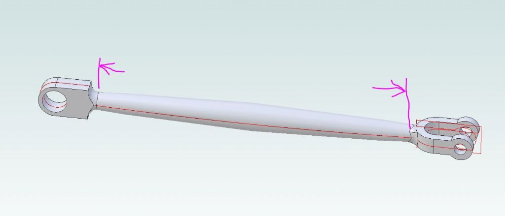

            Still puzzling over the connecting rods. It says to machine the rods down to 0.3” between the lines that mark the extents of the radiused transitions. Then switch to a tool with a 5/32” true radius, to form the transition radius as the middle diameter is reduced. But if you’ve just reduced the diameter between the extents with a step, how will the radiussed tool get rid of the step? You appear to be trying to form an internal radius where you’ve just put a corner, ie you need to add material.
            #536629
              Posted by Dr_GMJN on 27/03/2021 22:22:23:
              The "lines are where the radius meets the taper so you are first turning to where the radiu starts and the second tool will then traverse further to the extent of the radius.

                  Thanks Jason, that would make more sense, but it’s not what it says in the instructions. The dimensions in the drawing are to the edge of the radius on the rectangular bits, not the circular section rod. Those same dimensions are also in the text, where it says to initially machine down between them. If you follow the written instructions, I think the radius would crash into the first set of bolt holes for the strap.
                  It also says to mark the extents of the initial thinning with a felt-tip, but then once machined, to use a rule to find the extents of the rad. In that case why would you need a rule? It’s the same dimensions (there are no others), and you’ve just made a machined step to them, so it’s obvious where it is? There’s some error somewhere because you can’t use the same dimensions for both operations and end up with a smooth transition.
                  I think what he meant was to add on the tip radius to the distance from the ends (ie he shouldn’t have quoted the drawing values for that initial operation) and as you say machine initially to that. Then mark with a felt tip and extend as necessary. Why you’d need a felt tip for one job and a rule for the other is also confusing to me – surely you’d just mark the initial length, and the final length and work to those? For me, the instructions are almost too detailed in this case because they seem to suggest different marking techniques for the same simple job.
                  May well have misunderstood something, and I want to make sure I’m not scrapping a part because of this.
                  #536751
                    Yes there is something wrong with how it's written.
                    I would put a sharpie mark where I have put the pink lines on that image as they are easy to see while you rough out without the need to keep stopping and take measurements or have to scribe a deep line across the finished face of the ends. This will knock all the corners off and get you down to a round section.
                    Now that you have roughed out change tool and cut the tapers forming the fillets at the same time either measuring or setting a stop, usually a bit of both is needed as the curve of the tool will extend further along the deeper it gets into the work.

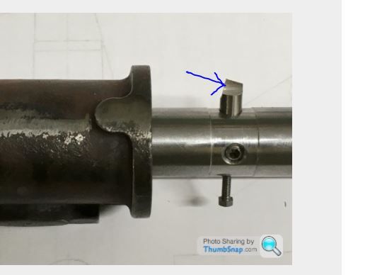

                                          So this is the first attempt. I did shorten it a bit – I can't see doing anything longer than the P.R. cylinders, and wanted to maximise stiffness. I've still got a couple of inches each side of the cylinder to play with:
                                          I didn't have a 6BA tap, so used 7BA for the adjusting screw instead. The locking grub screw is M5 – might need turning down a bit because I think it will touch the bore as it is. The tool hole is drilled at 6mm, and the spare stubs that Ramon sent me are a snug fit in it. The adjuster thread is 4mm long, the tool bore 14mm long. I did turn the middle true – it wasn't really out at all, and I'm not particularly proud of the finish I got, but I don't suppose it matters. Also milled the flat for measuring, and another for the carrier:
                                          I also found a 3/4" carrier in a box of stuff I got with the lathe, which cleaned up nicely. If it doesn't work at least I've got a nice steam punk hammer:
                                          Now to grind a few tool bits. I'm wondering if I should make a grinding holder for them out of perhaps square bar – I think holding by hand isn't really on, and grips might burr the surface such that it might not fit in its socket?

                                            So I 3D printed a grinding jig, which I temporarily fitted in front of the bench grinder. I've graduated the angle markers at 10 degrees (they still need filling with white Milliput), and I'm hoping absolute accuracy isn't essential for this:
                                            Is it acceptable to use the side of the wheel for grinding? If not, I think I need to make another recess in the table 90 degrees to the existing one.
                                            Also made a holder for the 6mm diameter bits that Ramon sent me – my fingers were getting burned without it:

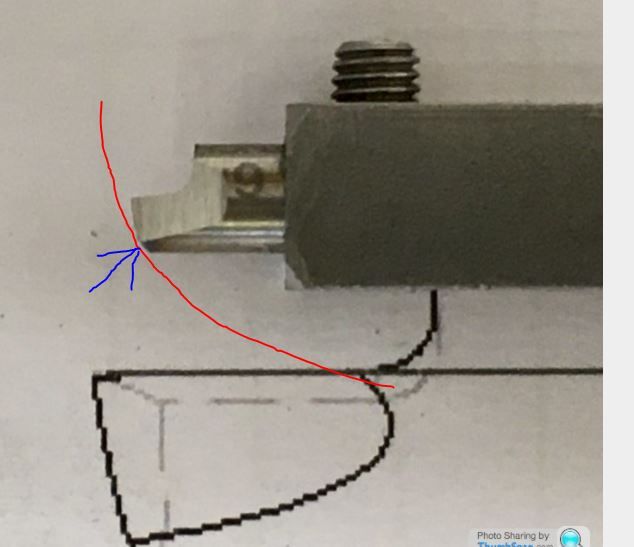

                                            I have followed Jason's diagrams, but I'd like some comments on accuracy, surface finish, whether it needs a tip radius, whether it needs further finishing with the diamond files, or anything else that's relevant. I've never ground tools before, and don't want to ruin a casting through not grinding the them accurately enough. Here is where I am:
                                            Have I ground this in the right orientation? The intention was to set up as shown, and move the cylinder on the cross slide from left to right (chuck would be on the left of these images:
                                            I'm not even sure how the tool should be orientated in the bar, and which surfaces are is doing the cutting! Does centre height setting apply to this method, if so, how to you adjust it? As I said, any and all advice gratefully received.
                                            Thanks.
                                            Edited By Dr_GMJN on 11/04/2021 13:10:51

                                              Looks about right.
                                              Just make sure that the bottom of the tool arrowed in blue does not rub against the edge of the hole
                                              Its the arrowed edge that does the cutting and that's the one you could give a run to with a diamond slip
                                              Best to avoid using teh side of teh wheel if you can

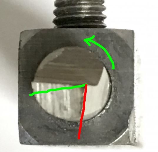

                                                On the last photo I posted, should the tool be rotated anti-clockwise slightly? I noticed the flat behind the cutting edge was angled down in the grinding drawing, but obviously you can orientate it how you want in the bar.

                                                  Yes you want the top face sloping down slightly from the cutting edge as shown in green but make sure the red clearance angle is not lost as you rotate it, you want both to be about 5degrees
