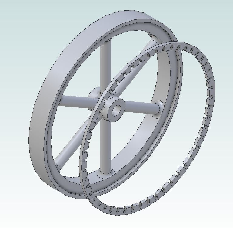

                                          On the subject of the flywheels, the use of a double key, one of them stepped, and the riveted together rims seems pretty elaborate. Couldn't just one key be used, and the rims screwed together with CSK screws, and the slots filled? It's all machined flush in the end anyway. Presumably the key configuration is to replicate the real thing, but I cant figure out why you'd use rivets rather than screws, especially since the rims are Araldited together anyway, so it's not like they're going to move relative to each other.

                                            With a chance that the drill could wander and the reamer just follow the drilled hole I would say there is more risk of different heights when reaming, Boring will true up any wayward drilled holes and provided you have the bottom of the casting against a fixed stop like the vice's fixed jaw then heights should come out the same.
                                            Double tapered keys will be less likely to "tilt" the flywheel to one side which can happen with a single key if the flywheel is a bit loose on the shaft, stepped key is only if things don't line up.
                                            From your photos it looks like you have the "lightweight" flywheels so will have to go about the joining slightly differently and if you want the barring ring than that will have to be added as a separate piece. The reason rivits are suggested is that they also expand in thickness when peined over so will ensure there is no movement unlike a screw with a bit too much clearance that can fret.

                                              Id really like to incorporate the barring notches – how do you suggest do it?

                                                They don't do the heavy one now which just has a rectangular section rim, yours is a "T" shape with the six bosses.
                                                The lugs want removing from both the outer faces anyway, so on one side you would just need to turn a crisper recess and then make a separate barring ring that could be JBWelded into place. If you do it right that will cover the screw heads and as it will be painted could be made from anything easy to cut or what about a 3D print?

                                                I did something similar on this engine where the barring holes were central so made it up from 3 water jet cut parts. Worth looking through it all as it covers a fabricated beam engine.

                                                  That fabricated flywheel looks great.
                                                  I was wanting to try cutting the notches myself, possibly using a gear wheel because I don’t have a rotary table.
                                                  I could get an aluminium or mild steel ring laser-cut, JB weld it into the machined recess, and paint the whole lot. Then machine the notches out of the aluminium? I wanted to leave the notches bright.
                                                  #533491
                                                    In that case do it in steel

                                                    Dr_GMJN
                                                      @dr_gmjn
                                                      I suppose aluminium would look a bit bright.
