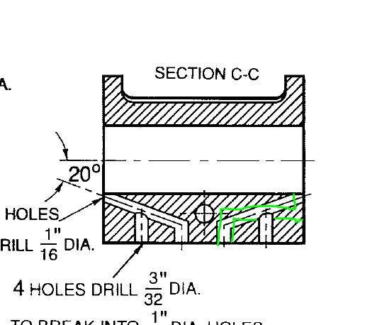

      Having just managed to scrap the cylinder after many days work i’m looking for some advice.
      The steam passage ways that feed each end of the cylinder need to be drilled at 20 degrees to the bore, so I machined a very small flat spot where the holes are to start from and centre drilled them, they are only 1\16th diameter.
      The twist drill didn’t want to go down straight (even though i was “peck” drilling it) and wandered slightly into the direction of the cylinder bore until there was enough material around the drill bit to make it go straight, unfortunately when i came to drill the connecting holes, also 1\16th, they missed the 20 degree passage way, as it was not exactly where it was supposed to be, and came out in the cylinder bore itself, so the cylinder is now scrap.
      How should I of drilled these 1\16th 20 degree holes so that they go dead straight from the moment the drill starts ?

        Start your holes using a 3-flute milling cutter, to a depth of [say] 3/16” or more.
        #771904

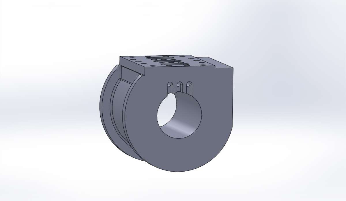

          A small ball nosed milling cutter or 3-flute cutter to get them started. Then a sharp stub length drill which is less flexible and if you can’t get the depth with that change to a standard jobber length.
          Alternative is to take the central two holes in the sides deeper, mill a 1/16 x 1/16 slot in the ends of the cylinder and then you can drill straight.

            This is not a Stuart pump but a similar design could be used.  All holes were drilled square to the faces and a slot milled at the end to transfer steam to the bore.
            Steam holes

                        Unfortunately fitting a liner won’t help as the main steam passage way is already in the wrong place, there is no room left to drill another.
