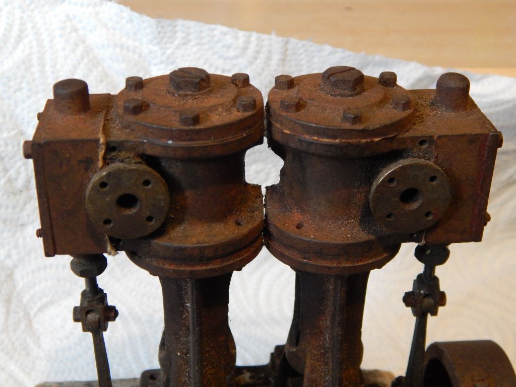

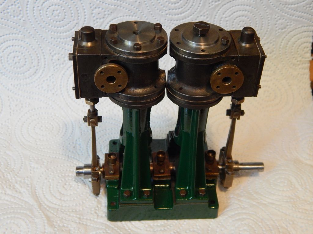

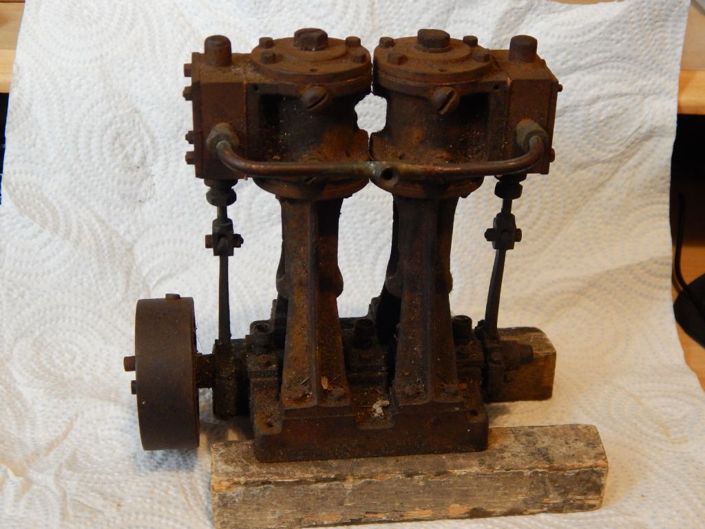

      dscn3474.jpgdscn3471.jpgdscn3460.jpgHi guys, I've just bought a D10 which was in a really bad state, I must admit I didn't realise just how old this engine was till I got it cleaned up and was deciding what nuts and bolts I needed. I got stuck straight off as nothing I had was close and none of my taps/dies/parts fitted anything on it. I know that Stuart used Whitworth threads in the early days so I emailed Stuart Turner to see if they could help, the reply I got said they dont have data going back that far but that it must be 1930's or earlier.

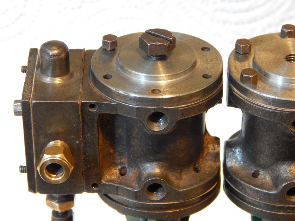

      The drain cock holes were plugged with steel bolts which look to be 3/16" but their 38TPI which does'nt match with anything I can find, same size for the plugs in the cylinder head centers which I'm guessing once had oilers fitted.
      The cylinder head bolts I'm fairly sure are 3/32" x 48TPI which would make them BSW but I might be wrong !
      So I'm wondering if anyone here has info that might help ?
      I have ME,BA and Metric taps dies and fittings but none of them are even close.
      I added a couple of before and after pics….please dont ask which ones are which smileydscn3457.jpg

                    I found that the long bolt in the flywheel was the same thread as the drain cocks and gave a bit more to measure, the thread is definately under 40TPI …..I held it to a 40TPI ME tap and it looks very close to 38TPI …..cant find a mention anywhere of a 3/16 38TPI thread though.

                                  I finally decided there wasnt enough left around the threads for the drain cocks to do anything drastic so I drilled out the holes just enough to run in a 3/16 x 40 tap and it worked out fine, did the same to the heads and all looks good, I've had fittings into them and I'm happy to continue. Need to make some brass thumb screws for the head to blank the holes and order up some 3/16 x 40 drain cocks. The other thing that made up my mind was that I needed to fit shop bought drains so it had to be a thread suitable.
