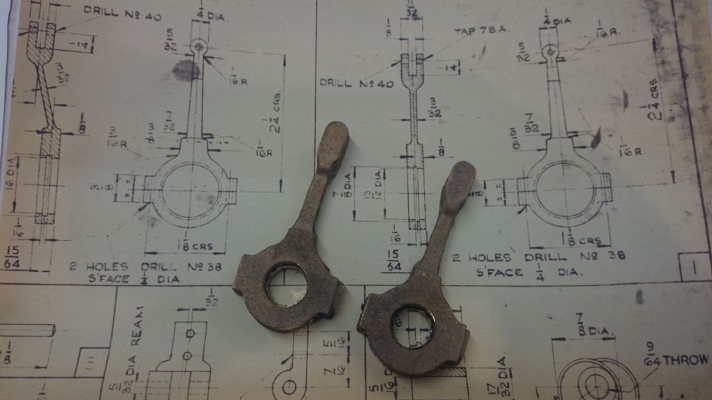

      I`m working my way through a Stuart 7A build and enjoying the challenges! smiley.
      I`m not quite ready for the reversing gear yet but noticed the castings and plan was available on the Stuart models site so I ordered them and within a couple of days they were on the bench in the workshop. They are both straight but looking at the plan one should be 'cranked' I asked Stuart if I had ordered the wrong one but they said I would have to bend it after machining, surely it would just crack? Any recommendations on the best way to tackle this would be much appreciate.
      Thanks in advance

          I too would be a bit dubious about trying to bend one of those. I don't know if it is a casting or a stamping, but either way it does not seem likely to be the sort of material that would bend nicely without suddenly breaking. Also ideally the centre to centre distance of the two eccentric rods should be the same…how do you ensure this if you bend after machining?
          I made a set of rods for a double ten where both had the fork offset by the same amount, so that the expansion link ends up aligned with the inside edge of the two eccentrics. This made a tidy job, but those rods were fabricated, eg separate strap, rod, and fork ends. However, given that you already have the two one piece rods, the same sort of thing could be done by machining a flat on the existing fork end and silver soldering an extra piece on one side. The equivalent amount could then be machined off the other side and the fork machined with the correct offset.
          #183385
            Michael,
            I am not familiar with the items, but I did find the Parts List, which lists qty. 2 the same, in Gunmetal.
            It looks a rather perilous bending job! … I wish you well.
            #183388
              Gun metal is quite soft and will bend that far without a problem. Worse that can happen is the rod will snap which will give you teh oppertunity to make a more prototypical steel one to fit to the strap.
              I would machine the straps, bend and then do the forked end to make sure you get teh hole and slot in exactly the same place.

                Hi John, The change in center distance once bent is a good point! I will have a go at bending it and then machine final details in last as Jason Suggests. Would you suggest applying some heat to the area being bent?
                I think next time I will work from solid as cleaning up some of these castings is more work than working from scratch. Although I may just get that opportunity! frown

                    I had the same worries myself so decided to make mine from stock. This also gives you the option of adjusting the hole centres to compensate for errors in the rest of the valve train and thereby getting smoother running in both directions.20150316_193850.jpg
                    I also made a polycarb valve chest cover to help with timing it all up.
                    After reading your post I've just nipped out to the workshop and belted the original strap about just to see whether it could be done without annealing and this is the result.
                    Its not quite right, but it proves it can be done with a bit of confidence and a piece of ali or plastic as a punch.
                    I like the adjustable option myself.

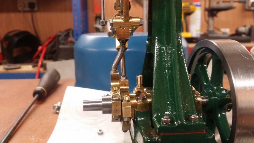

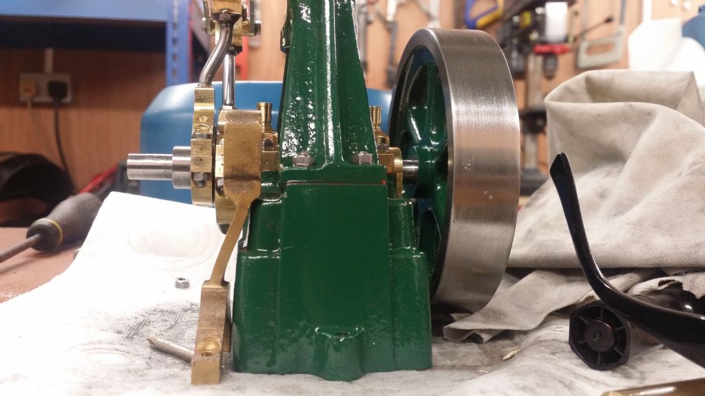

                      Thanks Mick, good to have it confirmed that tehy will bend, I like to use an old F shaped adjustable spanner to bend things like this.
                      Another option to the round rods is to make them from flat, but you won't get the adjustment of a threaded one, something like this

                        Having seen your adjustable rods I think I prefer how they look over the bent casting and the adjustability is a bonus!

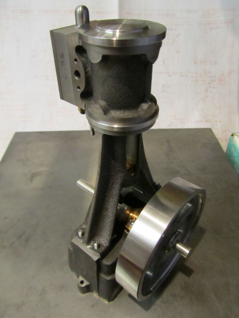

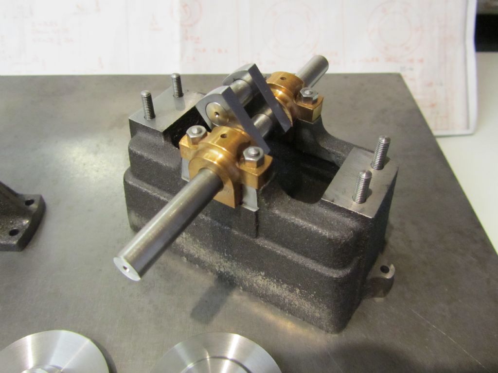

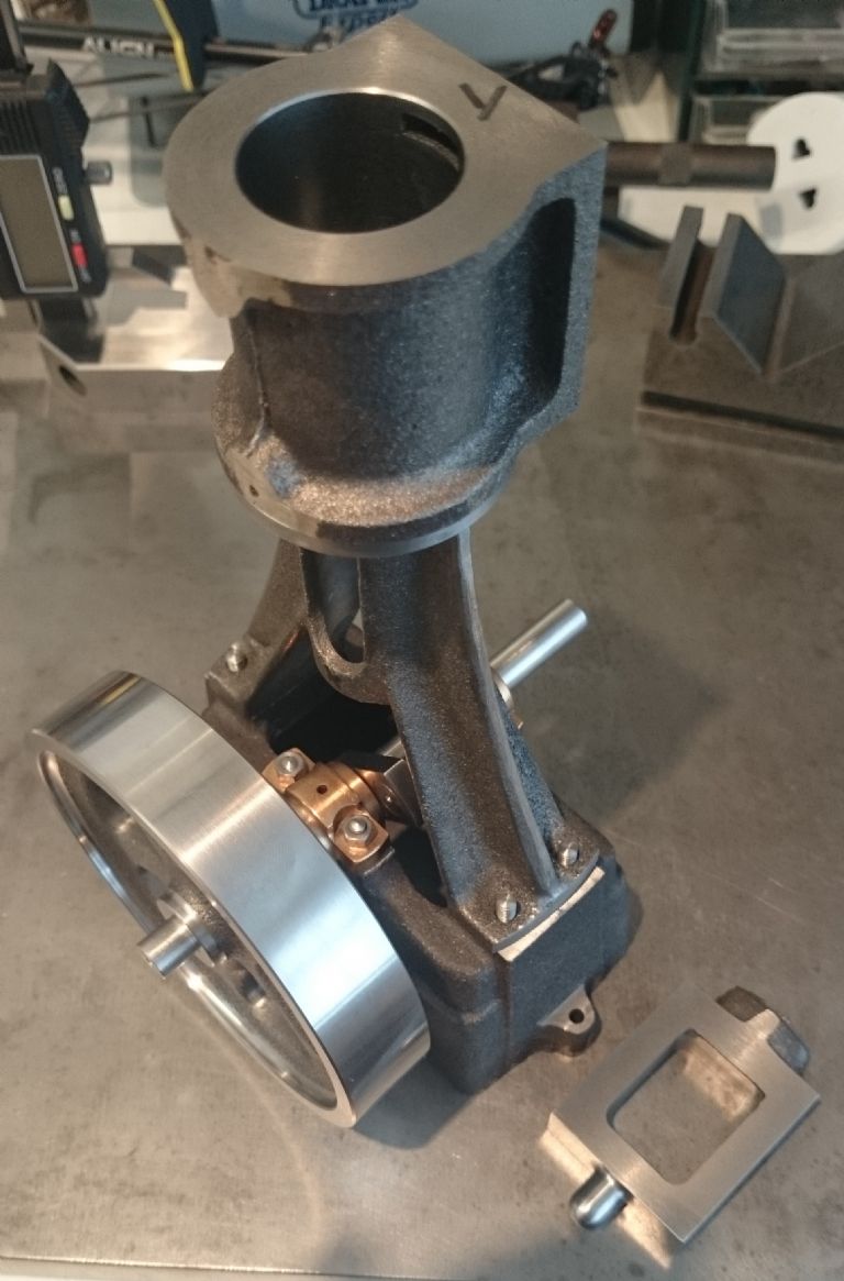

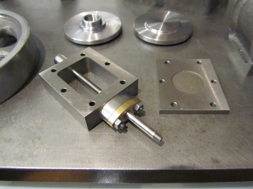

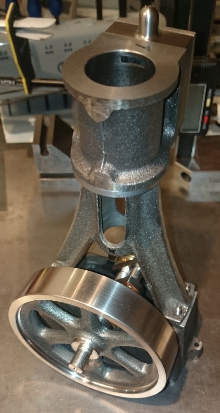

                                Some progress on the 7A and it is starting to take shape. I still need to pin the crank shaft before I can machine the bar out from between the webs but once that is done its time to have a go at the eccentrics and conrod.
                                I have made the cylinder end plates slightly larger on diameter as the plan is to use 1mm thick strip wood lagging around the cylinder.

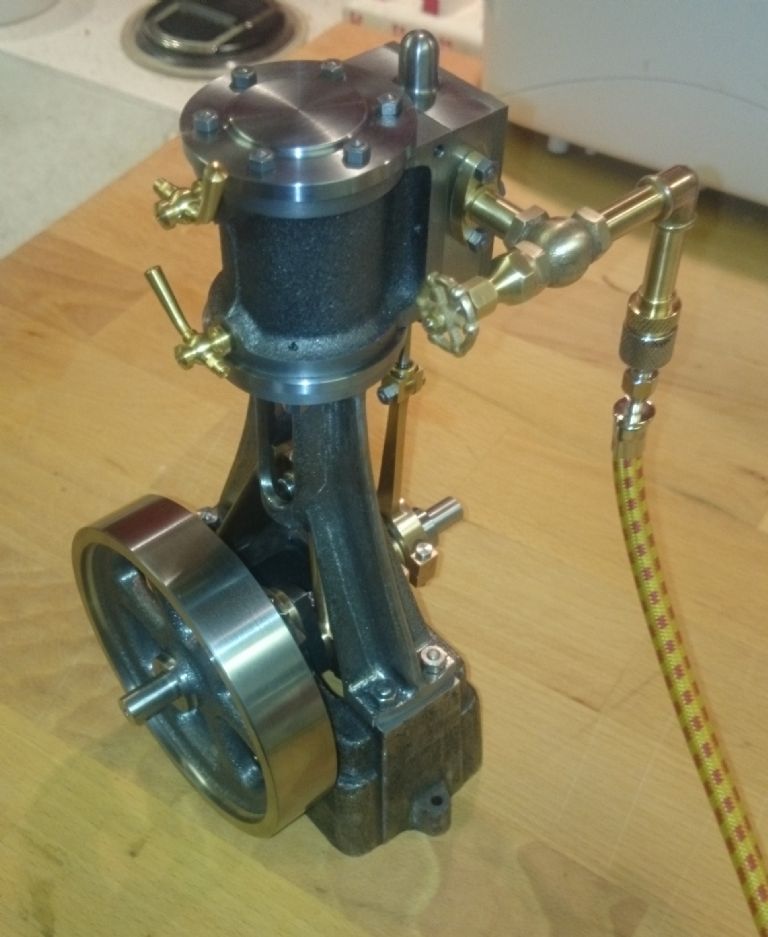

                                    First run last night running on the compressor, one flick and she was away. I was so pleased, it was running for most of the evening and is now probably worn out! laugh.
                                    I didn't touch any of the adjustments for the slide valve, just set it as per the drawing and let it loose. The compressor was set to about 25psi.
                                    Video….

                                        Lovely job Michael, very impressed!
                                        Don't be afraid to drown it in oil at this stage though would be my only suggestion.
                                        How's the reversing gear coming on dare I ask?
                                        Well done!
                                        Mick

                                            Hi Mick, Yes I agree it needs a good going over with the oil can before it runs again. Once running I couldn't bring myself to stop it! I wonder how well the idea of running an airline in to the living room would be accepted at home?…The castings for the reversing gear are still in the box. I thought I would get the engine running on the standard parts and get a fresh injection of enthusiasm before tacking some more castings.
                                            Still to do is some paint and wood lagging so just a little too late for the Midlands show but perfect timing for considering the next project!
                                            The mechanism is shown off much better when running slowly but it will certainly go when the valve is opened up!
