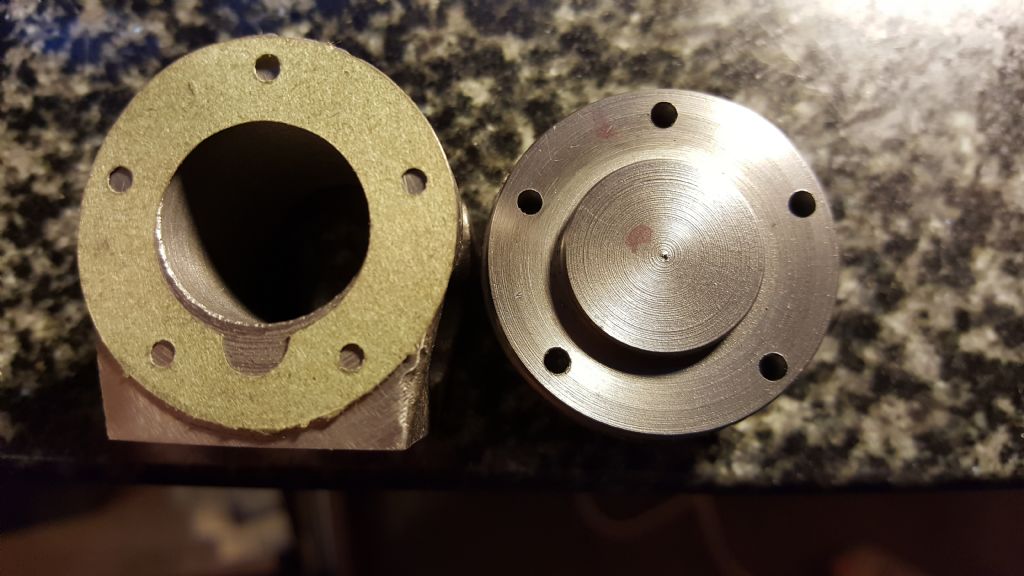

        tried many times now to get the PCD function on warco D60-70 dro to work when creating the hole pattern for the Stuart 10v cyclinder covers.
        Even put the gasket down to see how the first to holes lined up and spot on but tend to drift on the 3rd hole and then the last 2 are no where near.
        followed YouTube … done little machine shop calculator and all looks ok but holes do not match.
        I am doing a bolt circle on a 1.125 inch pcd…5 holes…starting angle 0 ending 360 (which seems to be correct when watching you tube vids). Centre on zero bang in the Centre of cover plate.
        enclosed a photo20170801_205733.jpg.

          Most DROs need you to enter the start angle eg zero and the angle of the last hole 288deg in this case (360-72)

            I think you'll find it easier to use the cover as your drilling jig , use transfer punches through the holes already drilled to pop your hole centres, if you don't have any make one out of hardened & tempered silver steel, IIRC mine was an offcut of 2.5mm. I have sets of transfer punches but they are too long for such a small cylinder hence making one about 2" long.
            ​George.
            #309915
              Looking closer Georges method may be better as the holes in the cover do not look equally spaced, the lower two being further apart so DRO won't compensate for that.

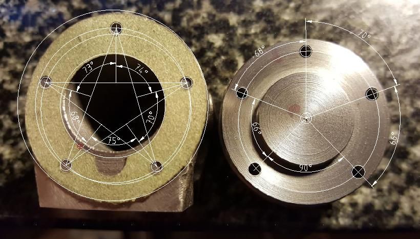

                          Matt,
                          Looking at your photo reveals the possibility of two faults. (But be aware that the measurements may be distorted because the photo is tilted. As it could be an optical illusion, and you should check the real objects.)
                          Bearing in mind that the measurements are approximate, it looks as if:
                          • the gasket has the holes cut correctly at 72 degrees each, but the diameter was off centre.
                          • the cylinder head was correctly centred, but the angles are wrong for 5 evenly spaced holes. I'd guess that the angle between holes was somehow set at 67.5 degrees rather than 72 degrees, leaving 90 degrees between the first and last holes.
                          I often make mistakes doing this kind of work. Now I always rehearse on a bit of wood or cardboard before cutting metal, and check it carefully.

                                      Ok sorted….start 72 degrees end on 360 degrees and hole pattern correct.
