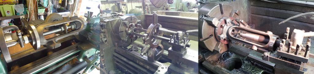

        I got myself a set of 10H castings as a little college project as I've finished all my work 5/6 months early. I've already done a 10V but the 10H is in my opinion a much nicer looking engine.
        I've looked online and can't seem to find anything about machining the trunk guide for the cross head. I have a few possible ideas on how to do it but I hope someone on here who might have made one knows one of the best ways to do the job.
        Thanks,
        Dan.
        #177621
          A lot will depend on what machines you have access to.
          1. Clamp the casting to an angle plate on the lathe faceplate and bore the guide and face the cylinder mounting flange at the same setting.
          2. Clamp casting to lathe cross slide packed upto height, use between ce3ntres boring bar for teh guide and flycut the cylinder mounting flange.
          3. Clamp vertically to an angle plate on teh mill, boring head toi do teh guide and mill teh cylinder flange
          I'm sure there are a few more ways, here is how Harold Hall did his

            Would I be able to ream the guide or is it best to bore?

                    Dan, you will need to bore the hole anyway as its a cored hole in the casting so a drill won't run true and the reamer will just follow where the drill went. The two slots at the side could also affect how well a reamer would cut.
                    So not really much point in boring undersize and then reaming you may as well bore it to finished size and the crosshead can be machined to fit if you end up a bit over or under size.

                      Jason has provided a selection of methods that represent good engineering practice.
                      A small but important point. When setting up ensure the outside diameter of the trunk guide runs as true as possible as the cored hole may not be concentric with the OD. The finished job will look much better with the bored hole finishes concentric with the OD.

                                Hi Dan,
                                Not a 10H engine but this is how I machined the trunk guide for my Ruston traction engine.
                                1. Made a mandrel to turn the ends of the trunk guide between centres.
                                2. Turned a mounting plate on the lathe to accept the trunk guide. The mounting plate was made from an old pipe flange which I found in the junk bin and because it was turned and faced on the lathe prior to mounting the trunk guide, I knew it was accurately on centre. Clamps for holding the trunk guide were made from steel angle.
                                3. Supported the end of the trunk guide with a lathe steady and bored the guide.
                                4. I had to make a special boring bar holder to face the inside of the trunk guide for the stuffing gland. Made from a piece of round bar to fit the tool post, tapered at the front for clearance inside of the trunk guide and drilled at the end to fit a small (round) cutter that I use in my mill goring head.
                                Paul.
