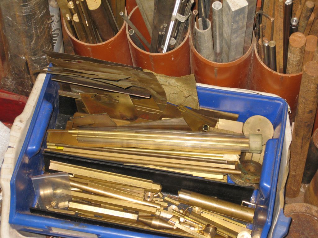

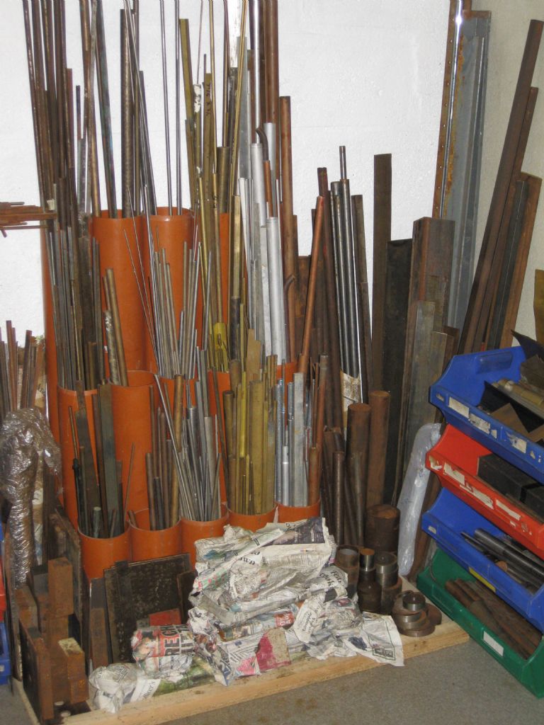

                    I use 4" drainpipe on end. There are 5 rows of pipe, 1 x 12", 1x 24" 1 x 36" The pipes are glued together with normal plastic glue and are self supporting. They sit on a piece of 1/2" plywood.
                    The pipes are set a little way from the corner so that large pieces unable to fit in the pipes are able to be propped up in the corner.
                    Pieces that would get hidden in the short pipes are put in Linbins. The items wrapped in newspaper are steel billets.
                    Works OK for me.

                        Dave, are you the local materials stockholder !! you have an extensive collection of materials.

                          Yes a veritable treasure trove there Dave. i'm envious indeed.

                            Most came from the local scrap yard before I escaped and I think the original source was HM Dockyard, Devonport. All I need now is the will to use it!
