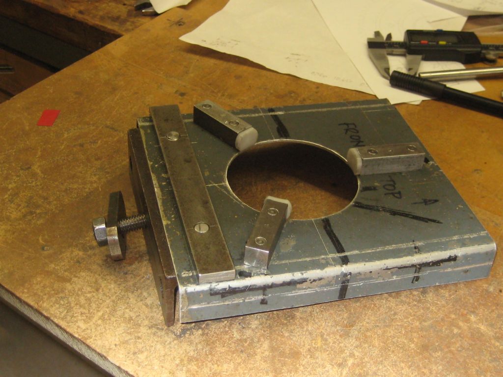

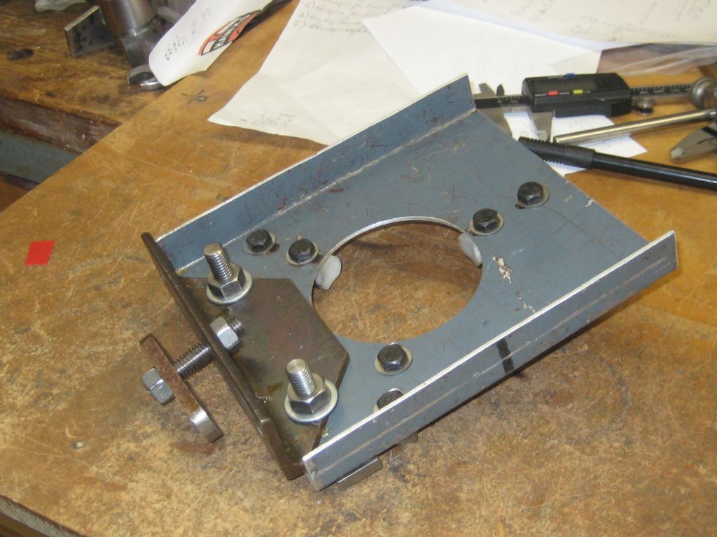

                  Nick Wheeler
                    @nickwheeler
                    If you can weld, then a steady rest is easy to make from some thick wall tube and bar and some fitting.
                    Some years ago John Stevenson showed how he made large steadies from bolting laser cut pieces together, which is quick, easy and frugal.

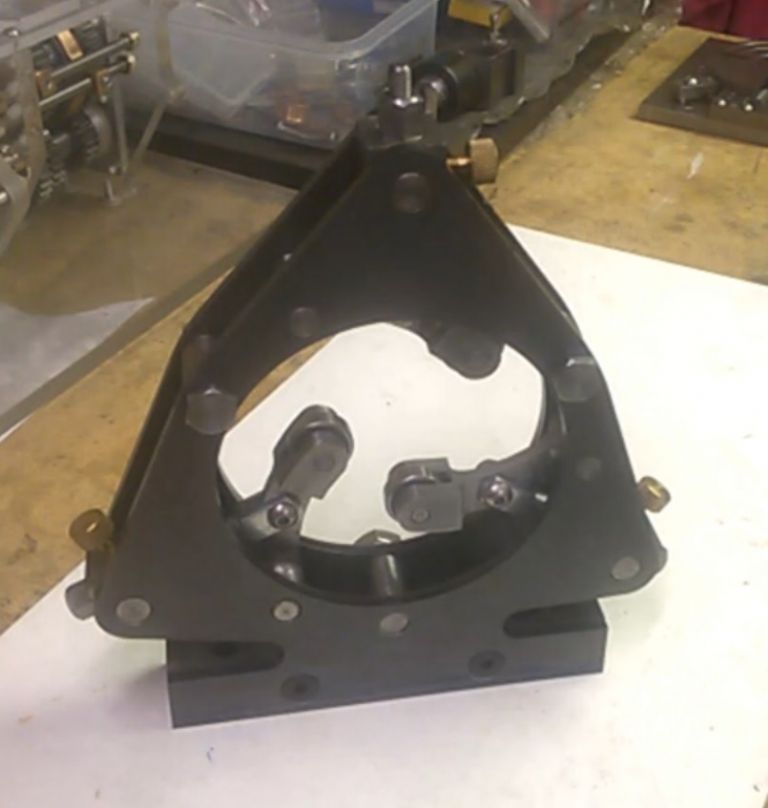

                              Posted by Clive Foster on 19/01/2023 09:53:19:
                              Alternatively a couple of small ball bearings ought to work just as well as a V cut out. (Cue 600 post discussion as to weather (sic) bearings are better than pads!)
                              Should I ever need to make a large steady I'll try doing it that way. I have a vague memory of seeing a picture or published design along these lines, possibly based on two steel rings welded together with suitable spacers between.
                              Clive
                              Do you mean something like this,Clive?
                              Pretty poor quality pictured, snipped from the YouTube video that I made of the accessory.  A clearer and fuller description is in the video itself and there's a write-up in MEW, too, issue 287 November2019 pages 9 to 15 . The capacity goes from about Ø5mm to a smidgen over 90mm. I used the ball bearings as an experiment and the swinging arm arrangement for the adjustment was chosen to combat the "long finger" problem mentioned above. The steady featured is a travelling one but a similar design would be equally suited to a fixed version. In fact, using the ball bearings would be better suited to a fixed rest, in my opinion.
                              Edited By John Hinkley on 19/01/2023 14:05:53

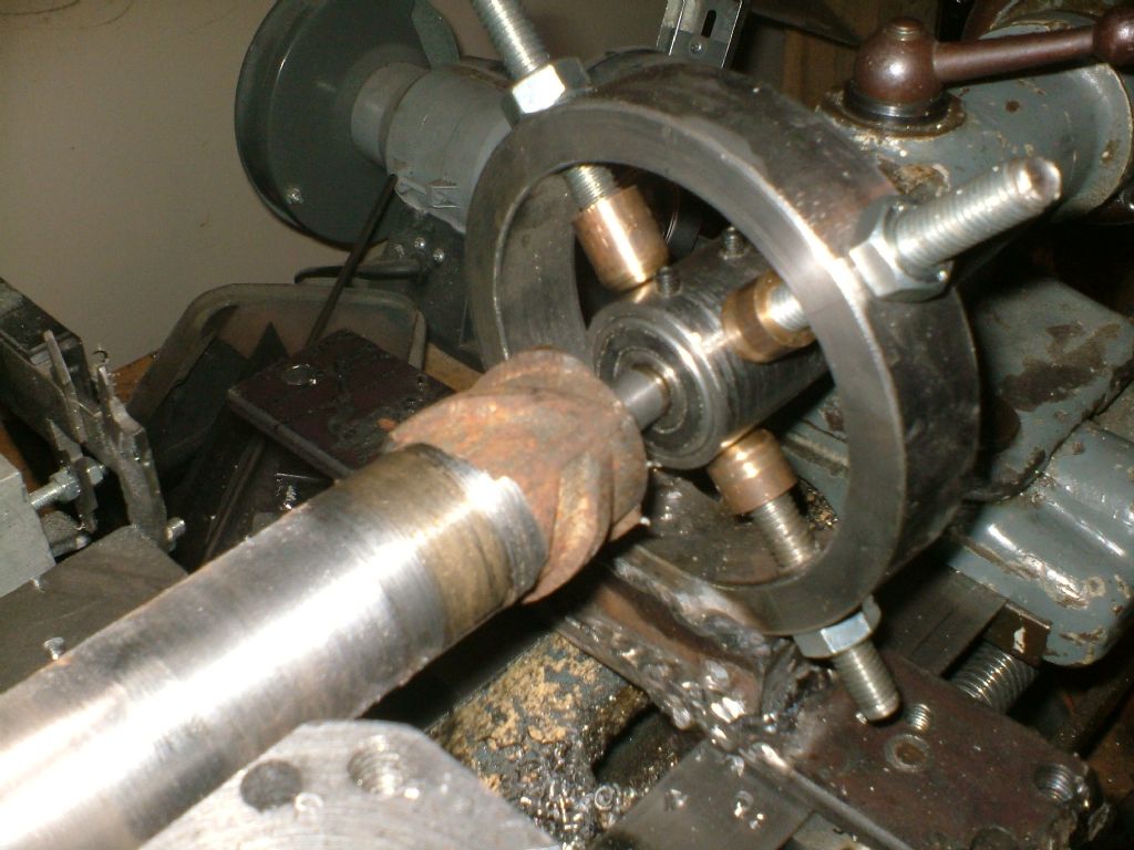

                                        img_0123.jpgAs you say, doesn't have to be a work of art ! I usually get the plastic faced bearings a nice running fit on the job before finally tightening the large clearance bolts at the bottom. Fits my Super 7.img_0122.jpg

                                          That just needs a coat of paint to move into the much better than it needs to be and I thought was going to be categoryyes

                                            ChrisLH:
                                            What plastic did you use?
                                            I suppose oil-filled nylon might be a good choice.

                                                I like the simple approach that ChrisLH has used.
                                                Model engineers and home workshop types tend to overlook the stiffness of judiciously bent sheet materials. I guess hefty lumps of solid material feel reassuringly much stronger and stiffer even though the extra weight adds pretty much nothing to the useful strength. It does kill vibration tho'.
                                                Probably doesn't help that most of us don't have kit to easily and accurately bend adequately thick material say 10 gauge / 3 or 4 mm steel.
                                                I'm minded to try something similar for my P&W B as I have no steadies with it. That is a larger machine, 12" swing in American terms meaning almost 14" in reality so a bit of beefing up seems indicated. One piece construction with flange all round having an integrated foot with all corners welded should be usefully stronger. Taking the top corners out so the upper part is sort of half a hexagon ought to help too. As will cutting some slots across the flange bends to weld in triangular fillets. Welding will need care to avoid distortion. The simple bar fingers bolted through slots make things useful stiffer too. Two sets of fingers, one short and one long, would be advisable for the bigger machine so there is plenty of fixing area.
                                                I think delrin for the pads unless I decide to use up the small ball bearings in the useful bits box.

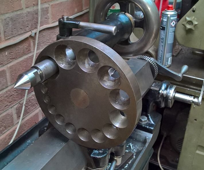

                                                  Here is an unusual type that has different sized holes and can be rotated and locked to suitpittler steady.jpg
                                                  #631431
                                                  Bruce Voelkerding
                                                    @brucevoelkerding91659
                                                    Vic – is that really a Steady Rest ? The Holes appear to be conical all the way thru. Is it actually a Device to steady the End of long Stock so a Center Hole can be drilled in it ?
                                                    #631435
                                                    vic newey
                                                      @vicnewey60017
                                                      Posted by Bruce Voelkerding on 31/01/2023 12:16:14:
                                                      It's a fixed steady rather than a travelling one, the barrel of the tailstock is shown inserted there as a means to accurately adjust the the setting so it will remain centred whichever one is rotated to. Ideal for rod & wire work
