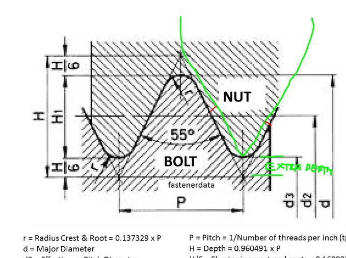

                  #654860
                    Pic of why a pointed tool (green) or one with incorrect radius when fed in the set dimension doe snot reach the flanks of the thread

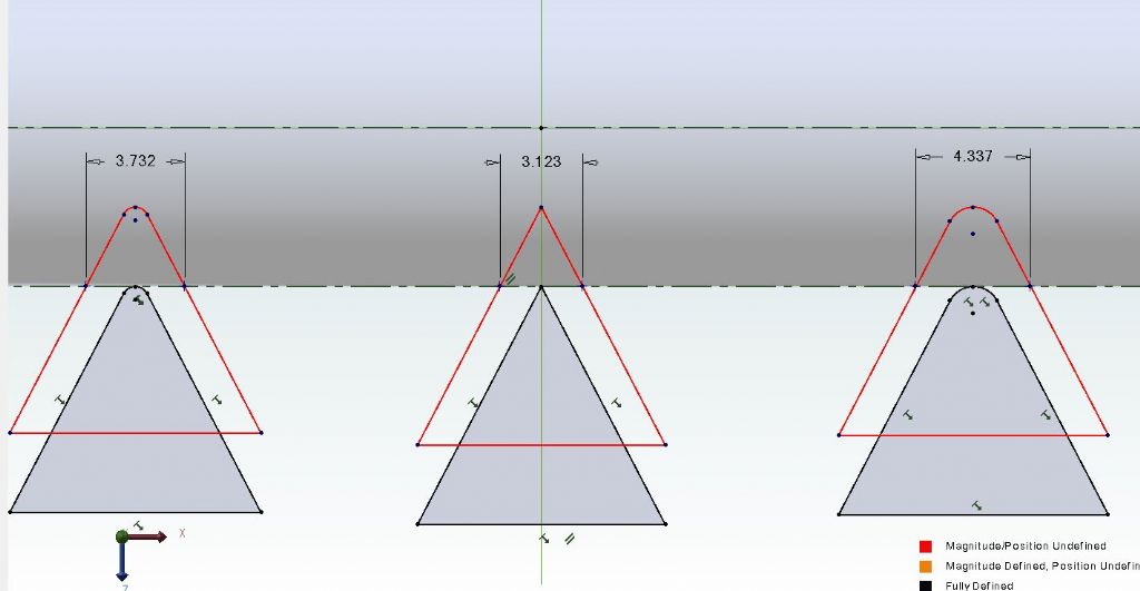

                                          Posted by Jim Gardner on 02/08/2023 17:44:42:
                                          Thinking about it some more, it seems to me that depth of cut, is depth of cut regardless of full or partial profile inserts.
                                          Couple of image sthat may show why some depths of cut are more correct than others. Nothing to scale but just to show the differences
                                          First shows three 55 degree tools, on the left is what a partial would look like with a small radius, in the middle a simple vee form straight off the bench grinder and on the right a full form with the larger radius to suit it's particular pitch If we touch off on the side of the shaft and then infeed 3mm the width of the Vee at the edge of the bar varies, the two sides of the vee are the thread flanks.

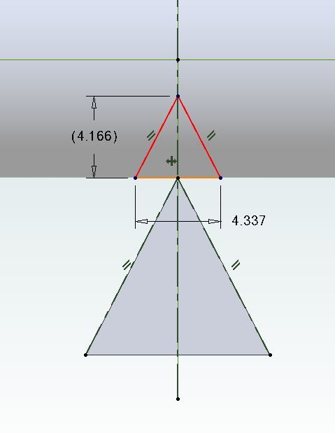

                                          If we now try and cut a thread with the middle pointed form and the right hand full form both to the same 4.337 pitch as the full form you can then see that the full form has gone in and cut the correct thread but the pointed form has not gone in enough and the crest is flat and measuring with thread wires wire would measure a larger value

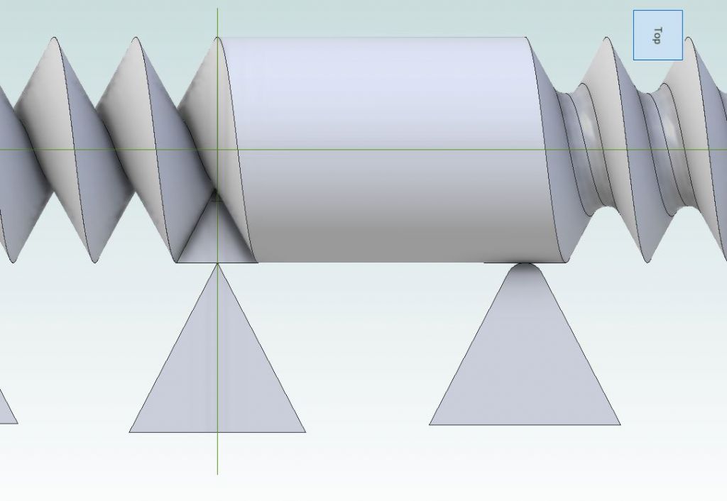

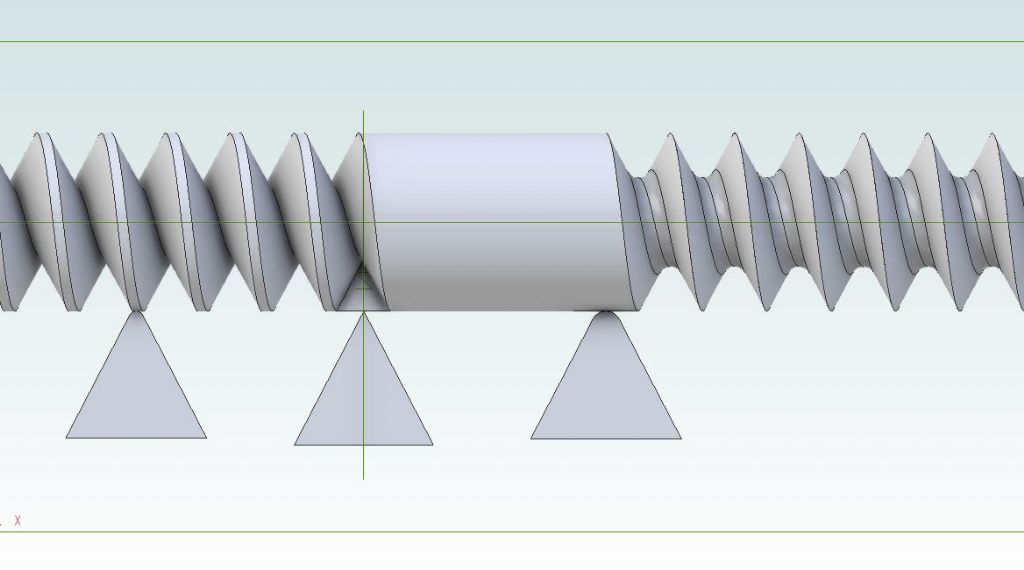

                                          Now if the infeed of the vee tool is increased from 3mm to 4.116mm so that the flank distance becomes the same as the full form
                                          You will then get a thread form that has the correct flank distance and if measured by wires would equal the 3mm infeed of the full form insert
