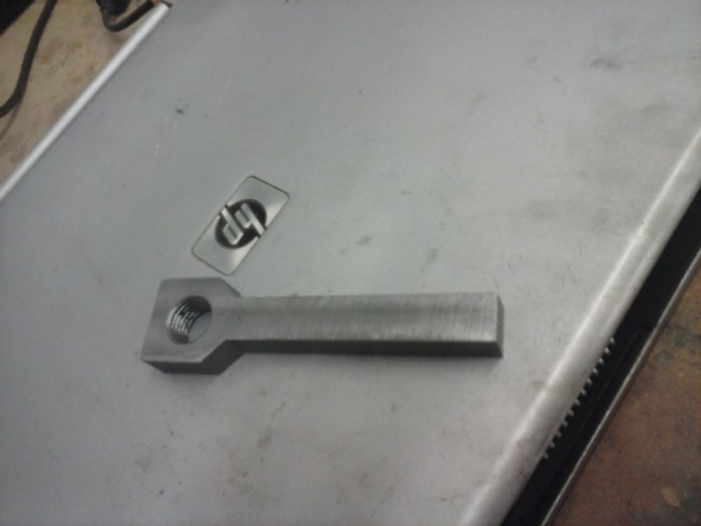

        Paul Lousick
          @paullousick59116
          The toolstock adaptor for my Dremel is very simple and made from a scrap piece of aluminium.
          The plastic threaded sleeve that the grinder screws into is made from one of the unused accessories that came with the grinder. Therefore did not have to make a thread, just bore a hole in the adaptor to hold it.
          Paul.

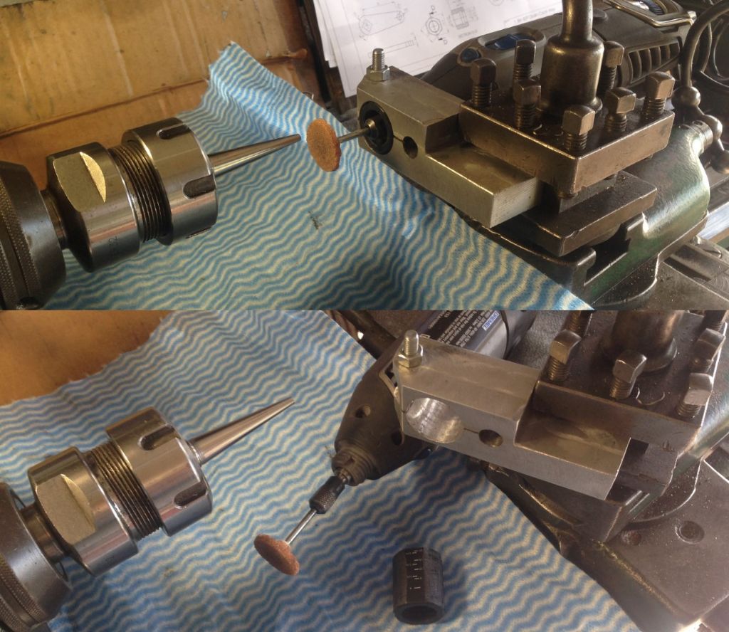

              pgk pgk
                @pgkpgk17461
                Another simple holder. Can't remember the thread i cut but it was a dremel copy anyway..

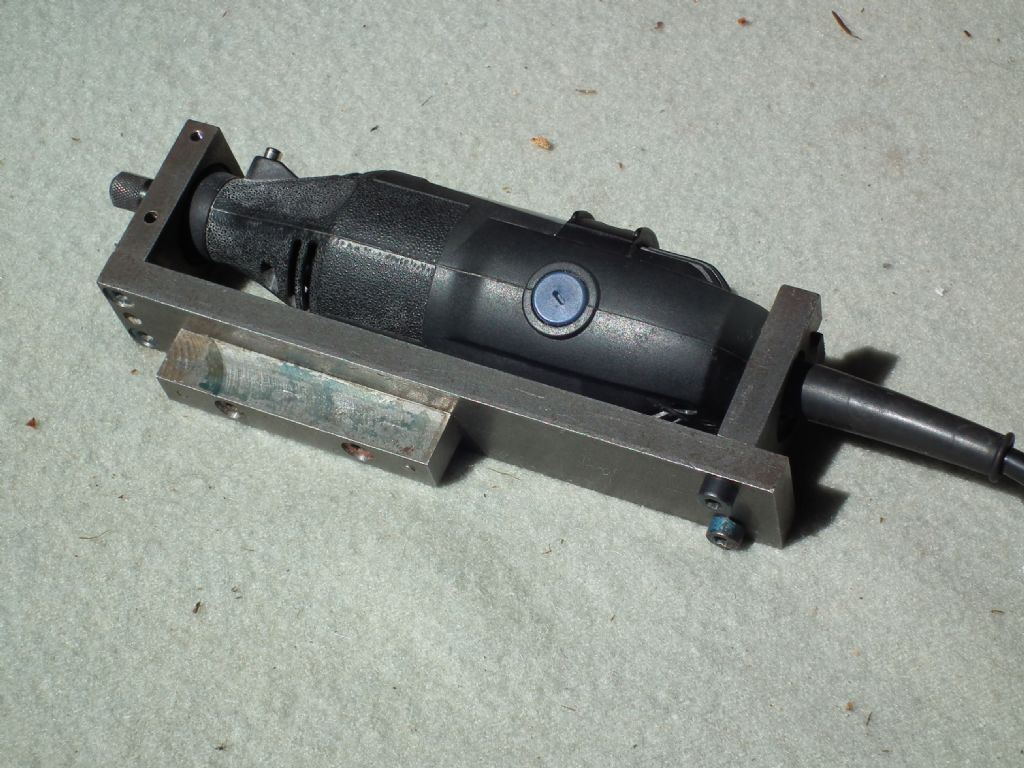

                        Roy Vaughn
                          @royvaughn26060
                          This is my somewhat over-engineered but rigid Dremel toolpost holder:
