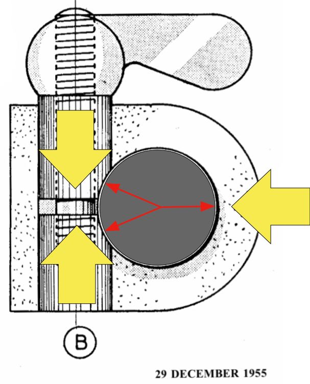

          What a performance to add a clip from a CAD drawing, but here it is. As you will see I've drawn the clearance exaggerated, but the principle holds, it contacts first at the outboard end
          Edited By duncan webster on 26/06/2021 10:22:25

            Posted by Michael Gilligan on 25/06/2021 21:35:57:
            As promised, Martin : Here’s my version of the clamping geometry
            … with the bar shown smaller diameter, for clarity.
            Assume that the bar is ‘grounded’
            • Tightening the clamp screw moves the two pads
            • That in turn moves the whole block sideways
            • Clamping then takes place at three lines [running into the page] with locations roughly indicated by the tips of the red arrows.
            • Because the clamp radius and the bore in the block are [in reality very slightly] larger than the bar radius, there can be no other contact … it’s just those three lines.
            With appropriate dimensions; these movements, and the clearances created, will be small : but they do say “a miss is as good as a mile”
            Edited By Michael Gilligan on 25/06/2021 21:38:42
            Hi Michael
            I don't disagree with what you say and when the pad bolts are machined in situe when the main bore is bored then the arrangement will be pretty much as you describe. However even when machined as just stated there must be some clearance in the pad bolt bore itself and tightening the bolt may well move the line if contact quite possibly inwards.
            To return to the situation of the OP that of the front bar of the Quorn it is impractical to machine in situe and a fixture is made to generate the pads seperately. In fact it cannot be guarenteed that the offset of the pad bore to the main bore in the fixture is exactly the same as that in the finished clamping system. In consequence the actual relationship of the curve on the pads may not be absolutely concentric with the main bar and it is anyones guess where the contact line will actually end up when fitted.
            Taking the above statement to be the case. We should design for worst case which is when the line of contact is at the inner most end of the pad as this is the point of shallowest taper. Therefore if we use Duncan's formula of G = D/8 wherever the line of contact ends up there can be no wedging action and the cotter will always self release.
            As I said I agree with your analysis for a perfect assembly, but even in that case parts wear and the wear on the pad will tend to eventually conform it to the radius of the main bar whereby your slightly larger radius on the pad disappears and contact is possible towards the inner ends of the pads. I'll ignore flexibility and material compression.
            In practice locking is encountered at times. I have made a number of pad bolts and it can happen. My initial post was intended to show that offset was there just to allow clearence for the bolt and had nothing to do with the clamping action. This got us onto what does matter to clamping and to the subsequent debate.
            So my conclusion is that whilst lockup will not normally happen if the system is made perfectly as you describe and is in an unworn condition, to ensure that it can never happen when that is not the case, having a Gap equal to one eigth of the main bar diameter is good practice, especially when the pads have not been machined in situe in the first instance.
            regards Martin
            Edited By Martin Kyte on 26/06/2021 11:15:07

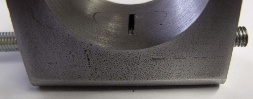

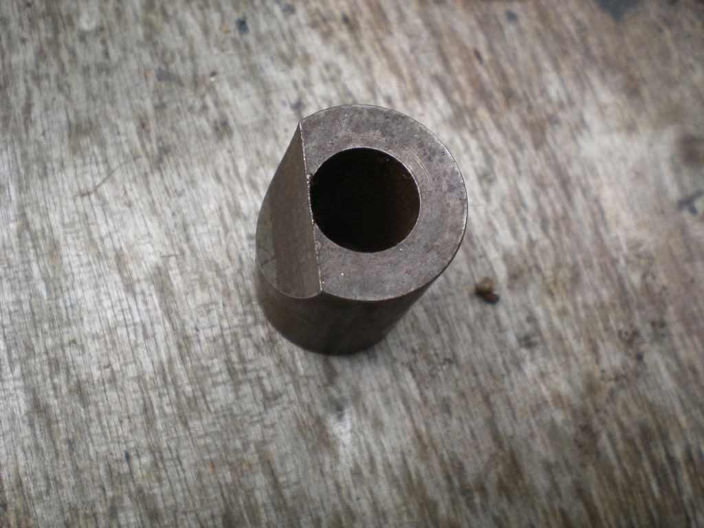

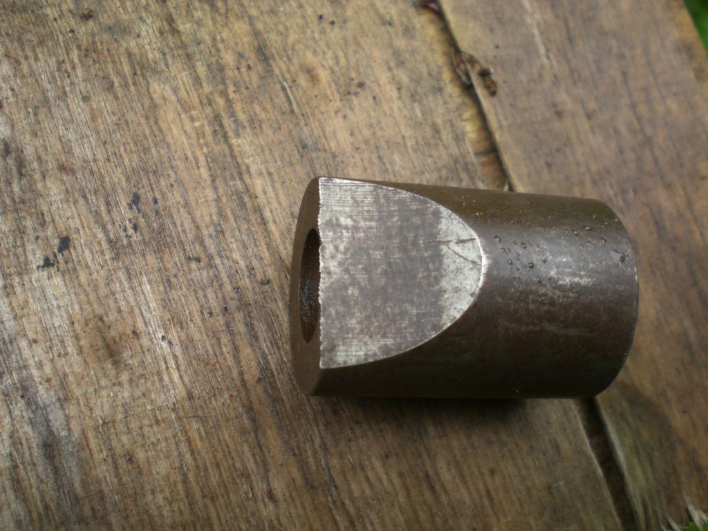

                          Hi, I had a look at the arrangement on the table of an old pillar drill that I have. The pillar is a solid 3 inch diameter steel bar and the steel cotter with the hole for the bolt is 0.996 inches in diameter and 1.4 inches long and I assume the other one is the same, and as it will only come out by removing the table, I didn't measure it. The distance between the pillar and the cotter bolt is 3 / 16 inches, the bolt being half an inch in diameter and the hole for the cotter I removed is 1.004 inches, thus giving an 8 thou clearance between the two. There doesn't appear to be any noticeable wear on the cotters or the hole they are in and the table has no noticeable slop on the pillar, the table being a fairly heavy cast iron one. the distance between the two cotters when they are in contact with the pillar is approximately a quarter of an inch without being clamped up. The photo below bears evidence to Duncan Webster's CAD drawing that the outboard end makes contact first and there doesn't seem to be much hard contact to most of the area.
                          Regards Nick.

                            Thanks for the measurements, and the very informative photos, Nick yes
                            [ in the eternal quest for understanding ] Just one question, if I may :
                            Given the obvious absence of a picture of the second cotter … Is it ‘fully floating’ [as per the Duplex sketch] or is it guided/located in some way ?
                            #551573
                            Nicholas Farr
                              @nicholasfarr14254
                              Hi MichaelG, the second cotter is fully floating, but the hole in the casting on that side is only about 10mm in diameter, I guess this is to allow air to escape for it to move OK.
                              Regards Nick.

                                  Hi, I've had a bit of a senior moment in the measurement between the pillar and the cotter bolt. Instead of it being 3 / 16 inches, it should in fact say 3 thou. Sorry if you were all scratching your heads about a big mistake.
                                  Regards Nick.
