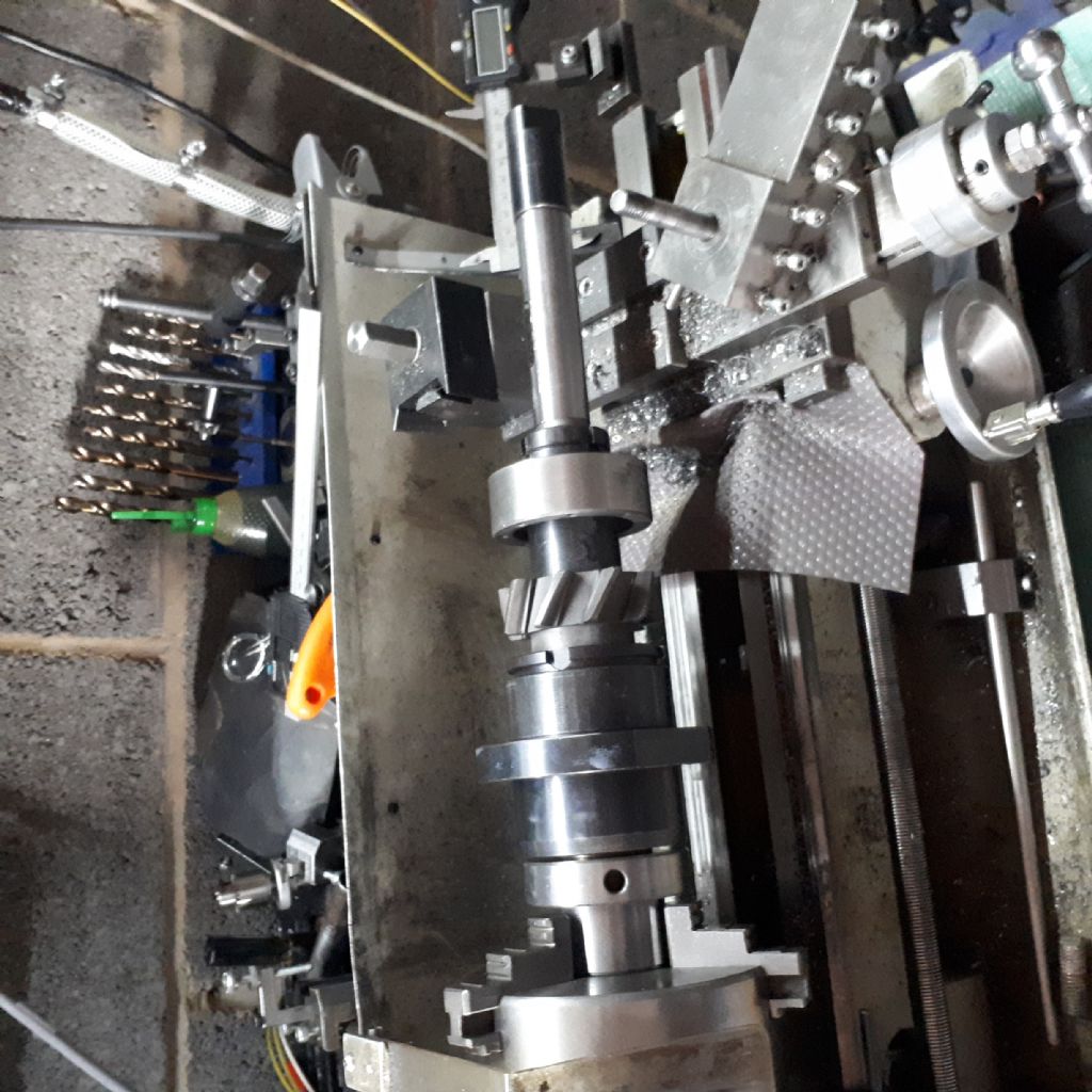

                          The cheapy bearings arrived today. I spoke to Ketan and he gave me some advice on fitting the bearings so will see how it goes. Probably fit them at the weekend.
                          Cheers Michael.
                          #415050
                          Michael Horner
                            @michaelhorner54327
                            I got chance to fit the bearings today. It's not good.
                            Spun up the spindle in the lathe so only the ACB's were spinning, you can hear a noise and feel a vibration.
                            If you let go of the hub the noise and vibration disappear.
                            So it looks like I will have to dig deep and buy a pair of matched bearings.
                            Cheers Michael.
