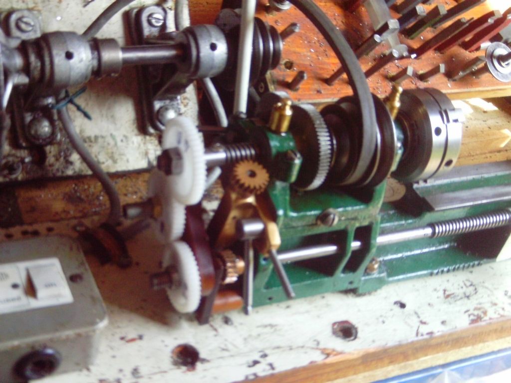

        Hi James, mine came with a 3 step pulley and countershaft, works fine.
        http://www.model-engineer.co.uk/wp-content/uploads/sites/4/images/member_albums/144829/594062.jpg

          John,
          May I ask what size the pulleys are on your set up? I have been looking for some myself, but cannot find anything suitable, unless I am being obtuse.
          If I understand correctly, ideally, the countershaft pulleys should be as close as possible to the size of the headstock pulleys. Assuming that I have measured them correctly (to the base of the pulley groove), my headstock pulleys are 22mm, 35mm and 48mm. The pulleys that I can find are all much larger than this, meaning that I need an enormous (or so it seems) pulley on the other end of the countershaft to slow the machine back down.
          Can any one suggest a supplier of smaller pulleys, or does someone with a lathe fancy earning a few bob making some? If, on the other hand, I have measured the wrong part of the pulley, and they are measured from the outside edge, not the bottom of the groove, I shall start looking again.

                The pulleys on mine came with the machine, they are 2 x 12mm wide V with root diameters of 47mm, 34mm, and 22mm. The lay shaft just runs in a pair of Picador standards.The motor is a 1/3 HP with a 35 dia pulley driving the layshaft with a 135mm dia pulley. I have now rigged the motor on an overhead bracket so the weight of the motor tensions the belt but it's easy to swap speeds. It also prevents the weight of the motor twisting the bed by hanging off the back as per the recomended set up. I believe the drive set came from Flexispeed originally? but Chronos do a range of similar pulleys etc.
                https://dl.dropboxusercontent.com/u/95073912/fm%20pulleys.JPG
