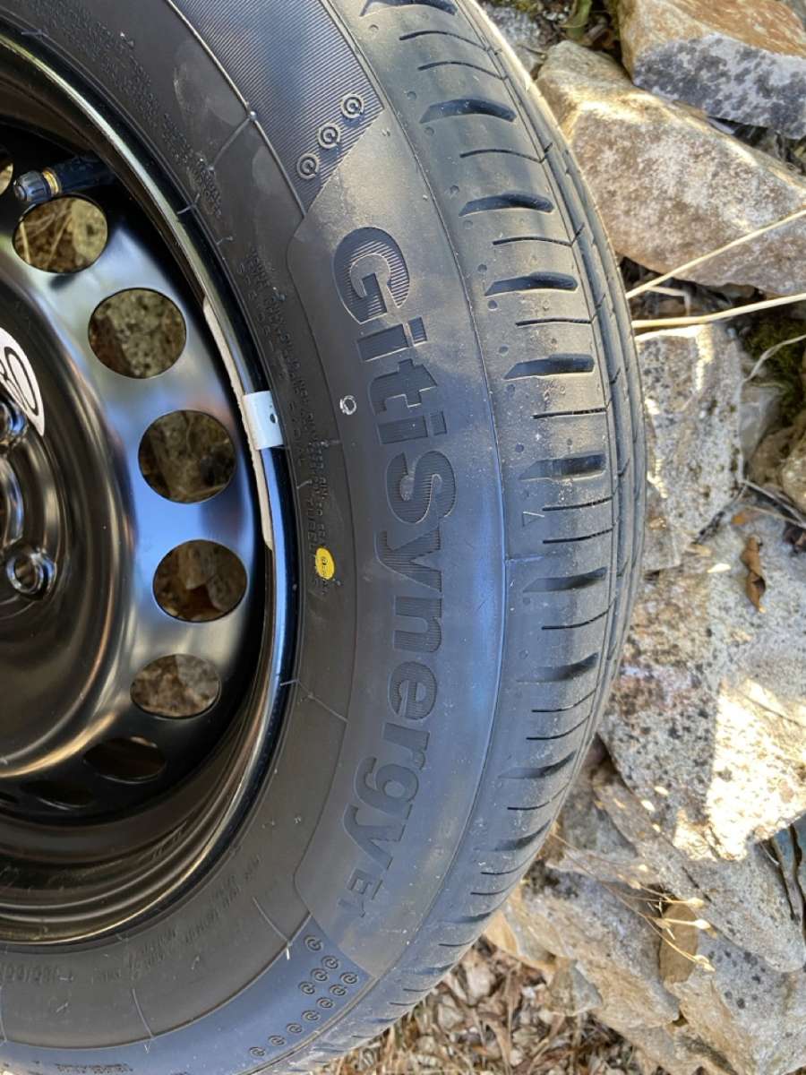

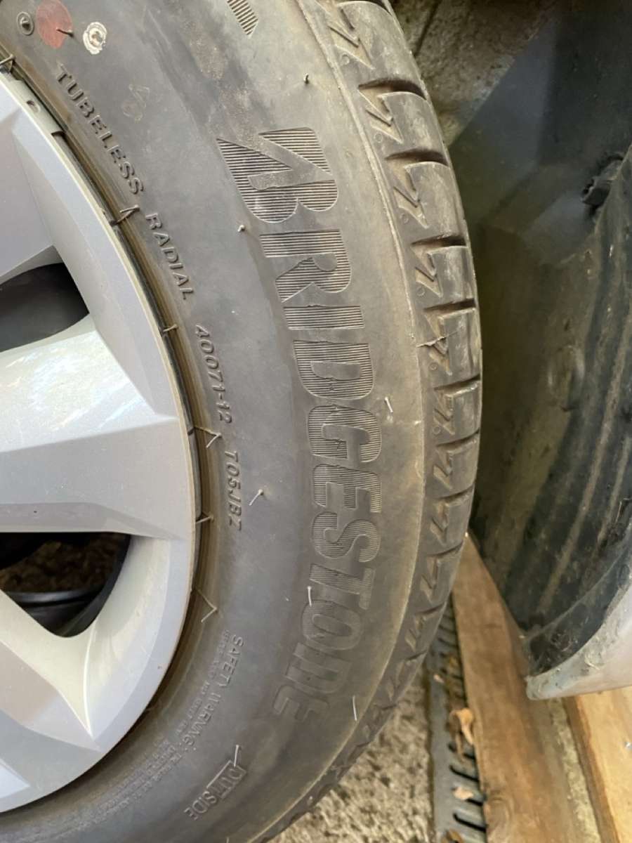

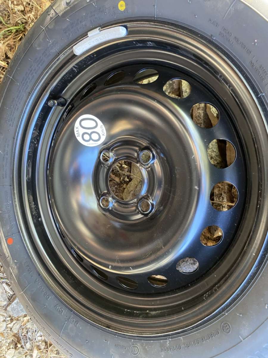

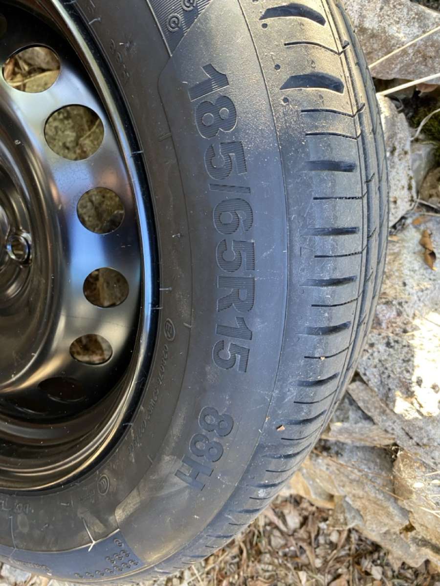

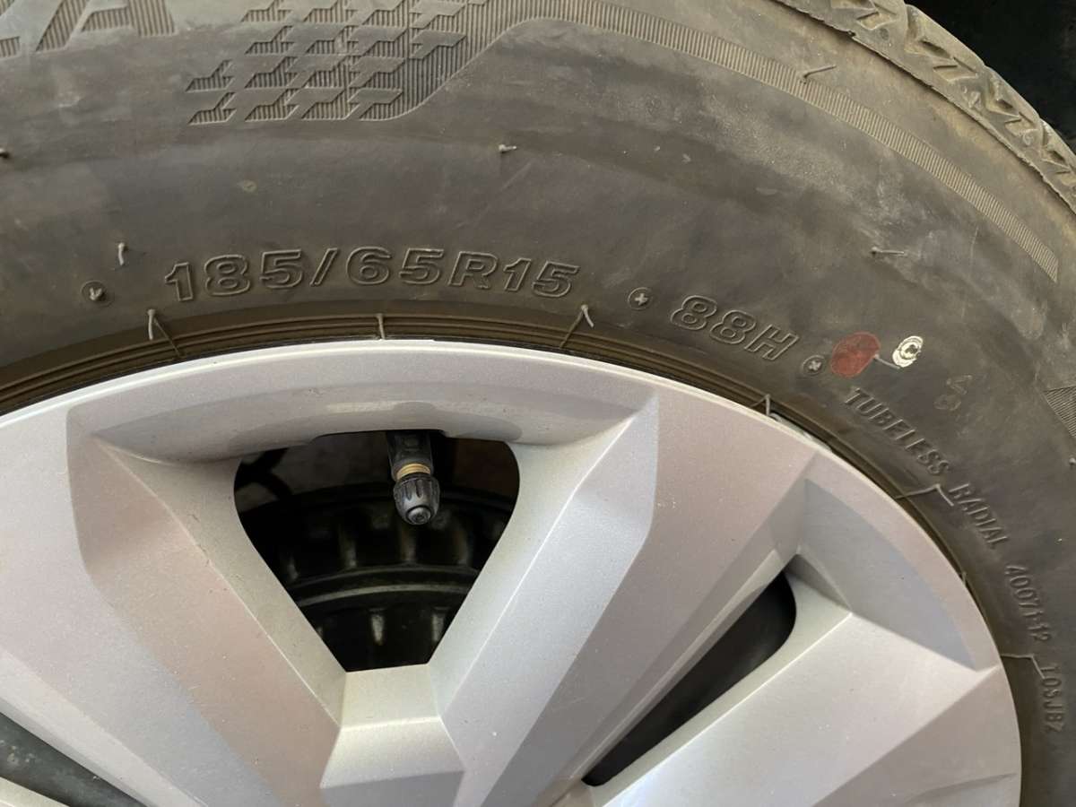

      Can anyone explain this please.  I have a new Dacia Sandero Expression. I ordered a spare wheel with the car. It came with a wheel, jack etc – All good.
      Today a puncture, nail in the tread – fitted spare wheel which has a label 80 Kph Max – OK. But look at the photos, spare wheel tyre is same size and speed rating to the other 4 tyres but different manufacture.
      1/  why a different manufacturer
      2/ why a different hub
      3/ legislation says you can’t mix tyres on same axle.
      Anyone care to comment please?
      SpareWheel 1SpareWheel 2SpareWheel 3SpareWheel 4SpareWheel 5

        Robert Atkinson 2
          @robertatkinson2
          I think the 80kph limit is probably spurious as it is a standard tyre for your car. Probably a standard part for other models or trim levels may have different tyre sizes thus the speep limit would apply to them. Different wheel (steel is to save cost. Mixing type types on one axle refers to construction e.g. radial or cross ply (not very common). Different makes  / tread patterns are not recommended but not a de-facto offence. BUT 27 a.  of the construction and use regulations says “the tyre is unsuitable having regard to the use to which the motor vehicle or trailer is being put or to the types of tyres fitted to its other wheels;” so a court could find a particular combination in breach, probably based on the evidence of a expert witness.
          Not supplying spare wheels as standard saves weight and thus improves reported fuel consumption.

                noel shelley
                  @noelshelley55608
                  You may not be out of the woods ! A steel wheel will often have a different stud or bolt to fit it, ! Noel.

                          Many Porsches don’t have spare wheels because there is no space big enough to put the massive wheel you removed. Early Audi TTs and FWD Beetles suffer this too; they won’t fit through the tiny boot opening so it has to go on the passenger seat.
                          Original Volvo XC90s(the Range Rover equivalent!) have the space-saver spare slung under the boot in a cage. But the actual wheels don’t fit in the cage, so Volvo supply a bag for it so that it doesn’t make the boot dirty. The version with the factory bodykit doesn’t have the cage because the fancy dual exit exhaust runs through that space.
                          BMW Minis don’t have enough length between the back seat and rear of the car for even a suitable space-saver to lie flat. So they don’t have one.
                          Mercedes supply steel spares, but the mating surface is thinner than the stock alloys so you have to use the supplied shorter bolts. Not doing this will damage the hubs and handbrake mechanism if you do it on the back.
                          You’re not legally allowed to fit different size or type tyres across an axle, so space-savers are visibly different, often painted a bright colour and are plastered with stickers that emphasize that they are for temporary use at limited speeds. Whether this is legal is a good question.
                          Many recovery providers won’t recover a flat tyre until the supplied sealant has been used, no matter if the cause is an obvious gash in the sidewall. It makes a lovely mess, and you have to add the cost of another can to getting the car back on the road.
                          Lots of car drivers have trained themselves to ignore warning lights, so drive on runflats until the tyre is shredded. That’s assuming that they paid the extra for runflats when they last replaced the tyres….
                          The root cause of all these problems is the modern insistence on large diameter wheels, even on small cars; it’s not uncommon to find a super-mini on at least 16″ diameter wheels, plus the sidewall height. Ultra-lowprofile tyres on soft alloy wheels with the mounting face close to the outside edge are all easily damaged compared to older designs.

                            Answer to your question: 3/ legislation says you can’t mix tyres on same axle.
                            Different tyres have different tread patterns and steering, braking characteristics. Not so bad on the rear wheels but on the front wheels may cause the car to turn to one side when braking.
                                    the mix refers to cross ply and radials on the same axle.
                                    there are certain makes and models of tyre that the (tyre)manufacturer says must be fitted in pairs.

                                        “the mix refers to cross ply and radials on the same axle”   Where can you buy cross ply tyres now days ? Cross-plies were largely replaced by radials in the 1960s and 1970s,
                                        There are lots of information that states that you should avoid mixing different tyre brands and different tread patterns. There are rare exceptions for approved mixed-tyre fittings, but in general, manufacturers do not recommend tyre mixing at all.

                                        Vic
                                          @vic
                                          I’ve seen a few space savers like this. One of mine was clearly marked with the maximum speed.

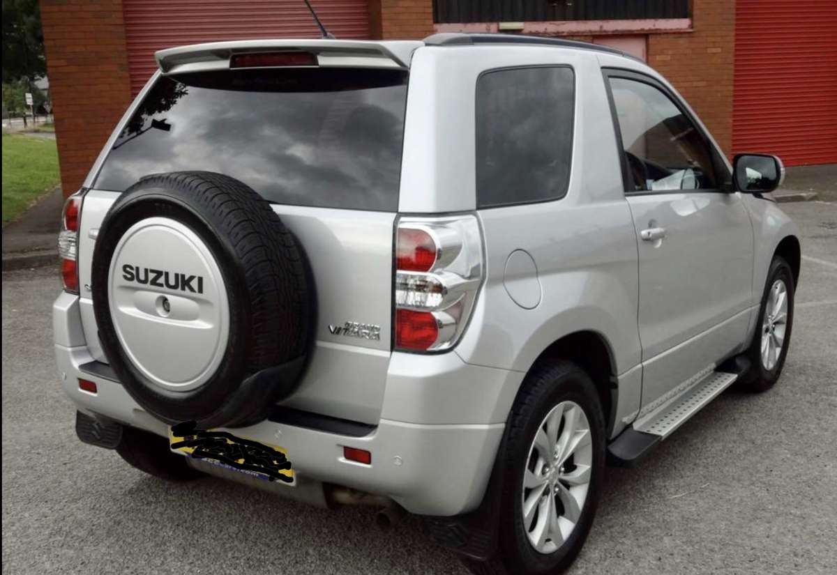

                                            P.S. __ the 2014 ‘Grand Vitara’ that I bought yesterday has its full-size spare mounted on the back door … that was an important part of my purchasing decision.
