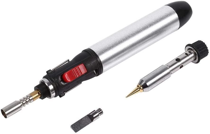

      Has anyone used one of these little gas irons. Ridiculously cheap, but I can't get it to heat the soldering tip.
      Basically, its is a gas torch which lights from another ignition source (match etc).
      For the soldering iron (Or hot knife for plastic), you screw an attachment over the flame attachment and light the gas which exits just before the screwed in iron tip. The gas ignites, but the heat dos not travel down to the soldering tip.
      It looks like there is an incandescent "wick" inside the attachment, but it doesn't want to "Ignite"
      Any tips on how to use it ??

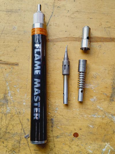

            Mine is not the same model but the various 'ends' are fitted separately:-
            Torch on left next is the soldering head with bit then torch and the bit at the top slides onto the torch and makes a mini hot air gun.

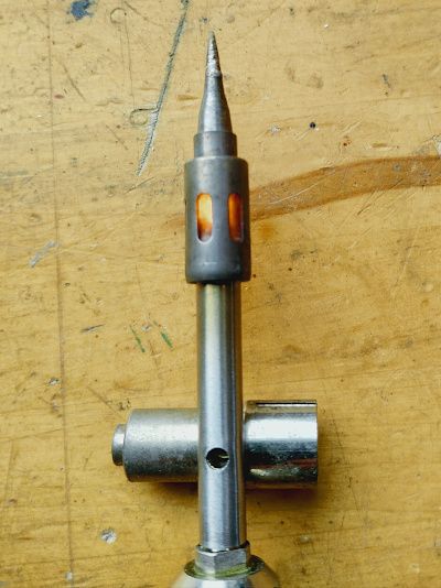

            When lit the soldering iron looks like this. Looking at yours I am guessing that the 'corrugated' bit of the nozzle comes either unscrews or pulls off before the soldering attachment is screwed onto the black collar
            Hope that helps a bit.

              I have a Amtech 20556 model. The soldering tip is unscrewed to use the "blowlamp". When the tip is screwed on the whole blowlamp/tip assembly is pushed forward against a spring by thumb pressure. A flame is then used to light the burner through a hole in the side. The assembly is them released backwards slowly to get the flame into the correct place to heat the tip. If moved too quickly the flame will go out. So I find leaving the tip assembly in the forward position for a minute for the flame to stabilize and preheat slightly does the trick. Excellent little soldering iron that I find very usefull.
