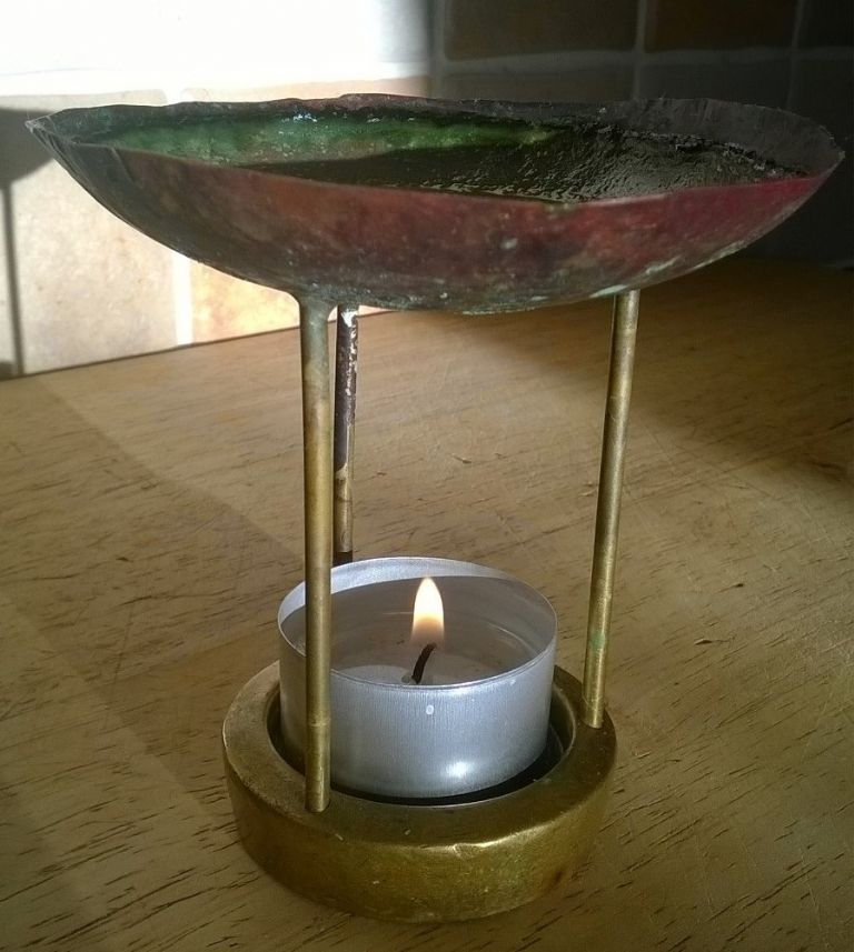

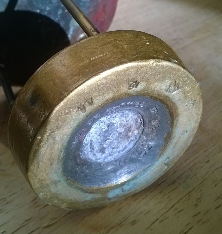

            Here's something I made a while back:
            It's an oil burner made from an old brass weight. I bored for the three columns on a PCD, then bored the dished copper top to the same PCD. It fitted ok after a bit of tweaking.
            In the first picture you can see the calibration stamps on the underside, they start at 1943 and the last one is 1951.

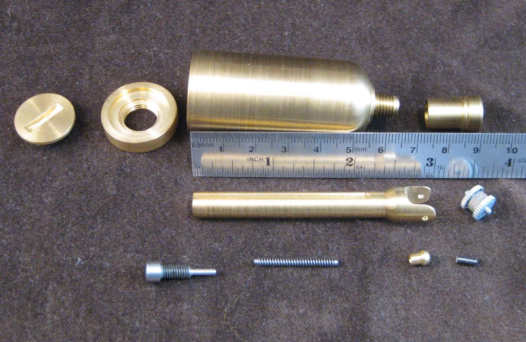

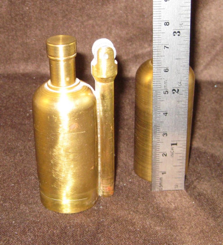

              That was very nice Hollowpoint, I was inspired by the article in ME 1998 and made a lighter in the form of an "Absolut Vodka" bottle, straight form easy to model. But I concentrated on the design and did not think about the function, the distance from spark to wick is toooo long so I have to use a match to light the lightersad. luckily I do not smoke so it is just a discussion piece at the coffe table.
