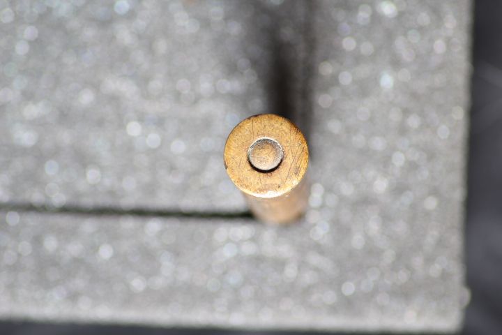

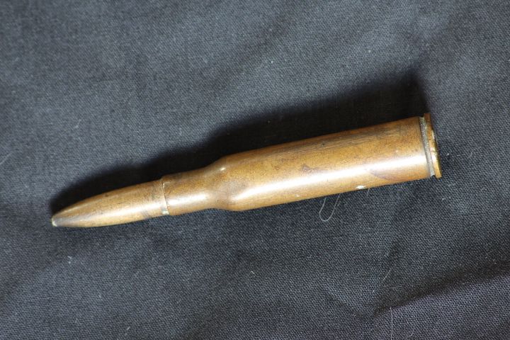

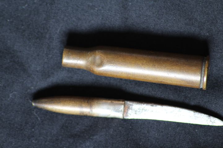

                                      img_5035.jpgOn the subject of trench art can anyone identify the cartridge this penknife is made from? It was given to my grandmother by her brother who was killed in France in 1918. I expected it to be a British .303 but the dimensions are all wrong. Nor is it the standard German calibre. A friend who knows a bit about guns thought it might be Italian except that their bullets were rounded rather than sharp tipped. And I can't think where my relative would have got hold of Italian ammunition during WW1.
                                      Dimensions are approximate!
                                      Thanks in anticipation,

                                        6.5 x 50 arisaka bullet looks close. Japanese.
                                        #224293
                                        Lars-G Kjellander
                                          @lars-gkjellander17135
                                          I have 2 knives just like that, bought some 40-45 years ago. The cartridge are marked "METALLVERKEN" a Swedish company, and the blades are stamped "MORA" a famous knife maker, (at least in Sweden), and they have been fired, at least they have an indentation in the back. They are 12mm diam and 55mm long + 6,5mm bullet.
                                          #224330
                                            Thanks Lars_G and Hollowpoint. Much to my surprise given the Japanese origin I think Hollowpoint has nailed it!
                                            Wikipedia says that the British bought 150,000 Arisaka rifles in 1914 and used them mostly for training. "The 6.5×50mm round was subsequently produced in Britain by the Kynoch company and was officially adopted for British service as the .256-inch (6.5 mm) caliber Mk II in 1917."
                                            I think this example of Trench Art probably came from a Training Camp. I now doubt it was made in the front-line as I'd previously believed.
                                            The item works well as a pen-knife and although easy to make must have been a desirable novelty. I wonder if the Swedish examples were manufactured by Mora and how many other nationalities have produced them?
