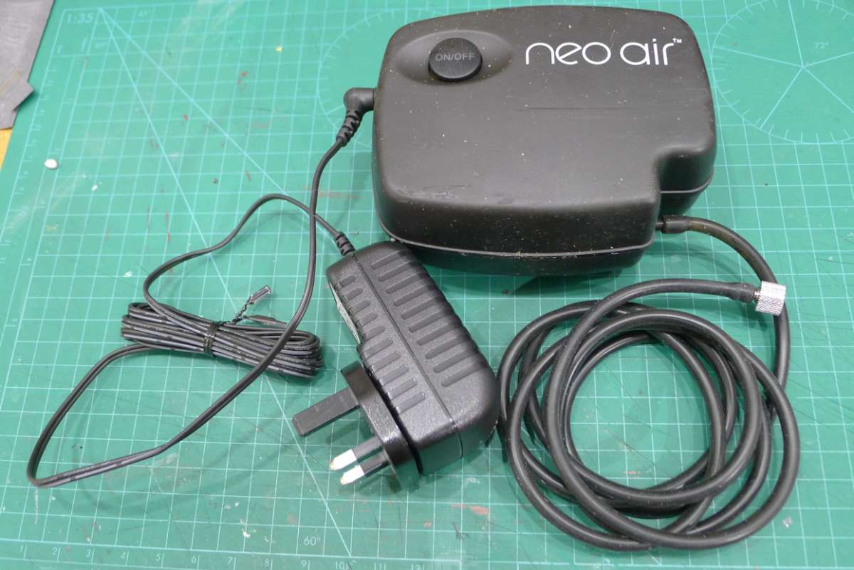

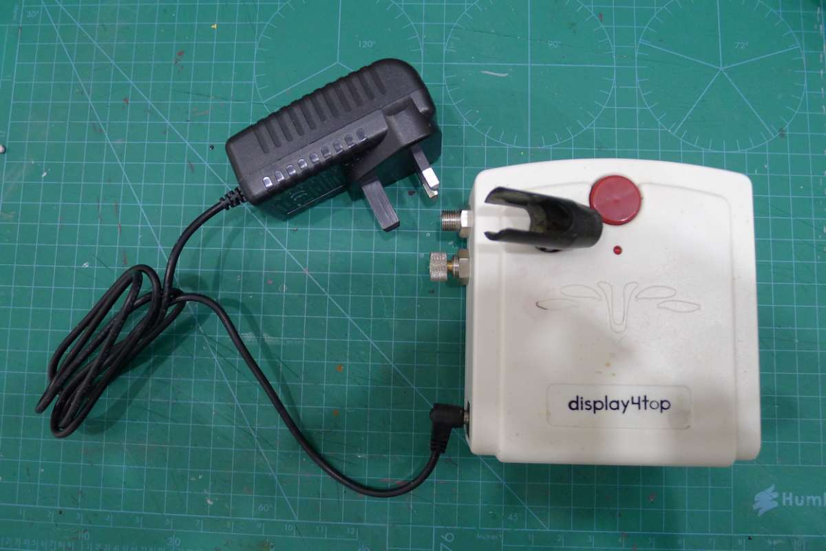

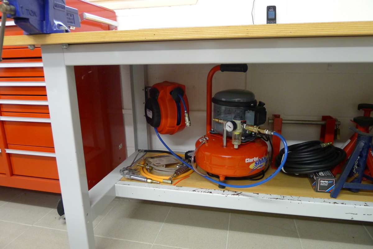

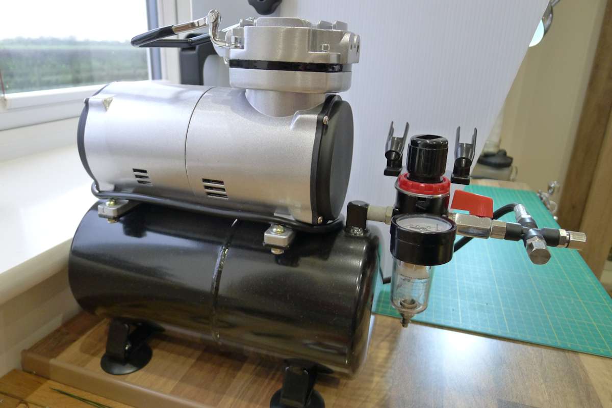

                                                    One thing to bear in mind with many compressors, especially airbrush type compressors is their duty rating.  Some can only be run for a maximum of maybe ten minutes before they have to be left to cool down again.  This is fine for airbrush work where the use is intermittent and buffered by a reservoir but should be noted if longer use is needed.
                                                    Many airbrush type compressors can be bought as an all-in-one kit with reducer, drier and airbrush but the airbrush is only fit for the bin.  The compressors are fine for running a model engine but not for long.  Many use exactly the same valve head as this one in multiples and possibly with a bigger tank.
                                                    07-12-18-09AirBrushCompressor1
                                                    The reason I mentioned the Clarke Shhh! earlier is because the original poster mentioned the fact that he would like one for workshop use but didn’t have the space.  The Shhh! does give you that flexibility for light workshop duties and its footprint is not much more than an airbrush compressor.  The great advantage is that it is extremely quiet because it basically uses a completely sealed refrigeration compressor.  You hardly know it is running.
                                                    02-12-23-07Shhh!Compressor9
                                                    For very light use there is a whole range of beauty use compressors for nail bars and tanning salons, all of which are low capacity but vastly varying in quality.
                                                    25-11-23-03MiniAirBrushCompressor3
                                                    There are also the small compact units such as the Iwata Neo, again for limited use airbrush operation but man enough to drive a small engine.  These can get more expensive but they do have a couple of pressure settings:
                                                    25-11-23-05NeoAirAirBrushCompressor2
                                                    Again though, not rated for continuous use.
