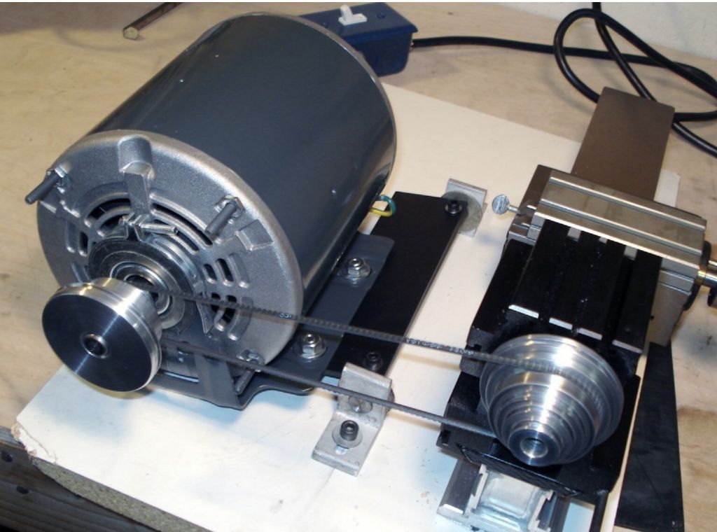

      I have a small lathe which is powered by a 1400 rpm electric motor and, using a belt between two sets of pulleys can vary the speed between between 435 rpm and 4415 rpm in six steps.
      A more expert chap has suggested that I need to machine Aluminium at slower speeds.
      I know nothing about electricity – connecting a plug to the end of a cable is the limit.of my expertise.
      Is there a "Plug & Play" solution? Can one purchase a ready made unit into which I can plug the lathe which has a dial (preferably calibrated) to vary the speed?

                A pic of your lathe and it's setup?
                Having 6 speed steps suggests you have a countershaft setup. I wonder if all you need is a different pulley combination driving it.

                  It's a Taig Lathe (marketed as Peatol in the United Kingdom)
                  I attempted to Paste an image with a table of the speeds and a sketch of the set-up but the site tells me my message is too large!
                  I don't know how to include a photograph in a message but a similar arrangement is shown on http://cartertools.blogspot.com/2012/03/10-minute-taig-motor-mount.html

                    If only it were! It's clearly a 4 pole single phase induction motor. Probably overkill to convert to 3 phase with vfd if this would be the only job needing the low speed. As Pete mentioned a smaller or larger pulley somewhere in the drive might be the best approach.

                      On looking again at the photos in the link, I see that the 6 speeds are all on one set of pulleys so the simplest solution would be to add a countershaft. I will send you a personal message.
                        I have taken the liberty of grabbing that image [duly credited] for the convenience of those following this thread:

                            Looking Taig's website, their step pulley sets are less expensive than I imagined. If these are available from Peatol, reversing one of your existing pulleys and inserting a new one on an overhung countershaft seems the simplest answer, as machining new pulleys on the lathe would run straight into the original problem.
                            A Google search for "Taig Countershaft" brings up a few designs. (Assuming that your current setup looks like this picture on the Taig website).

                                                      With regard to slowing the motor, if it is an induction type (Rather than a brushed or brushless DC type  &nbsp the answer is NO. Induction motor speeds are determined by the supply frequency and the number of poles.
                                                      If your motor runs at 1470 rpm, it sounds like a 4 pole induction motor, so your speed reduction has to me mechanical.
                                                      the obvious way is to either fit a smaller diameter pulley to the motor, or a change one on to the countershaft.
                                                      Once you have decided what is the lowest speed required for the lathe mandrel, you will know the overall reduction ratio between the motor and the Mandrel.
                                                      The arithmetic is simple.
                                                      Say, you want a minimum Mandrel speed of 250 rpm instead of the present 435 rpm.
                                                      So the overall reduction ratio is 1470 / 250 = 5.88:1 ASSUMING that the motor pulley is 2" diameter, driving a 4" pulley on the countershaft, the countershaft will revolve at 735 rpm. so the ratio between the countershaft and the Mandrel has to be 2.94:1 In which case with a 5" pulley on the Mandrel, you would need a 1.75" diameter pulley on the countershaft.
                                                      These will not be the sizes for your lathe, but shows the principle involved.
                                                      You measure the existing pulleys, and decide which would be the easiest one to obtain / make, taking into account availability of belts, and range of adjustment available.
                                                      Basically, the simple you either reduce the size of one of the driving pulleys, or increase the size of the driven pulley until you get to about the size of ratio that you require.
                                                      Bear in mind that you may have problems (belt wear / eventual breakage and range of adjustment ) if the driving pulley is too small,
                                                      The other side of the coin may be that your "wished for" driven pulley might be too large to fit inside the guards, or fouls on something.
                                                      So you might have to reiterate your choices and calculations until you reach dimensions that are practicable.
