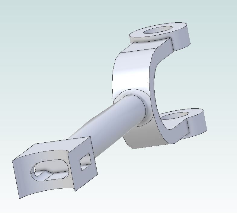

            On other engines of Anthony's and others I've drilled the ends of the slots 1.4mm and then done a series of plunge cuts from either side with a 1/16" milling cutter with about a 10thou step over. To square up the ends I have a Warding shaped needle file that I gave ground the faces flat on so just the edge cuts. ARC do a similar file but being parallel edged it won't fit a 3/16" long slot.

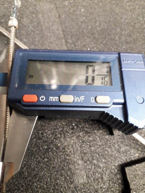

                    Is this one of the mythical 1/16" slotting blades or something else?
                    Bought an old dusty blister pack of three a few years back from a small local DIY shop thinking they were serrated all sides but found there was just the one toothed edge, no description on the packet, 10" long with looped ferrule ends/hacksaw type fitting so didn't think they were woodwork ones. Dunno how good they are on metal as I broke my 10" hacksaw frame shortly after getting them and not bothered to replace. You are welcome to try one Henry PM me your details and I'll post you one.

                      The depth of that blade would seem to suggest it is not what was referred to as you could not pass that through a 1/16" hole to then join the hole at the opposite end. Whatever they are like they would need plain ends so they could fit into a piercing saw clamp type frame and possibly be round more like a small dia Abrafile blade
                      Edit. I'll take that back having just looked at the build article. He says the holes can be joined using a needle file and THEN a slotting saw so it could have more depth to the blade.

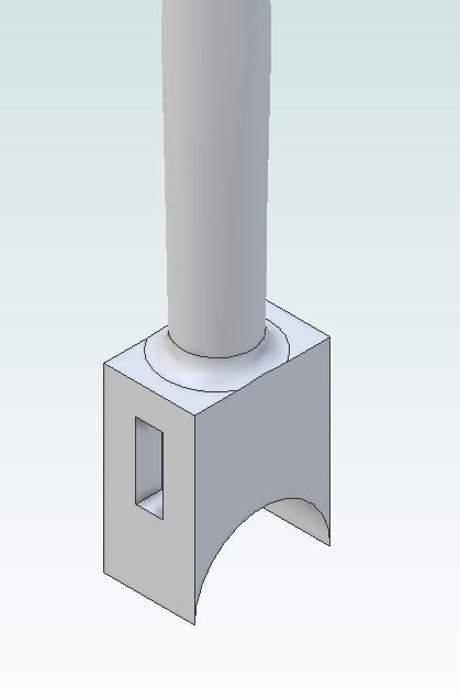

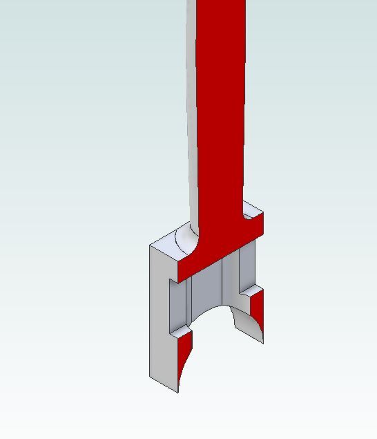

                        One trick that can be used if you don't want to or can't plunge deep enough to form the slot is to stand the conrod on end and mill a pocket out of the middle, that way you only have to plunge and subsequently file thinner material. This is from my 2/3rd scale Tidman where the slot is 3/4" face to face

                        Henry Gillett
                          @henrygillett86476
                          Now that is goddam clever!
