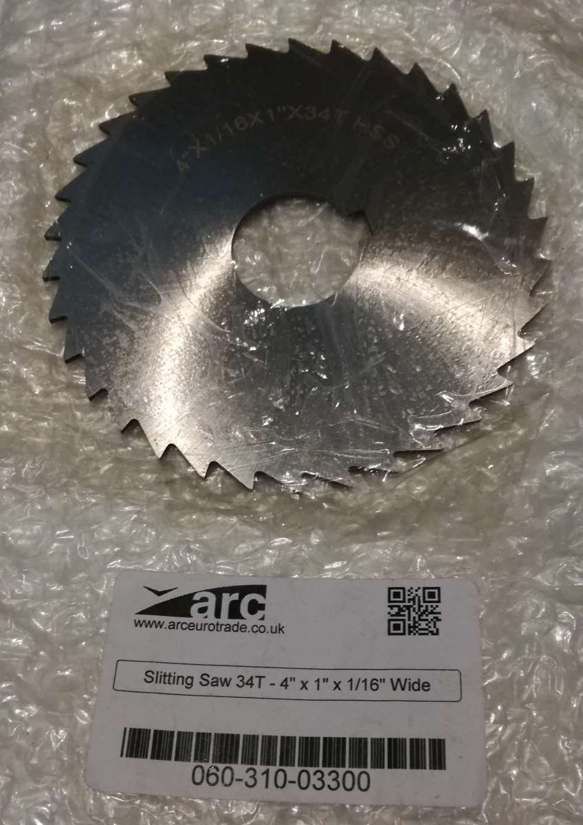

                            Hi, well out of curiosity, I checked my arbore for runout, and it has in one spot, 0.00025″/ 0.00635mm high, which I’m not going to worried about. I mounted an Arc 42 x 1/16″ x 34T slitting saw, which has never been out of the thin poly bag, let alone never been used, and has no shake at all on the arbore, and I then checked the teeth in the same way as JasonB has shown, after getting my dial gauge to 0 onto one of the teeth, and then turning the spindle slowly by hand, I got a variation  of some of the teeth not quite making the needle reaching back to the 0 position, while others moved it to almost 0.0015″ / 0.0381mm past the 0 position, some of these readings were in-between each other, while some came in pairs, but at least two teeth, not even close to each other. only just moved the the needle, I rotated it at least three full turns, and the readings were very much the same each time. I have no problem with these results either, and I’m very confident that it will cut okay when it gets used.
                            slitting saw
                            Regards Nick.
                                              slitting saw
                                              Regards Nick.
                                              Good evening Nick,
                                              I was intrigued by your findings, and those of Jason, considering the cost of the ARC slitting saws.  This prompted me to look at a couple of unused ARC ones that I have (not the size I wanted unfortunately).  While they appear to have milled teeth, they also have what I will call a small “top rake” ground onto them, which I assume also has the effect of correcting any runout from the previous machining operation with minimal wear to the grinding wheel.  Clearly, buying low cost tooling can work.  I guess I was just  unlucky with the RDG offerings.  With all due respect to them, I have had a refund, and still have the two dodgy slitting saws.
                                            Viewing 21 posts - 51 through 71 (of 71 total)
