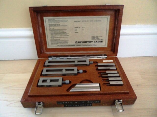

                    #441599
                    jimmy b
                      @jimmyb
                      I've ended up with a metric and imperial set.
                      A slip gauge accessory set is very worthwhile addition, as it turns the slips into an extremely versatile measuring tool.
                      Well worthwhile investing.

                      #441600
                      Glyn Davies
                        @glyndavies49417
                        I found limited use for slip gauges until I came across an accessory set at a car boot similar to this one that is on ebay:
                        I now use them a lot – it's so easy to make up various configurations of go-nogo gauges for jobs where it's difficult to get a mic or caliper into.

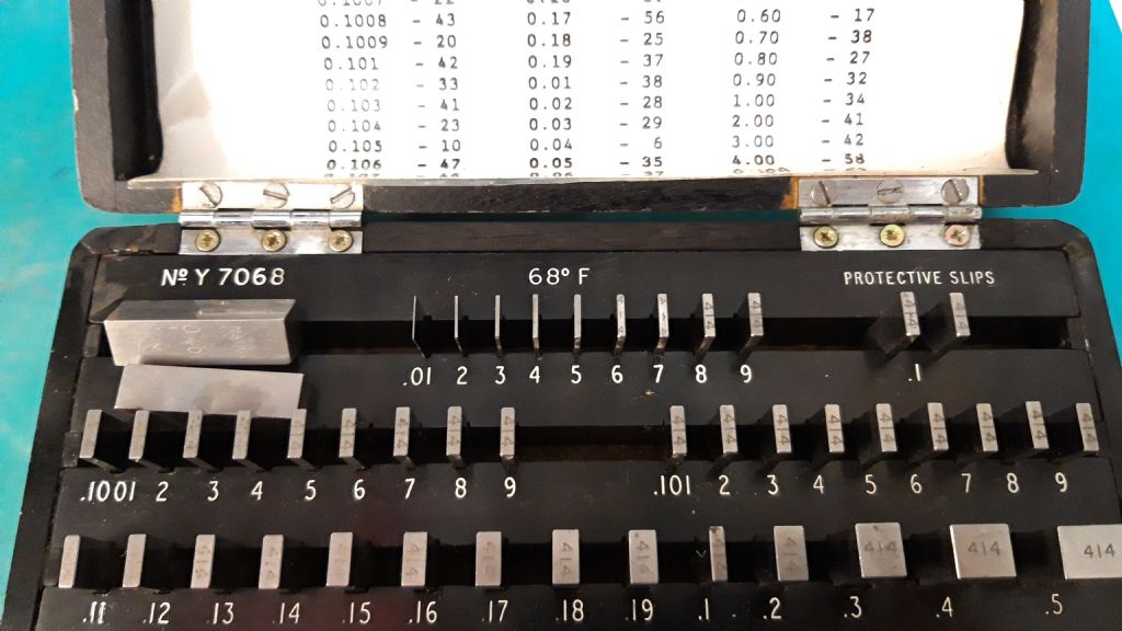

                              #441611
                              Ian Johnson 1
                                @ianjohnson1
                                I bought an old imperial set from a stall at the model engineering show for £30. I didn't need a set of slip gauges, it was a present to my self. I have used them for checking the tee slot gaps and key way slots, and they are regularly used to check my micrometers. They are the most accurate thing in my workshop, much more accurate than I will ever be!
                                Top tip! If buying second hand check for matching serial numbers, on mine they are all 414.
                                Ian
