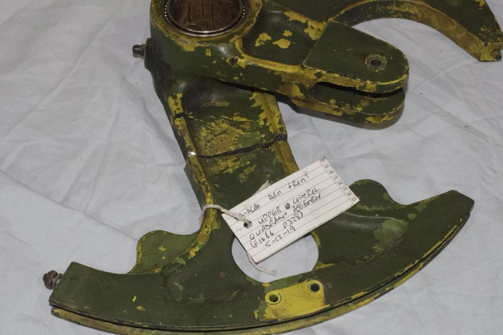

      _igp2521.jpg_igp2520.jpg_igp2519.jpg_igp2518.jpgThe team restoring the Piasecki H21 have given me a piece of the mechanism connected to the front rotor head. It looks like a casting, judging from the granular surface of the break. It will probably have to have a section grafted in as the parts bent before breaking. The width of the H section is about 3".

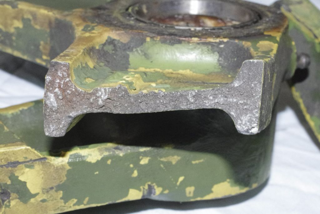

          I would use oxy-acy using cast iron rod and ferro flux. Normalize after weldinf.

              If iron, without a specialist muffle to do a pre-weld preheat and (more importantly) post-weld normalise I wouldn't even think about welding. Brazing would be far safer thus minimising the likelihood of producing brittle carbides each side of the weld.
              Ali is a completely different ball o' wax.

                Is this for a static restoration? The original parts are almost certainly forgings. Weight and strength are critical on aircraft especially helicoptors. If this is even a ground running restoration you need to be very careful how they are repaired.

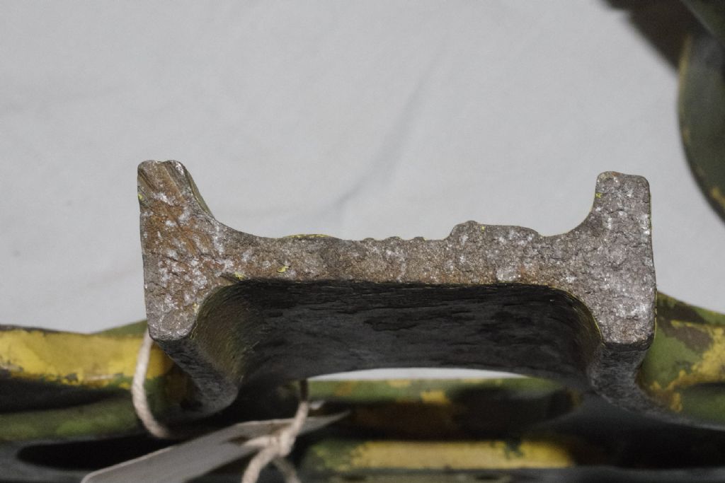

                  Not my specialist area at all … but … that looks like it might be a magnesium component which had aged badly.
                  The crystalline structure changes with age, and stress-corrosion cracks are commonplace.
                  May I suggest that you check the density of the material before proceeding.
                  In case you had forgotten: Archimedes is you friend

                    Sorry, I had to re write the whole lot when the photo's wouldn't work. The original mentioned aluminium, and I missed it out afterwards. I'm pretty sure it is a casting, so the manufacturers must have overengineered it for whatever function it performed. The cables attached are at least 3/8" diameter. Some of the related parts are indeed steel forgings. The entire aircraft is a wreck, there is no danger of any part ever being in working condition.

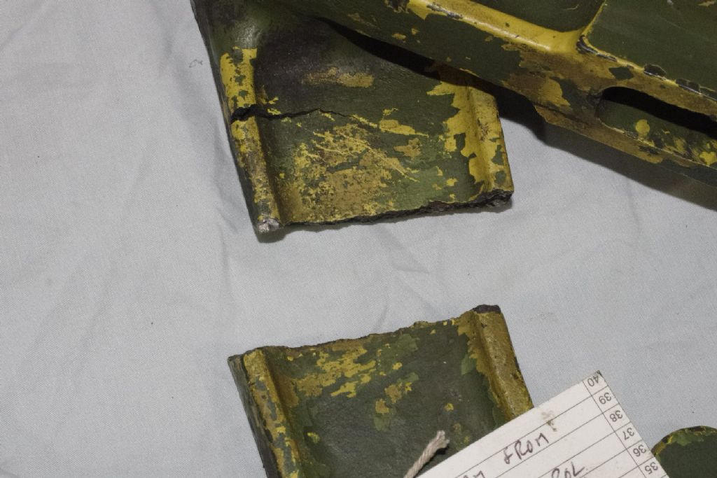

                          Hi old mart, if it was mine, I would get as much paint off the surrounding areas to be welded, preferably by bead blasting. Then I would heat the bent section up a bit and straighten it out the best I could (you may need to cut a little of the metal away each side of the break, to allow it to close up) and then bevel each side of the mid section. Then clamp a piece of thickish flat steel bar along the mid section each side and using a TIG welder, tack it together on the outside sections, then remove the clamps and steel sections and proceed to weld the mid section. I would then cut a "V" bevel almost all the way through the outside sections including the partially broken bit and then weld them up. Once welded and cooled, dress it down with a flap disc.
                          It would of course be best to try and identify the actual composition of the material for the best filler rods to use, but any good welding outlet supplier should be able to advise you on the most suitable filler rods, other wise.

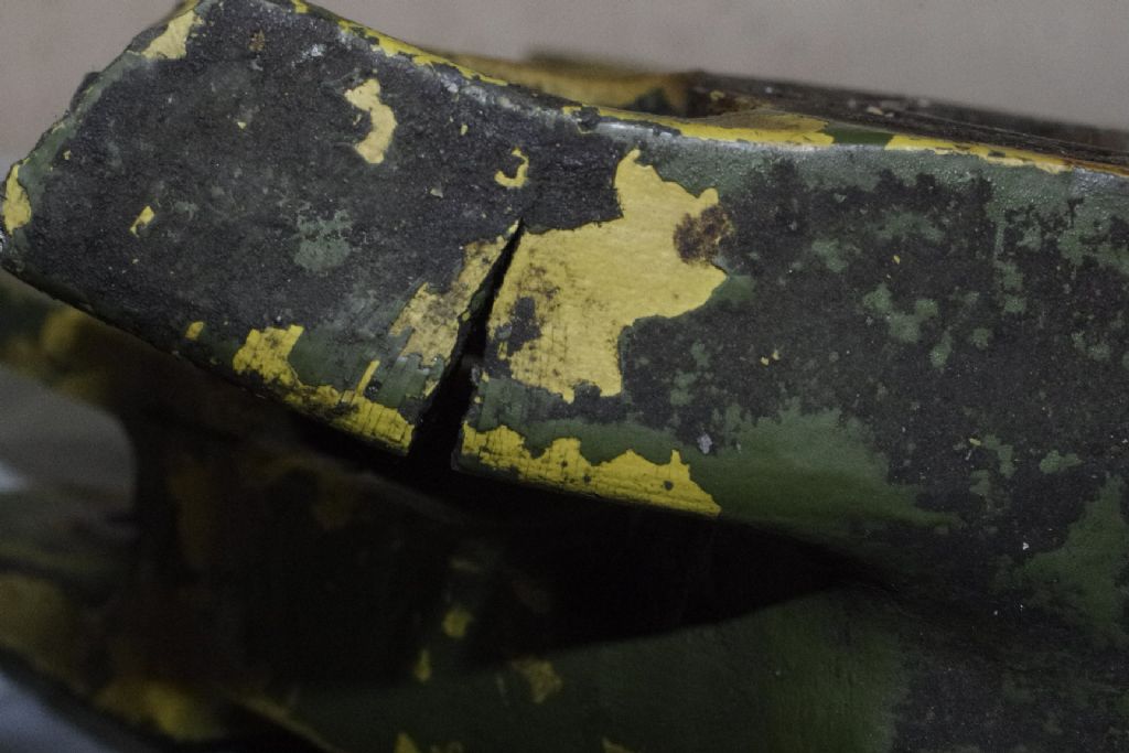

                            Maybe I don't know nuffin', but I really can't imagine how any repair of a critical component in that condition could ever pass any sort of airworthiness inspection if there were actual live people gonna be depending on it to carry on living.
                            I'd say the only way forward would be to make or obtain drawings of the part to its correct dimensions and make new out of properly warranted and released material.

                                I don't think it is magnesium, but a small sample will get tested just in case. Any repairs are limited as we do not have any welding facilities and the budget is, as normal, zero.

                                    Why bother to weld or braze it at all. Just knock as straight as possible and cut a couple of shaped plates to fit each side and bolt it together. Use countersunk bolts on the visible side. A bit of filler and paint and it will do the job of sitting there & looking useful. If the dimensions are not perfect but within 1/8" or so it will get the job done for next to nothing.

                                      Oldirons suggestion is a good one. It will be quick and cheap and will let anyone know in the future that the part is unserviceable.

                                        If it's alli then the low temp "welding" alloys will work well on a job like this. READ the instructions VERY carefully and if you can weld FORGET all you know. BUT take a small shaving and test by burning that it's NOT magnesium first. Good luck. Noel

                                          Old Iron's suggestion of a couple of reinforcing plates with screws through to cobble it together for display purposes is about your only option. Sounds like it should work for your purposes.
                                          Bit of epoxy between the plates and the part might stop any slopping around if the screws work loose during display manoeuvres etc.
