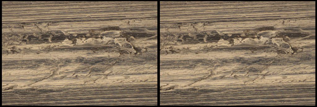

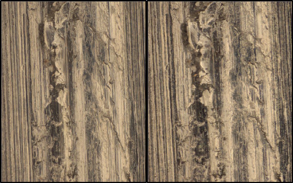

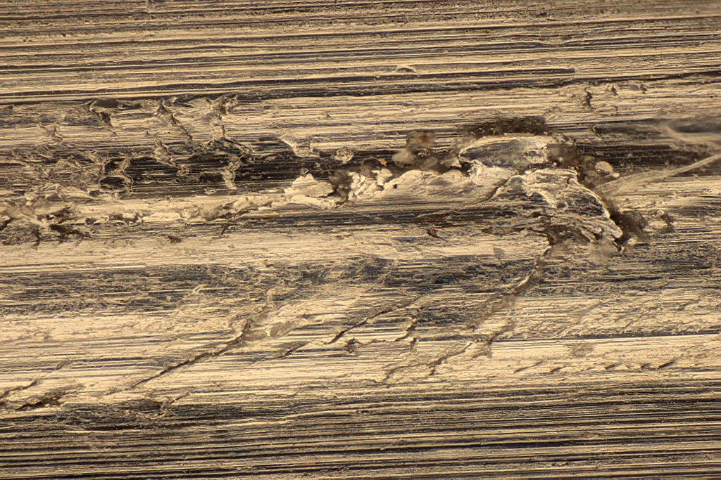

          I had another clean- there were some traces of dried grease left which I thought were out of the way – they may have been doing a little. I gave it a hard rub with a dry cloth which appeared to polish the Al.
          There are the two carriages running on the dovetail. One is tight, the other is tighter. The tighter one started to bind again. I could just about see smething so I took a picture of it:
          Ignore the colour, it's "grey". The colour balance is off, but I found when I made it grey the relief didn't show up as well.
          Frame width is about 1mm. Focus depth is about 60µm. How galling, eh?
          If you can cross your eyes a bit, try these:
          ( you have to make it so you can "see" three boxes, with the middle one being one from each eye.)
          I expect most WON't see those as 3D – it's not hard but it takes practice:
          If you download this (~4MB) it should help
          **LINK**
          Edited By Chris R 1 on 06/02/2019 01:15:46

            Vey effective 3D images, Chris yes
            May I suggest you proceed [carefully], as discussed in our exchange of PMs

              I clearly have to get rid of the raised metal!
              There's then a question of what grease to use. It's clearly not a critical application, but I'm wondering whether to get something with "anti-seize" properties.
              I need also to look at the metal items to see if there's alumin(i)um deposited on the brass/bronze. as that will have to go too.
              The type of microscope objective which macro photographers use, has a long working distance. Therefore they can be used as hand lenses. The one I used above (20x) has a field of view of a couple of mm, but 20mm working distance, so it's quite good for inspecting things.
              Even the 100x is available (2mm focal length) with a 13mm working distance.

                      Well, I know it was me that said don't start cutting metal YET, but I think the time has come, it's pretty clear that the slides are not as original, and the way forward is to subdue some of those mountainous looking peaks.
                      I'm going to raise a fire storm by saying that I think the dangers associated with embedding particles of grit/abrasive are overstated. Whether they are or no it doesn't seem you have any alternative. Go for it, particularly now you have it all in bits and can clean it afterwards. I feel you want something more aggressive than 3000 grit, though that may be a knee jerk reaction to an awful lot of magnification. If it was me I'd glue a bit of 800 grit wet or dry silicon carbide paper to a lollipop stick of the right shape and try scuffing over the rough bit, though rather gingerly to start with. Use it wet to keep it cutting cleanly, say paraffin or something like that though water will do. Once you've got the worst of the damaged surface under control polish it with say 1200 or 1500 grit. It's a sliding surface so it doesn't have to be mirror finish and a bit of surface scoring will carry the lubricant better.
                      I also feel that once it is re-assembled almost any lubricant will suffice – it's only got to slide so a bit of best lithium axle grease is as good as any.
