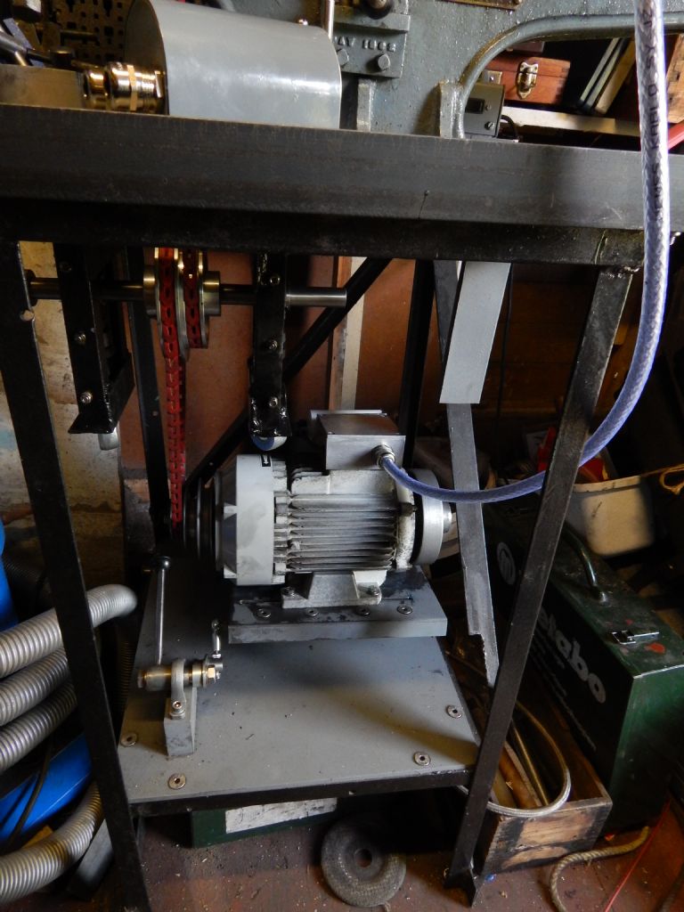

              I have mounted up the new electric equiped kitty motor onto the lathe to check it all fits . I have left wnough cable to aloow me to site the switch anywhere . However probably think it will go on front .
              latest  lathe electrics

                        Having sorted out the earthing problem. I have one direction travel on the forward control but no reverse this turns of motor when leaver is in reverse. I presume this is another wiring issue as it was a reversable motor on old switch , one of electrical  people here solved that for me.

                            Well my motor is fubar .Its a complete waste of money and none of this tech works . Have brought 3 phase kit and inverter none that worked and was electrifying tried to electricute me rubbish company wuld not put it right .
                            I brought this kitty motor worked fine and just wanted to relocate switch wired it up as it made sense worked fine for 5 mins before I connected it up on the bench in reverse and foward . I put it in lathe and it ran another 5 mins it started smoking then shorted out power righ through to the house. . Just believe its an utter waste of time and none of this works.
                            fubar motor

                              I think that motor is beyond economic repair. When you get a new motor wait until someone tells you how to connect it up to the reversing switch rather than just trying to connect it just using your intuition. It looks like the centrifugal switch did not disconnect the start winding when the motor was up to speed. As it worked in one direction you must have wired it up to the reversing switch incorrectly.
