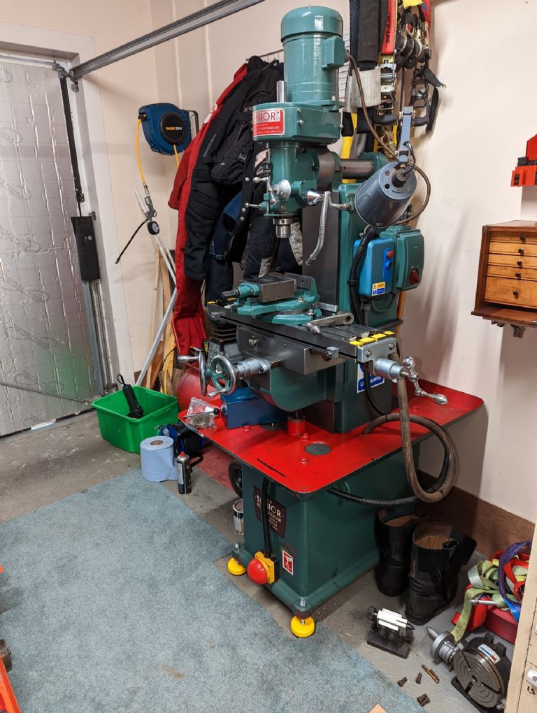

      Hi folks.
      So I'm an old tools kinda guy… I have a wonderful 1941 Logan 700 lathe and a beautiful 1975 Sherry & son compressor. I'd really like to maintain this theme with my choice of milling machine, but struggling to find anything in 1ph. Is newer tech the only way? I'm guessing it's owing to the higher speeds involved with milling?
      I just find the older tech so much more rigid and easy to maintain.
      I have got my eye on a Warco WM250 that's had full CNC modification, should I just set my course that way and give up a fools errand in this instance?
      Any thoughts and advice greatly appreciated!

          I suppose you vould try a Centec 2B if one came up. Mine was certainly a single phase machine.
          Could I make 2 other observations:
          I eventually bought a 3 phase mill – a viceroy universal mill. Its a brilliant thing. Built like a tank. Originally I built a rotary phase converter with an old transformer, a motor and some capacitors to run it. This was as much easier than I had expected.
          Nowadays I run it from a VMC. Just brilliant and so easy.
          I also got a CNC mill eventually. I really wouldnt be without it now. Making a valve gear for my 3.1/2 gauge schools loco was so easy!
          So my humble advice – give CNC and 3 ph a try. They have revolutionised my workshop.

            What is wrong with 3 phase? Better than single phase any day.
            Just be careful with two speed motors and some contactors, but a single speed motor with a VFD can provide several refinements with the available programming possibilities.
            Nearly all my machines are over 50 years old and all the main ones are (now) running with 3 phase motors.

                    Wanting a single phase motor is an odd priority for choosing a machine tool. Is it because 'old ways are best'? If so, it doesn't apply to single-phase motors!
                    Getting an electric motor to run on single-phase AC is quite difficult, and the way it's done is always a compromise. The advantage is a motor that runs off ordinary domestic electricity, but they come with many disadvantages: unreliable due to capacitors, centrifugal switches, and delicate start windings, relatively inefficient, they vibrate, and don't like being continually stopped and restarted. In short, a poor choice for a machine tool, unless the workshop only had single-phase power.
                    DC and 3-phase motors both outperform single-phase types but back in the day, it was expensive to convert single-phase power into DC or 3-phase. Today's electronics can do either at reasonable cost and it's unusual to find new machine tools fitted with single-phase motors. Likewise, many faced with replacing a failed single-phased motor on a old machine, choose to replace single-phase with 3-phase powered by a VFD, which provides speed control, low vibration and other significant benefits.
                    Another point, of all the parts on an elderly tool likely to need replacing the motor is usually, not always, the easiest. Standardised mountings have been used for years so there's a good chance a new one will just drop in. Not so the rest of the machine: bearings and other spares might be difficult to source, while wear and tear can require significant remedial work – time and money. So I'd prioritise the machine's mechanical condition above all else. The motor is bottom of the list, except watch out for machines with special motors and complicated drive arrangements designed to provide variable speed; they can be difficult to replace, rewire, and worn mechanical parts may be unobtainable or cost more than the whole machine.
                    Not that many different older small milling machines available. Tom Senior seem more common than Centecs, and jig borers turn up from time to time. Industry and education seem to have preferred bigger machines, especially Bridgeports, and horizontals. Mill-drilling machines of the hobby-type are a more recent arrival, and a good thing too, because they provide a choice of size from table-top to big workshop via modest shed.

                        If by "old tech" you mean light industrial they would quite likely have fitted 3 phase as standard rather than use inefficient, unreliable, and vibration-prone single phase.

                                          Anyhoo… Reason for looking at 1ph is that the sparky who fitted the house RCD, and I spoke to about wiring up the workshop I'm setting up in the garage, said something about being too far from the supply to be able to put 3ph in there. Did find it weird as the largest sub station in the area by far is over the fence at the end of the street. But my knowledge of the electrical grid is less than rudimentary even so I took his word for it. If the vfd or rotary convertor are things to discuss with him or someone further then I'll do that.
                                          I know 3ph is superior, I understand far more about electricity in use so to speak, it's the 'getting it to and out of the wall' aspect I've not really looked into. I now realise I have some YouTube'ing to do LOL.

                                            I'd be looking for a new sparky. It may well be far to expensive to connect a 3-phase supply but I can't see the distance being a problem.There may well be 3-phase in the street anyway, so the distance to 3-phase would be a lot shorter than to the sub-station. That's what I have, a true 3-phase supply connected to the 3-phase cable buried the other side of the street.
                                            The use of a VFD gives you the advantages of a 3-phase motor even though only a single phase supply is available.

                                                As per Andrew, really. But in addition, there is likely a 3 phase supply quite close – as two thirds of of the houses, nearby, will likely be fed by one of the other two phases.
                                                Other advantages of a VFD include soft-starting, braking, safety trips and others. No need for the usual starters/overloads as the VFD replaces that item.
