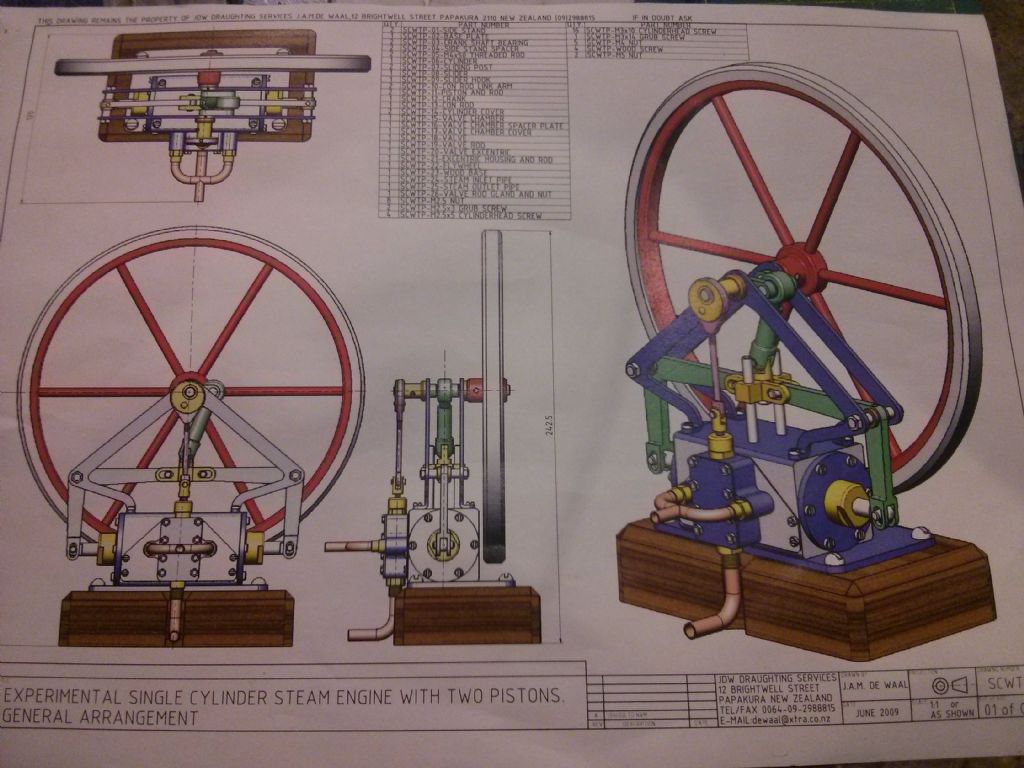

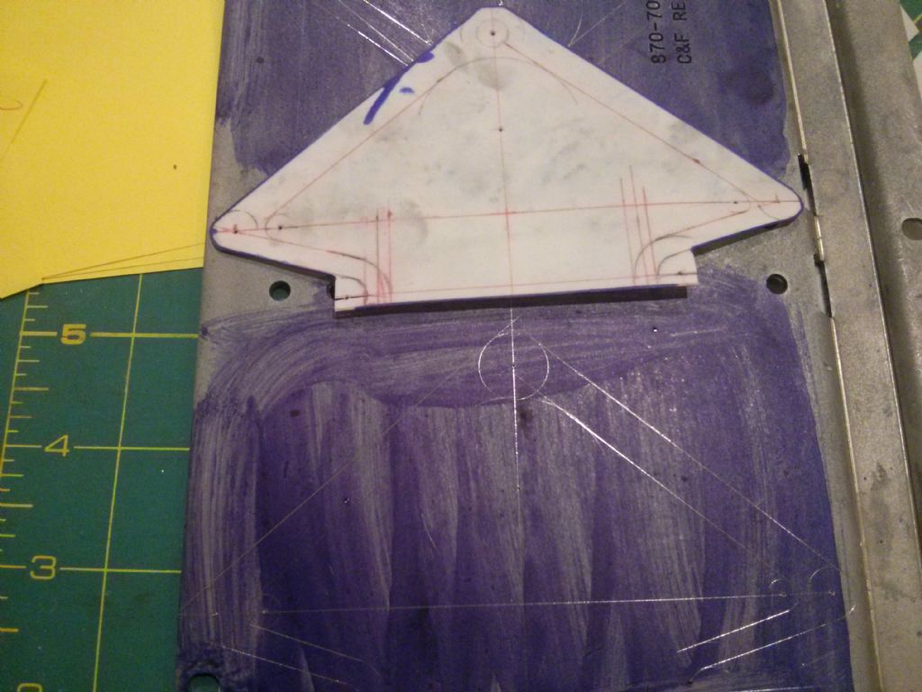

      Got started on my next project – Made a complete hash of the 1st attempt of a part (see thread in Beginner section "Reading a drawing – Radius" ) so tonight sat down and did some careful marking out on plastic first. Looking forward to the challenge
      Drawings sourced from here
      Marking out

      #3253
      Bruce Edney
        @bruceedney59949
        An Engine designed by J. de Waal – built by me

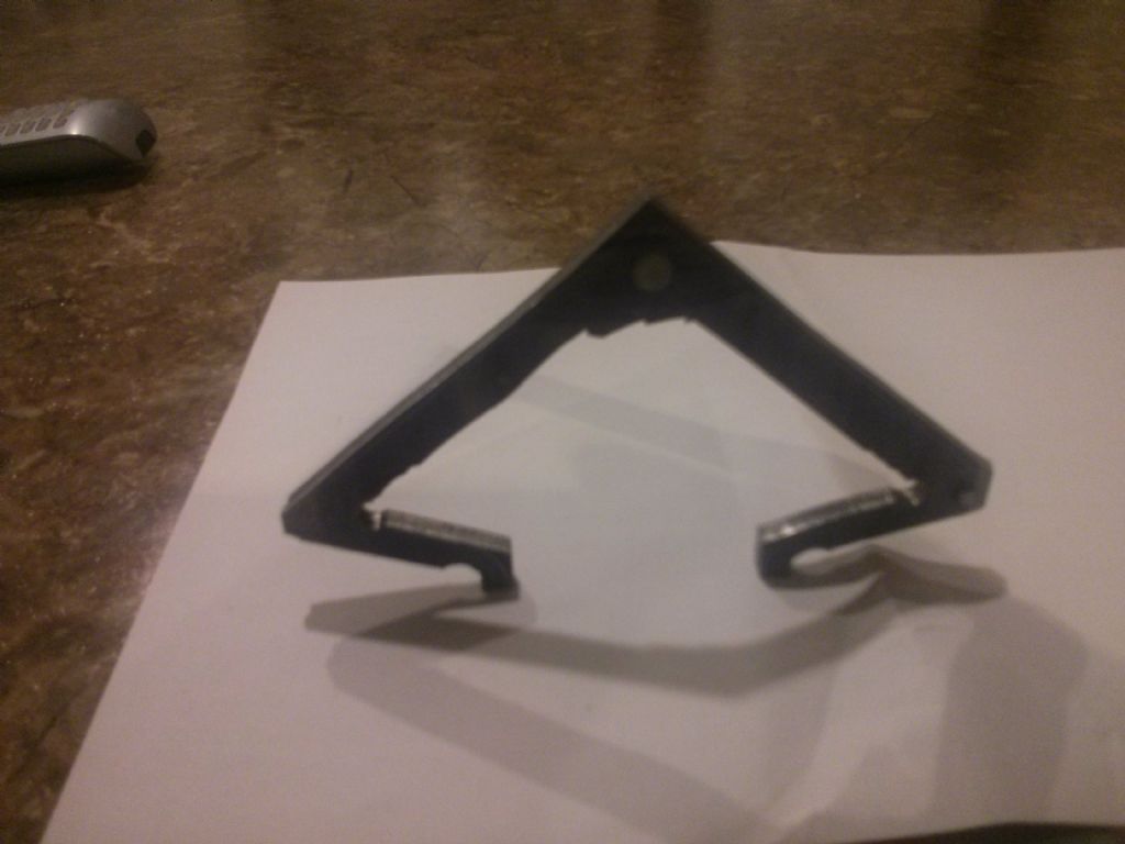

          #187571
          Bruce Edney
            @bruceedney59949

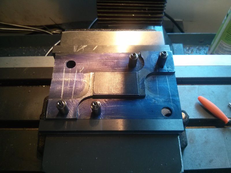

            Evening 2 – the cutting out begins – Thanks JasonB for the tip about pinning the 2 pieces together. Will do some filing tomorrow.
            #187578
            Mike Poole
              @mikepoole82104
              I think you may not have allowed for the material to make the bent feet that the frame is attached to the cylinder with, check the side view and top view for design and dimensions.
              Mike
              #187579
              Bruce Edney
                @bruceedney59949
                Thanks Mike
                I decided to go with Jason's suggestion of placing a piece of square bar between the sides.
                #187582
                Mike Poole
                  @mikepoole82104
                  Phew, thats a relief that you haven't cut off a bit you were going to need, putting on is allways harder than taking off I find. Glad it's all under control and all the best with the project.
                  Mike

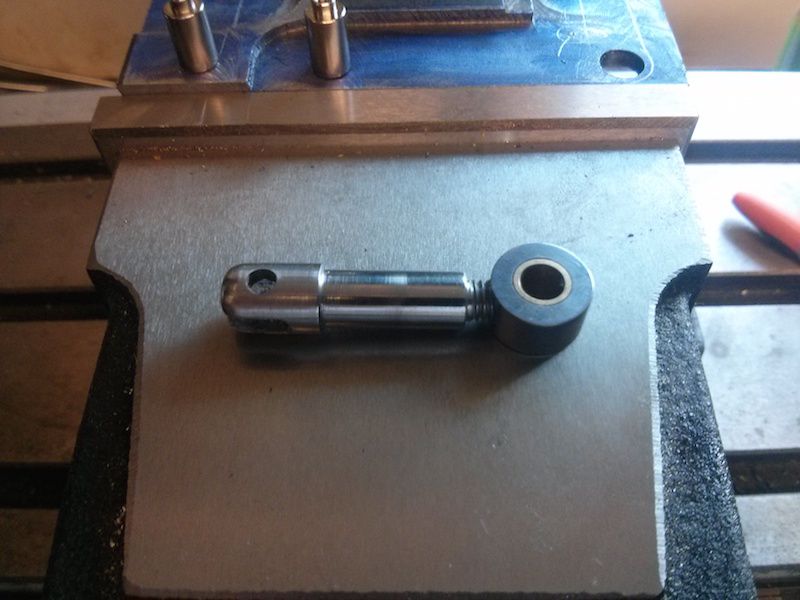

                  #187693
                  Bruce Edney
                    @bruceedney59949
                    Hi everyone
                    Here is my progress for today

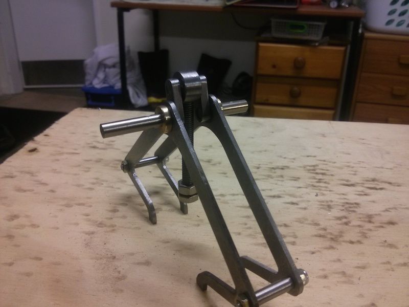

                    #187886
                    Bruce Edney
                      @bruceedney59949

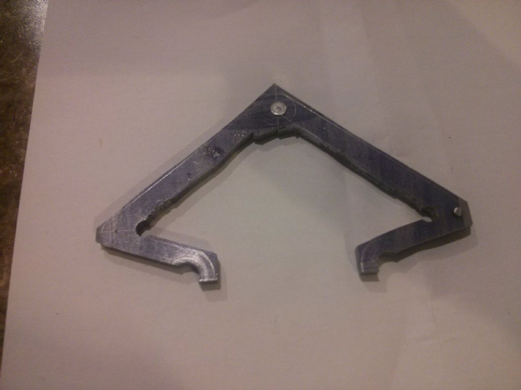

                      After a morning of cleaning the garage (aka workshop) up and adding some extra lights, I finally got onto cutting some metal.
                      Crankshaft webs finished off and then the crankshaft pieces and pin made. Finished off with the top of the con rod.
                      I am quite pleased with progress.
                      Thanks for looking.
                      Bruce

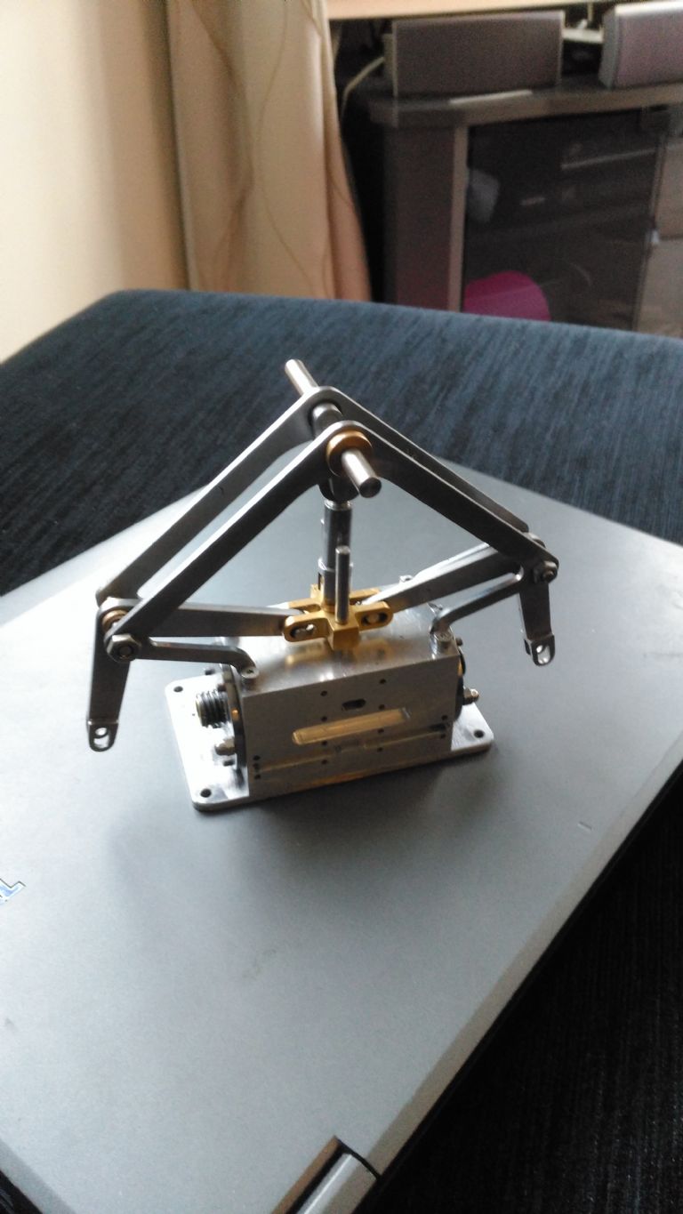

                      #189286
                      Bruce Edney
                        @bruceedney59949

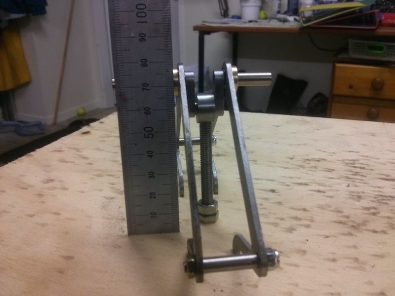

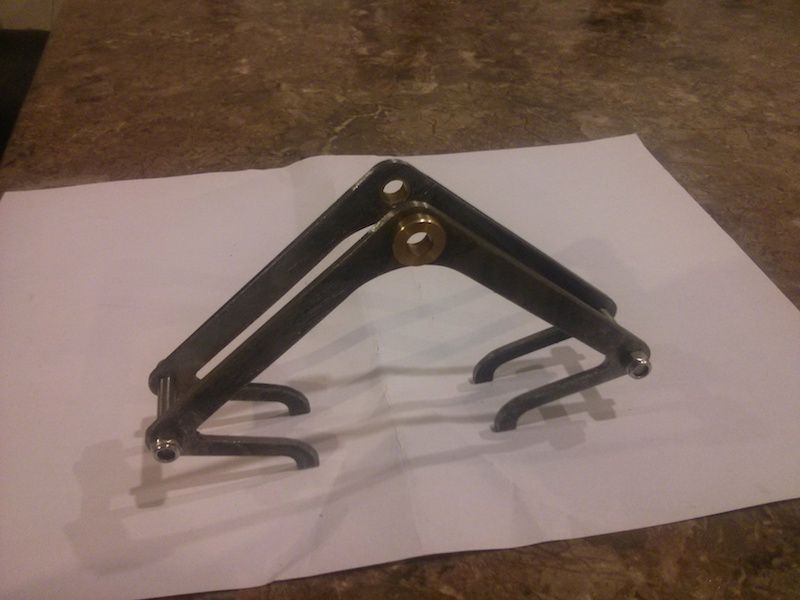

                        So I have been a bit slack in taking pictures and posting lately. This may, in part, be due to the arrival of this into my workshop family.img_20150510_082354 copy.jpg
                        #189287
                        Bruce Edney
                          @bruceedney59949
                          But here are some pictures of my progress in the last week or so.
                          1. The Con Rod
                          2. The very un-finished cylinder

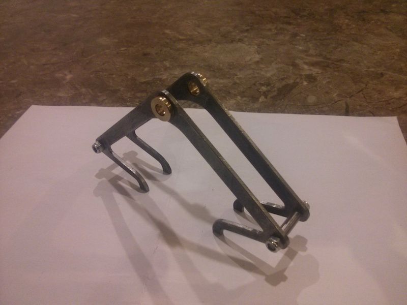

                          3. The Con Rod links – I had no 8mm plate in stock so I used a piece of 10mm and practiced cutting metal on the Mill. Now I need to actually cut out the links.
                          #216574
                          Bruce Edney
                            @bruceedney59949

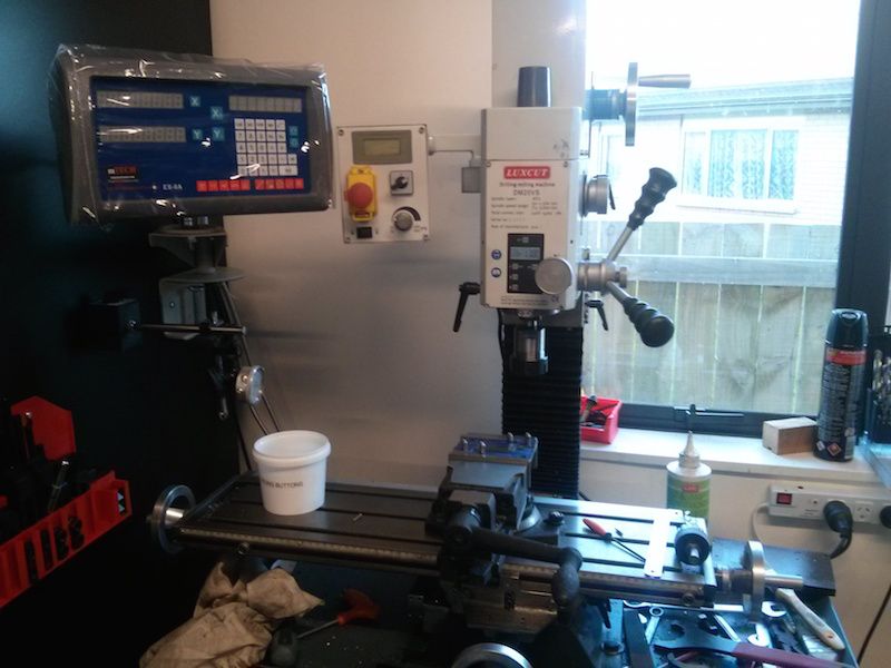

                            Well it has been a while
                            The mill has been in pieces and rebuilt as part of a CNC conversion and has taken a large chunk of my time.
                            Then using said mill to engrave christmas presents has taken more time.

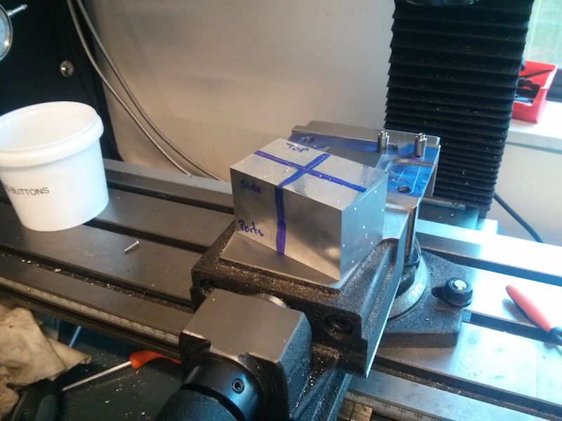

                            But some progress has been made
                            New side plates have been milled and formed. The cylinder block has been milled and drilled and now awaits the arrival of M2.5 taps and threaded rod.
                            Quite pleased with how it is looking
                            Bruce

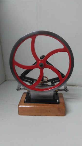

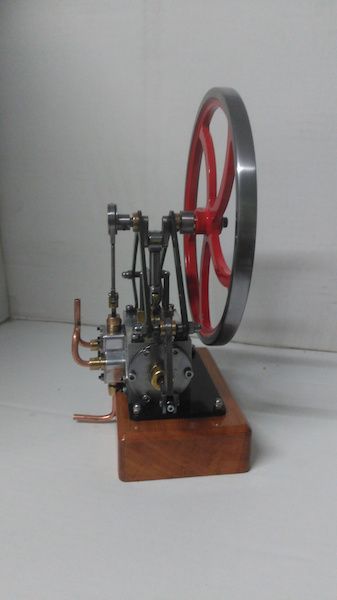

                                  #227522

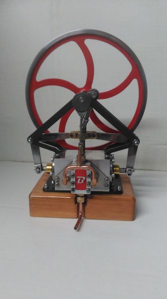

                                  Bruce Edney
                                    @bruceedney59949
                                    In the words of the Madden Brothers "We are done"
                                    Flywheel mounted via a split tapered mandrel type of arrangement which removed a good amount of wobble. A method I will definitely look at using again.
                                    All painted up and made reasonably shiny.
                                    At the beginning of the month it ran for 3 days for about 4hrs per day off a small fridge compressor with my other engine.
                                    I had the pleasure to show it off to the designer, Julius De Waal  and his wife,  last week whilst I was in Auckland on business. Julius is a lovely man and I look forward to building a few more of his designs.
