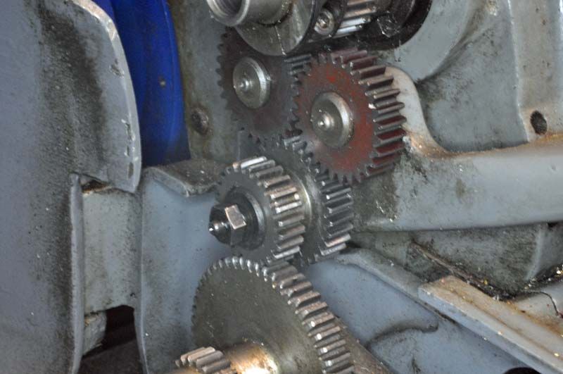

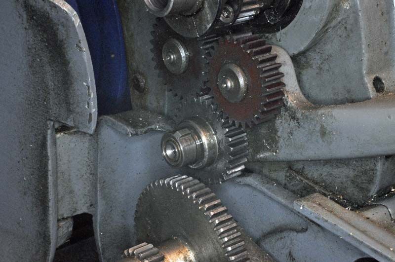

              Is this thread still active as it looks quite old. Reason is I have just purchased a Super 7B with qc gearbox on imperial. I would like to screw cut metric,just the basic sizes say 5mm to 8mm. I have downloaded the pdf sheets. But I am new to lathe type work so not sure which gears to look for & where they are on the machine. I know where all the gears are but just not knowing which ones it is that are changed.
              #444092
              Phil super7
                @philsuper7
                You just need 34 & 33 Teeth Gears , then follow the chart for gearbox settings.These Gears fit onto the Tumbler or (Chart says Mandrel) the same thing, Hope this helps

                    Thanks guys. Quick response. Just need to work out where the tumbler gear is within the set. Looking at the myford pictures I have it refers to the tumbler gear which is a pair side by side just below the main transfer gear from the headstock. Made of tufnol. Surely not them as they are a pair for forward or reverse & both the same teeth. The gear below them is a pair of gears. Any help or a diagram would be great. I know it's new years eve & all. Happy new year to all. Regards Steve.
                    #444103
                    peak4
                      @peak4
                      Below the tufnol pair, there is a cople of gears together on the dame spindle, held on by (I think) a screw.
                      The outer one of these is on a keyed stub. That's the driver gear.
                      Bill

                        Roderick Jenkins
                          @roderickjenkins93242
                          HTH,
                          Rod
                          Edited By Roderick Jenkins on 01/01/2020 09:18:35
                          #444147
                          peak4
                            @peak4
                            Cheers Rod, too late last night to go out and take a photo; Steven, just make sure you select the correct orientation for the larger drive gear, just out of shot in Rod's photo. That swaps between fine feed and screwcutting.

                              Thanks for all the input guys, i take it that you only change the one gear either 33 or 34 depending on the thread pitch & size. As in the picture you have put. Then adjust the gear train up to mesh correctly.
                              #444163
                              Brian Wood
                                @brianwood45127
                                Steven,
                                And finally, select the appropriate gearbox setting to give the metric pitch you want to screwcut
                                Regards Brian
